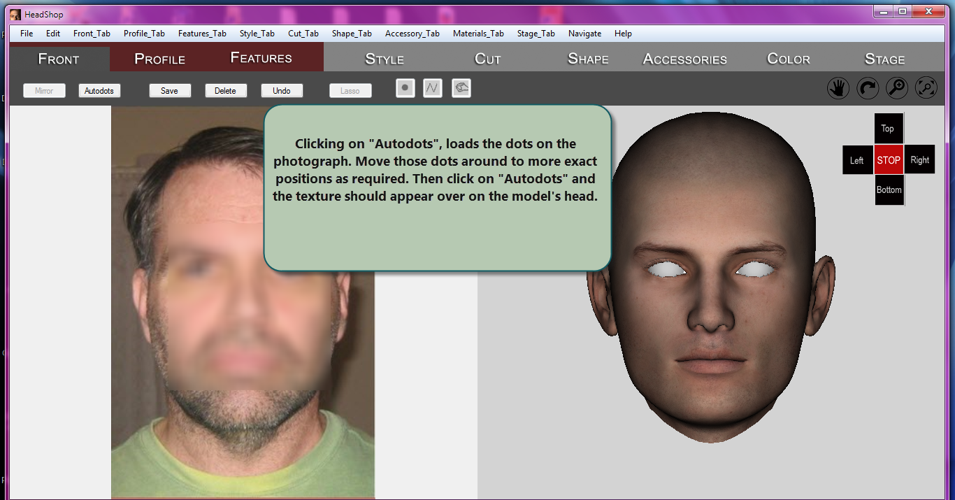

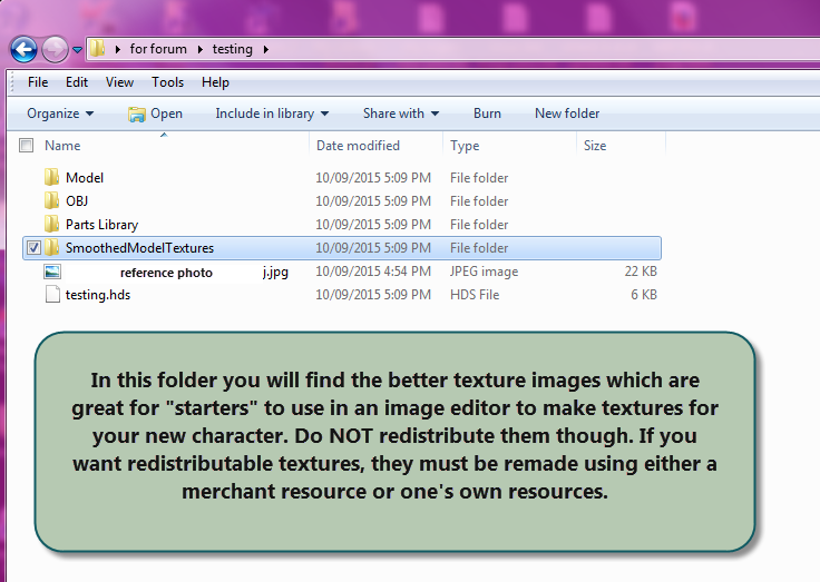

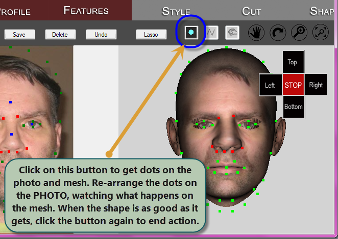

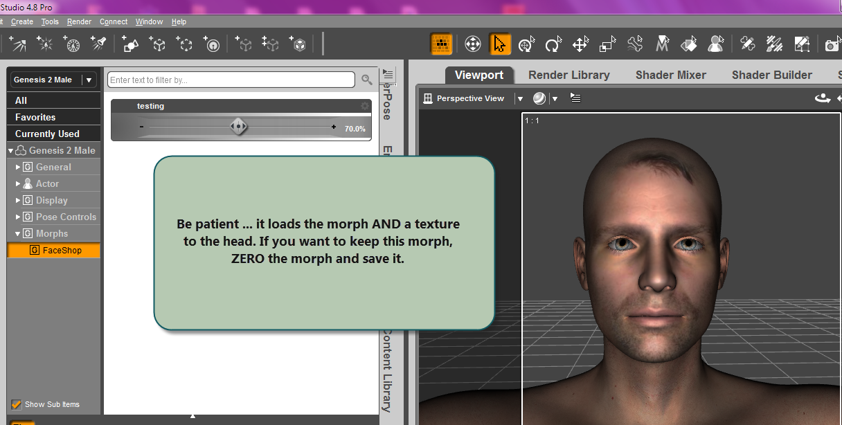

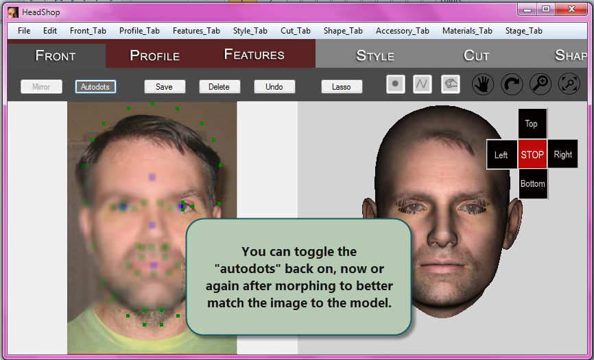

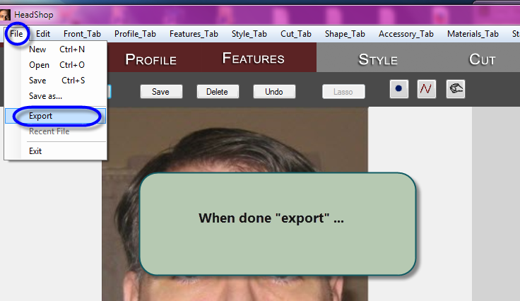

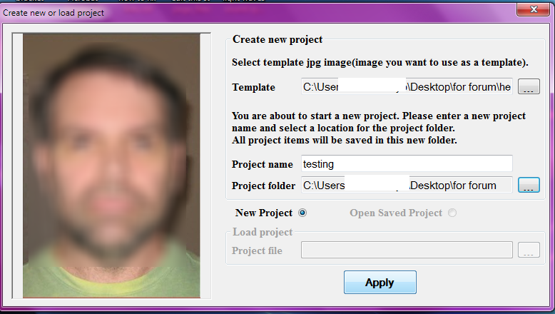

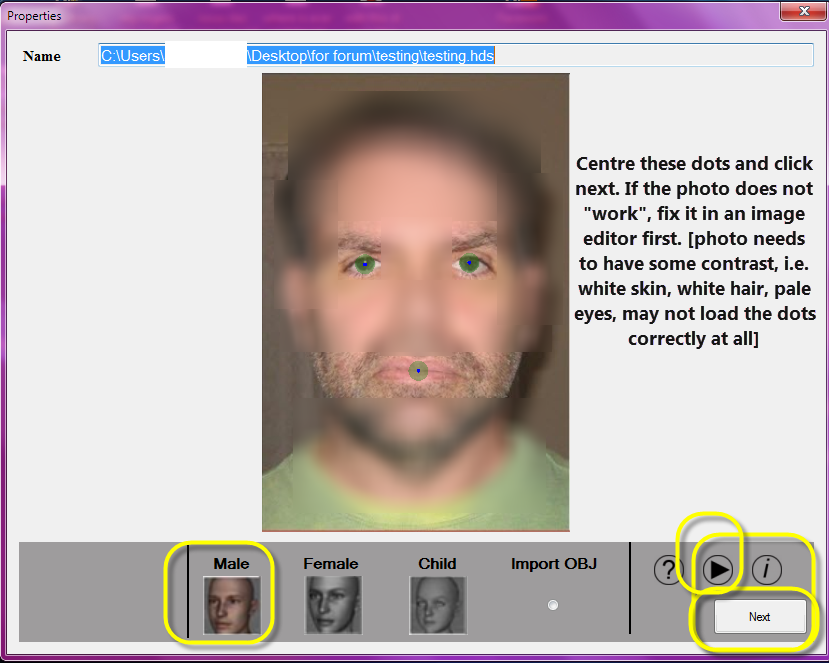

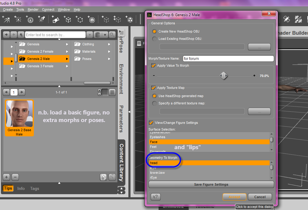

    Hi ... I'm back now ... sorry about answering "in a hurry", I had started the post when somebody came to the door. - and notifications I don't get 'cause ...
    No, it doesn't matter how one does what, the figure should not have gone "poof" in D/S.
    I have to set up D/S and run the plugin to get the screenshots to explain the dots. My plugin doesn't exactly work the way I thought it would either but anyhow,
    I'll see what I can put together for you when some photos finish uploading.
    Yes, the "root" of the figure "must be" chosen for making "any" morphs on these types of figures.
    First things first though. Because "anything" can happen to a scene and so let's do something about those glasses. If I'm reading that picture correctly, that's a triax pair of glasses [right?] and you say you have them "morphed". So over on the Parameters Tab, with the specs selected, do you have some morph dials showing for these morphs you created? If so, "0" them, "File > Save As > support assets > morphs > the options presented are for your own folder names, the path is preselected for the product as it should be, select ONLY the new morphs you made and "save" them. I never suggest encrypting [compressing] files.
    If they were not all your morphs or whatever, and if you have Hexagon, you can "unparent them", select them, shoot them over the bridge to Hexagon, then in D/S "zero" them, then back from Hexagon, shoot them over the bridge to D/S and make the morph [which would be yours ONLY] and save it.
    Also one can empty a scene of all but whichever "essentials" are wanted and "save a subscene" ... later merging subscenes together back into a main scene.
    Post edited by patience55 on
    edited September 2015
    Okay ... hopefully this works ...

  • fixmypcmikefixmypcmike Posts: 19,735
    Zeroing the morph doesn't remove the morph channel, it just sets the default value of the morph to zero.  If you don't do this, then the morph will be active whenever you load a new figure.

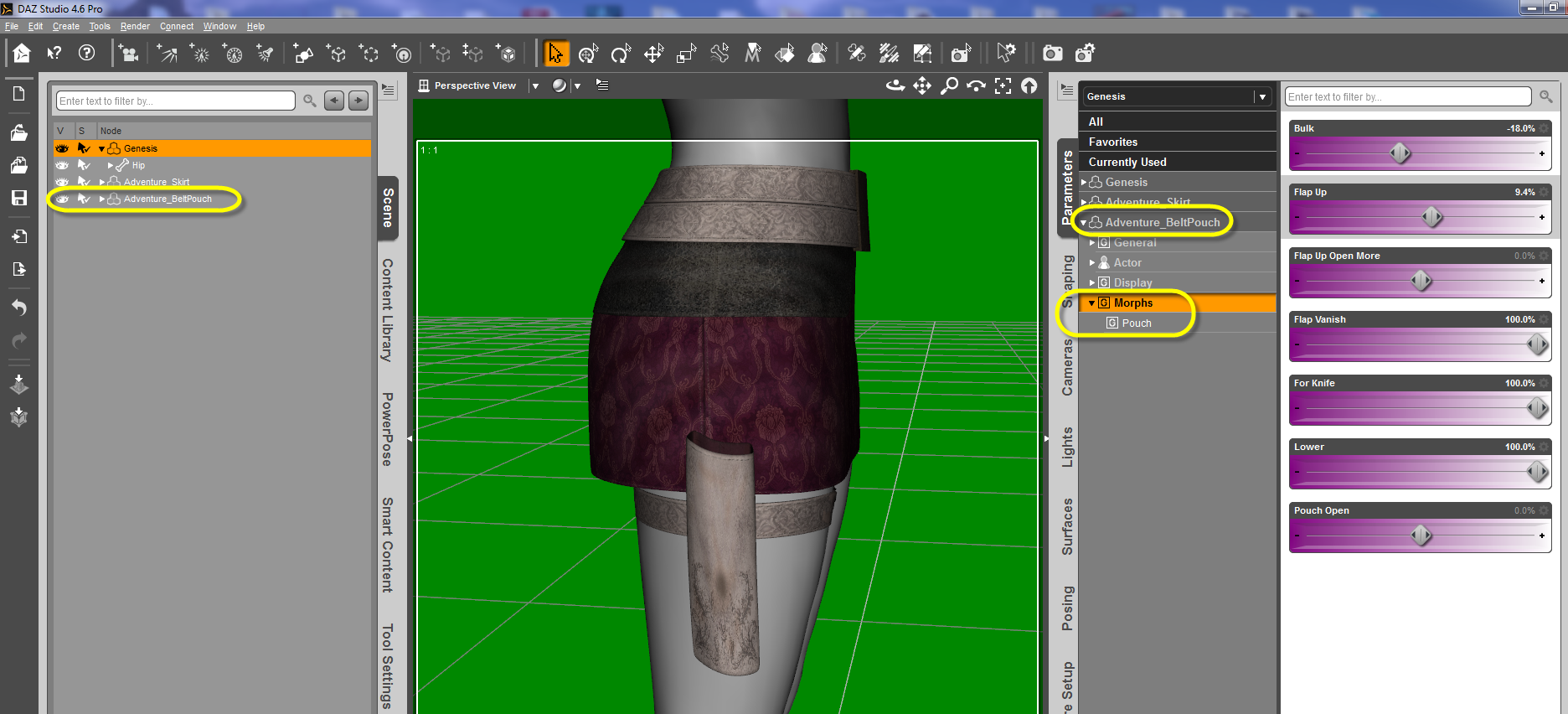

    Making morphs for clothing items; here is a picture of one set I did. As you can see, one can dial in various percentages to achieve the desired look. For now though, if you have it saved to whatever Hexagon is choosing [probably Morphs/Morph Loader], that is fine.
    All these morphs were "zeroed" to "save them". Everytime I load this clothing item, all the morphs are there too but not dialed in.
    It is also possible to save "pose presets" so one could quickly achieve a desired look for a clothing piece [or figure] not dependent upon loading an entire character.
