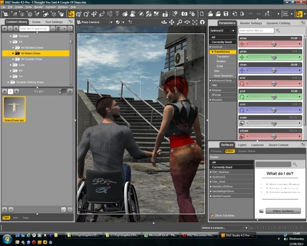

    Here's a different approach to Adam's, I use a single monitor and this is pretty much a twin of the layout I had back in Studio 3. Just keep customising it until you get a layout you're happy with.
    800 x 640 - 129K
