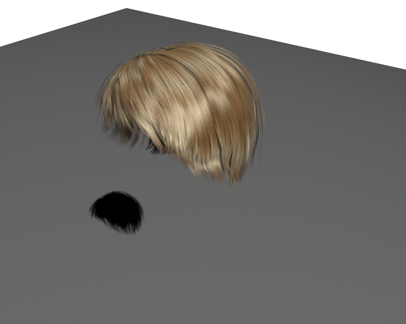

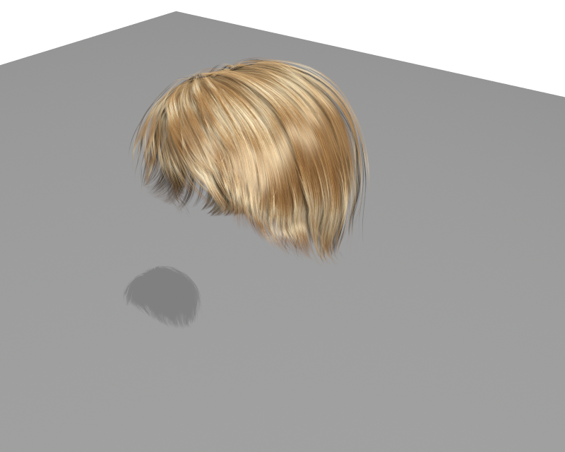

    edited September 2015
    Simple scene does not necessarily mean few items.
    Just enabling shadows can start to close the gap, especially with transmapped items, like hair.  Any effects that rely on raytracing will narrow the gap or push the speed advantage firmly to progressive ON.
    A 'simple' scene with a shading rate of 0.2 (yes, shading rate IS used by the progressive render) and just raytraced shadows, single spot light...
    Progressive ON: 2 min 01 seconds
    Progressive OFF: 6 mins 26 seconds.
    There is very little difference between the two images, mainly due to the differences in pixel filters used (box vs sinc), and they show around the very edges of the shadow and ends of the hair.

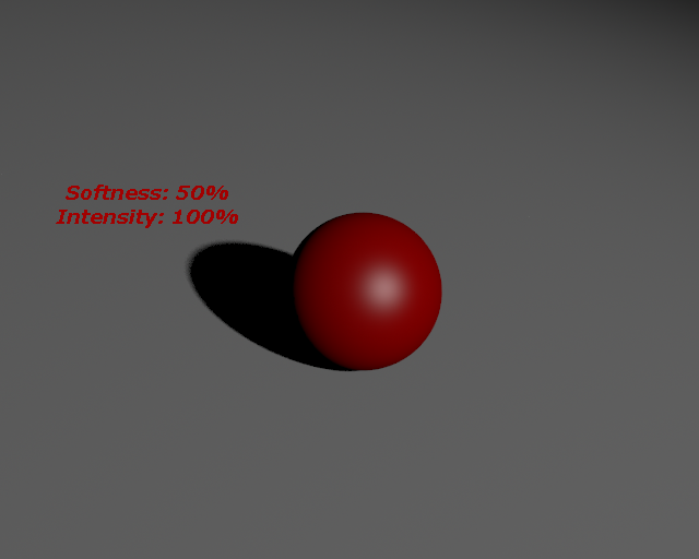

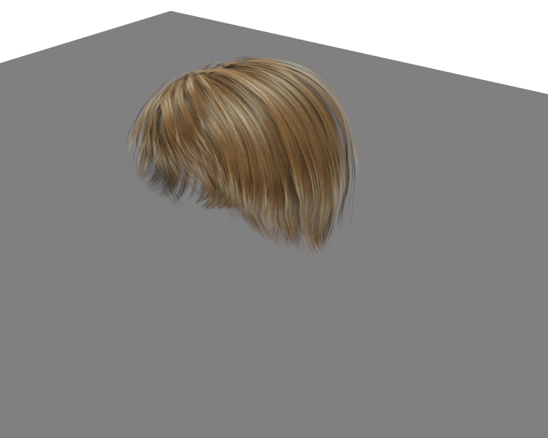

    And the gap is even more significant with transmap + occlusion.
    This pair is just an occlusion light (like UE2 set to Ambient Occlusion/soft shadows, with a uniform map in place...softbox type light)
    Progressive OFF: 22 mins 10 seconds
    Progressive ON: 5 mins 16 seconds. (about 1/4 the time as opposed to 1/3 for the last pair)
    800 x 640 - 195K
    800 x 640 - 222K
    Post edited by mjc1016 on

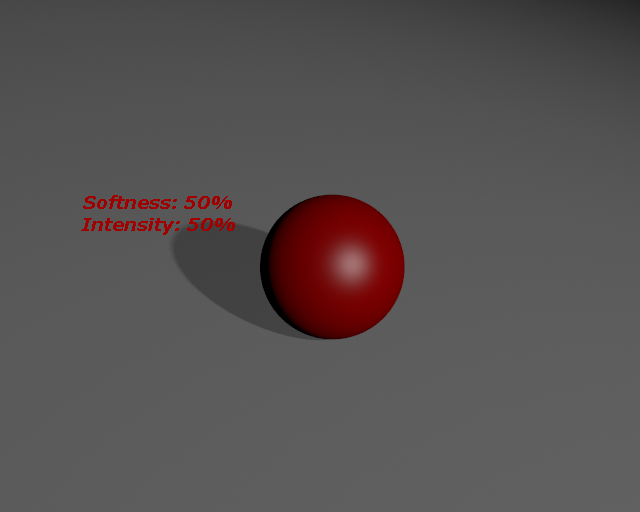

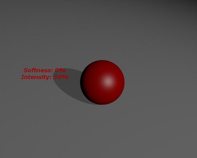

    And this is the third set...
    Progressive ON: 5 mins 57 seconds
    Progressive OFF: 23 mins 24 seconds.
    Notice while both increased over the occlusion only render, the Progressive OFF render had more of an increase (over 1 minute) while the ON only went up about 40 seconds.
    Combining things like SSS or translucency will have similar impacts.
    800 x 640 - 462K
    800 x 640 - 447K

    Scavenger said:
    Occlusion + directional shadows? or Soft Shadows?
    Directional...should have made that clearer.  The first one is softshadow (2nd set) the other is directional (3rd set).
