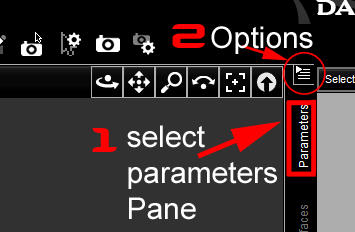

    You can Apply Smoothing and Collision manually
    Select your item and whilst in the Scene Pane go to Options (1) AS SHOWN BELOW. Then 2 Edit and 3 Apply Smothing Modifier.
