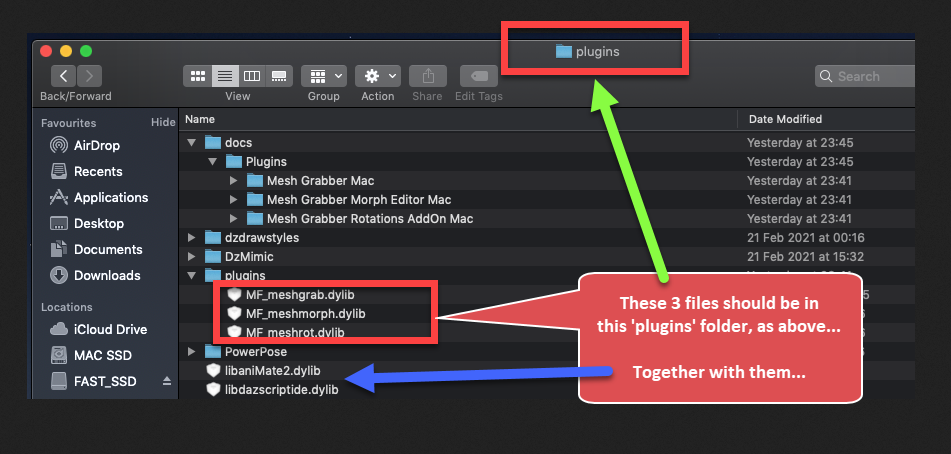

    It seems not correct from the screenshot you attached ~ Your directory looks strange... surprise Pls check the pic as below:
  • Hi crosswind, I carried out instructions but still no luck. However, it prompted me to investigate further and I discovered that I was installing the Plug ins to an older version of DS! I always keep older versions when I update DS as a not-really-sure-why but following advice.
    So, in future I must make sure I am selecting the current version of my DS!
    Now all I need to do is learn how to use it!
    Again, thank you for everyone's help and patience
