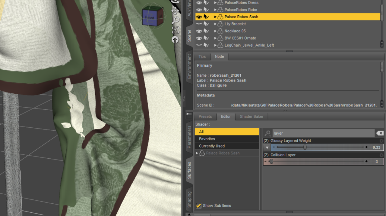

I found Mesh Graber is quite hard to use in this case (after the simulation), oftentimes I find myself grabing the wrong layer of clothes (very hard to control with mouse!) and overgrabbed them a lot!

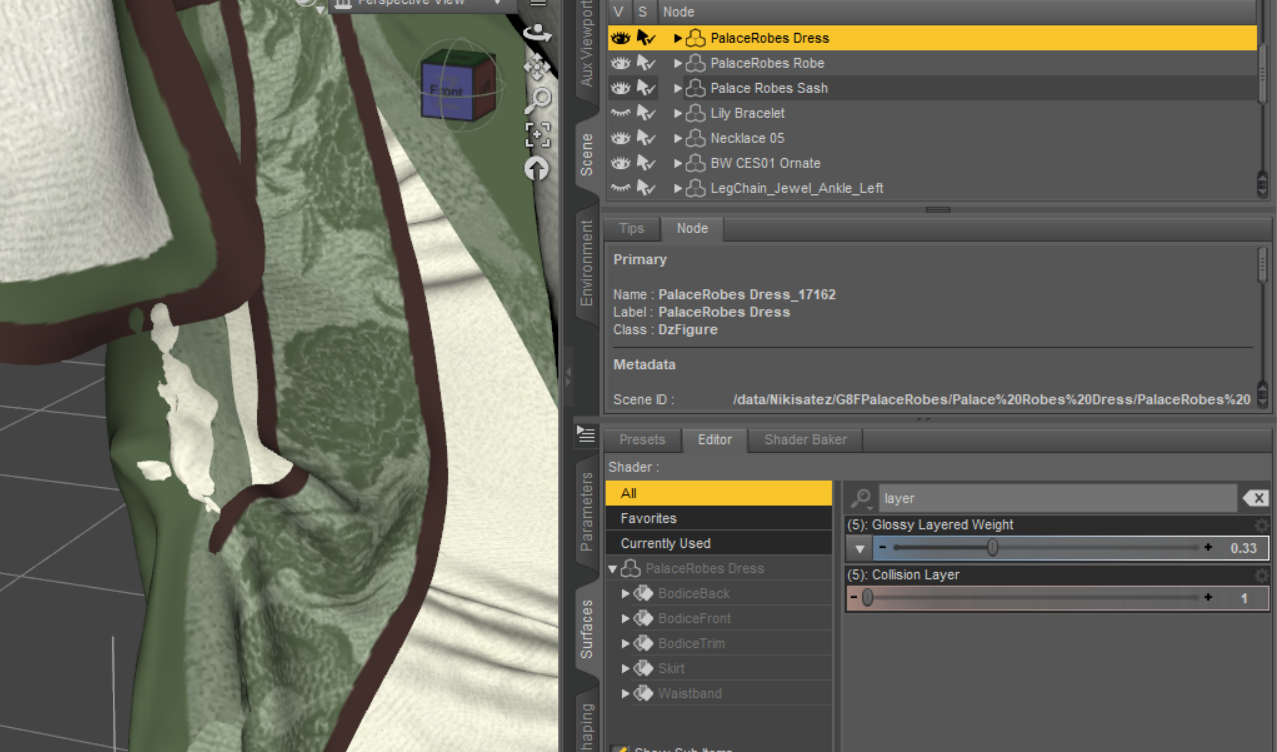

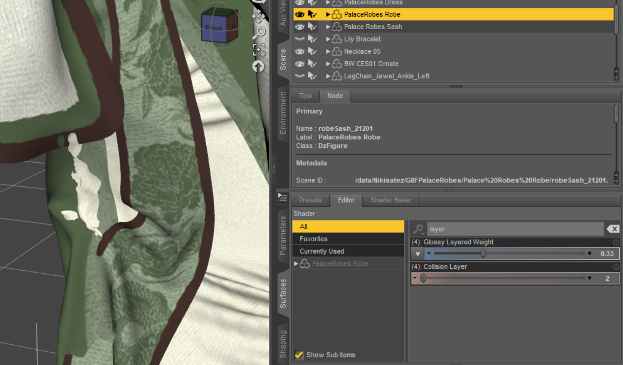

  • Have you checked that each part has a different layer setting, in the Surfaces pane?
    Let me show you screenshots: Yes they have different layers setting but still you can see from the left the poking-though simulations. But I guess there are rooms for adjustment. Is there anything I can do with layers and glossy layed weight?

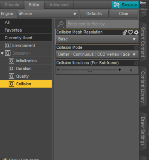

  • One trick to consider: go to parameters -> mesh smoothing -> collision item and collision iteration...
  • Have you upped the settings for Colision quality in Simulation Settings, and the iterations as felis suggested?
  • tayloranderson2047tayloranderson2047 Posts: 116
    edited February 2023
    You mean this? I tried to lift the quality here but unfortunately doesn't solve the problem completely... iterations doesn't seem help much. I have to save the pose of my character is a big complicated--- the thigh is raised very high
    Post edited by tayloranderson2047 on
  • You may need to give it more time then, the faster the movement the ahrder it is for the simualtion to diffuse the energy the worse the simulation (if it doesn't explode).
