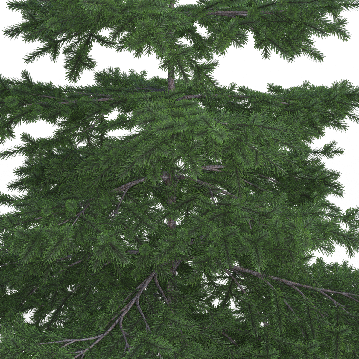

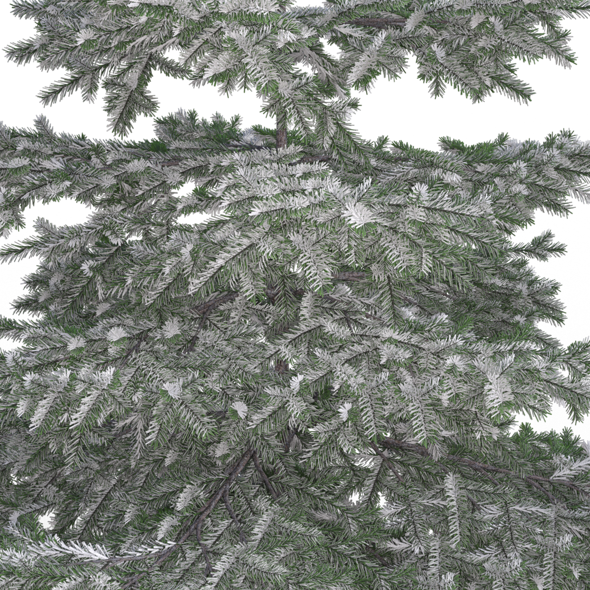

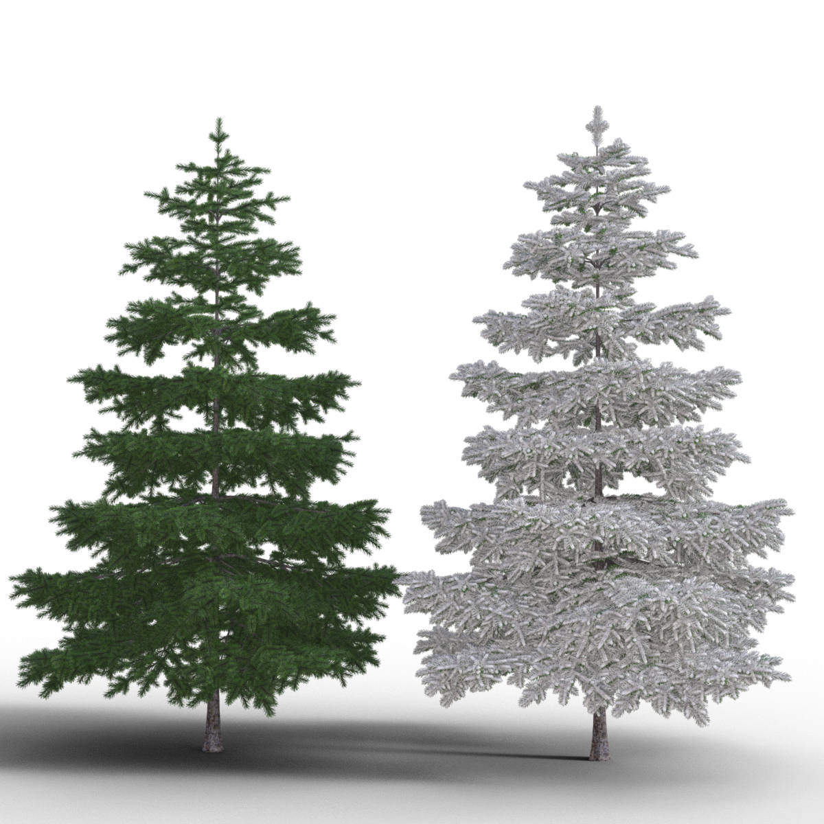

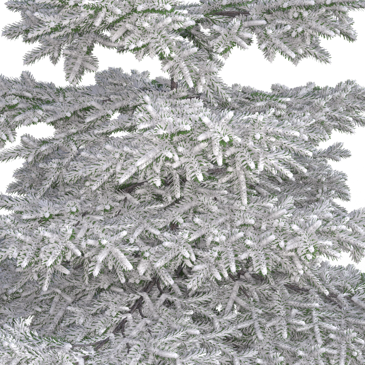

    Here are the examples using the Spruce from the UltraTrees - Realistic Tree System:
    First Image - Spruce "out of the box" no additional changes
    Second - Spruce with "Snow 03 Opaque" applied
    Third - Spruce  with "Snow 03 Opaque" applied and Offset Distance changed to "1"
    Fourth - Side by side comparison of Spruce without and Spruce with Snow

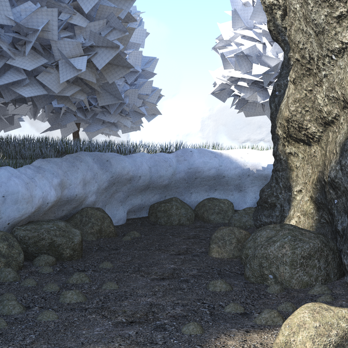

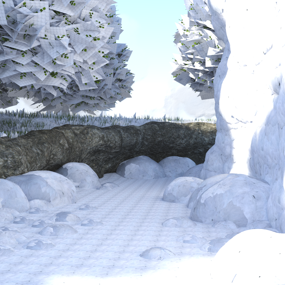

    However, I've also attached another example set using "The Rocky Place" product out of box.
    First Image: Out of box using render settings from the same product.
    Second Image: Same as first image, but with a geoshell added to The Rocky Place, "Iray Uber" shader applied to the geoshell, and then my "Snow Shader 19 Opaque" shader applied to the geoshell. (I did remove the geoshell effect from the "cloud" surface).
    To change the height of the snow, probably the easiest way is to change the "offset distance" of the geoshell, which can be found in the parameters tab. (This also helps whenever it doesn't immedietly cover the ground because of displacement maps on the ground).
    Third Image: Same as second image, but with the geoshell's offset distance set to "20." (Note, though, that in this case, changing the offset distance to be so high removed it from the tree leaves).
    Fourth Image: Since the repeating pattern was noticable, I used the Tiling 1x1 utility preset to make it look more natural.

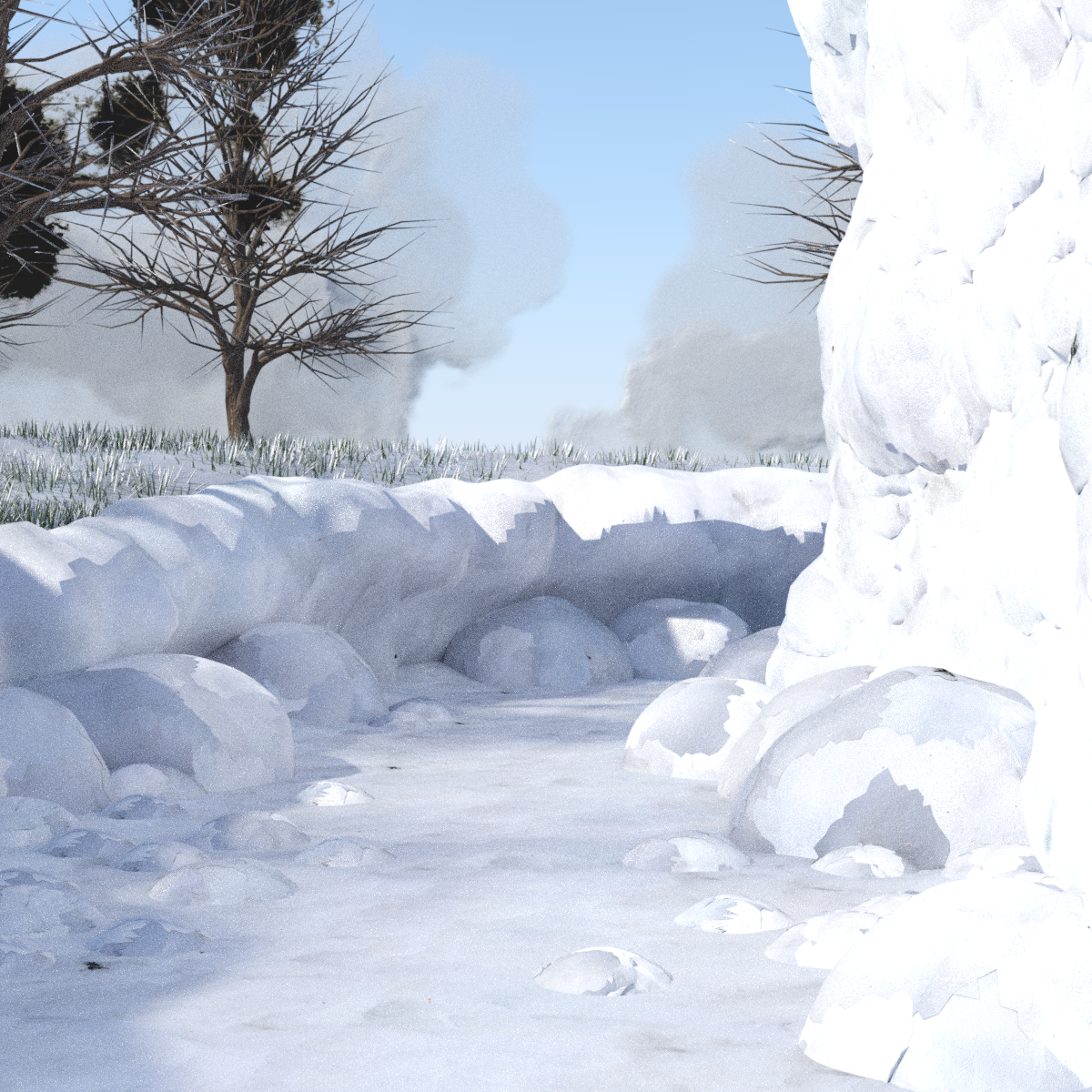

    Fifth Image: I did tweaks to the scene for additional polish: Removed the geoshell effect from the grass, tree, and leaves, changed  Environment Intensity (render settings) to .5 so that the snow showed better in the light, created a second geoshell with the same shader that's offset at "0.10" and turned off "cloud" and "tree leaf" surfaces. I also went into the The Rocky Place prop and turned cutout opacity to 0 for "tree leaf" to make the trees bare. Now, I am getting some wonkiness in the trees with both geoshells turned on (Even though only one has the cutout opacity running), so I'd probably replace the trees if I was making a finished image.

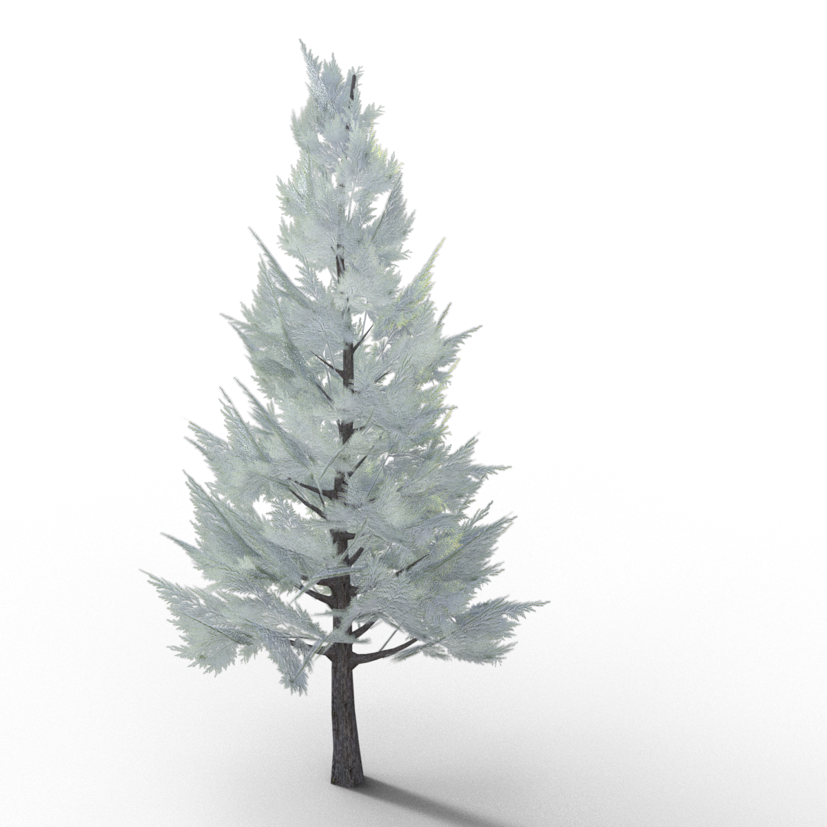

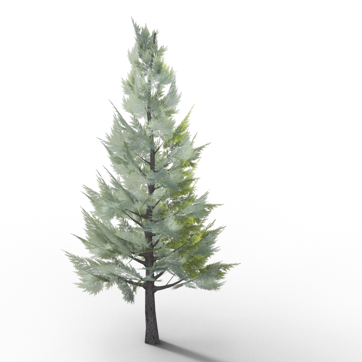

    Here I used the Spruce tree from the Deepsea’s Eagle Environment set, with my Snow Shader 19 Opaque shader. I created a geoshell on the tree, applied my snow shader to the geoshell, lowered the cutout opacity on the bark to 0, and then checked to see what the Cutout Opacity image was on the original leaf, and put that into the Cutout Opacity Image section on the geoshell. I also had to change the tiling back to 1x1.  Here’s the before and after result:
    You might still get a bit of a frosted look by doing the above technique, but lowering the opacity. Here I have it at .30.
    It’s limited, but there are some options, at least. I think this technique would likely work best for background trees, though, rather than closeups.

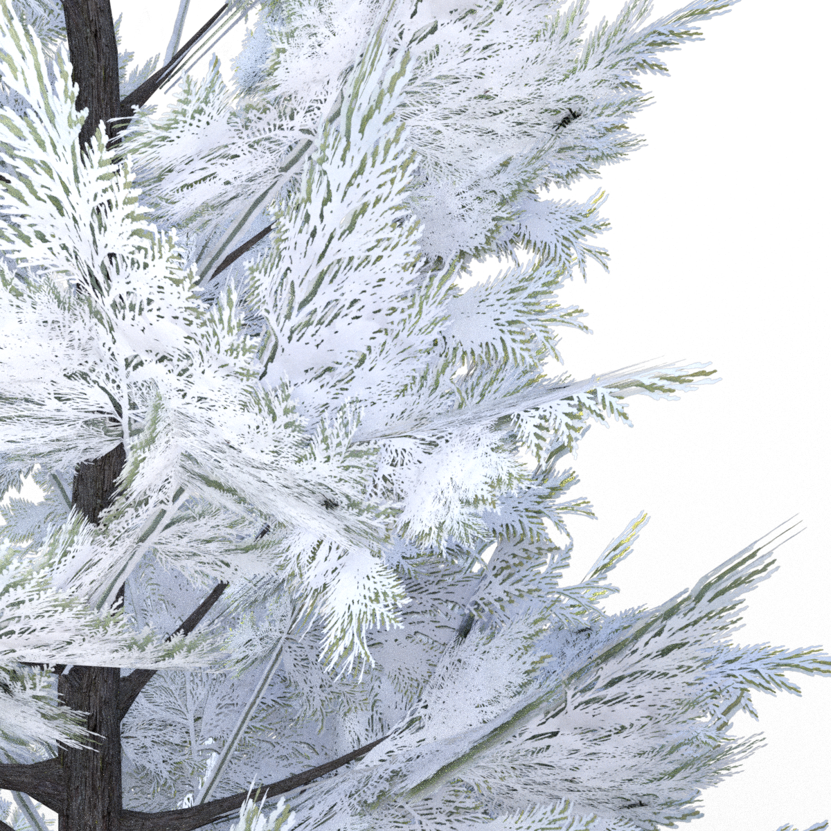

    Closeup example (Note it does have the issue of having the texture on both the top and bottom of leaf, making it look double-layed).
    Unfortunately, since it’s a single plane, it doesn’t seem to get the varied depth the way other props would:
