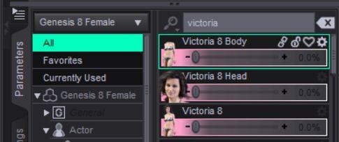

  • belardbelard Posts: 56
    I have been fiddling with Character Splitter v3 for a few days and must be doing some very stupid mistake because I cannot find the morphs I saved. I followed the workflow from the User Manual (which I have read several times) and after saving the morphs I can't see them anywhere...
    Any idea on what I am missing? I have a few years experience with DAZ Studio but this is my first time trying to mess with morphs. Every suggestion will be greatly appreciated.
  • Mike3DMike3D Posts: 95
    edited June 2025
    If everything went fine, the quickest way to find your morphs is by doing a search in the "Parameters" tab, as shown below :
    Select "All" and type the morph name ("victoria" here), and all the morphs will appear.
    Alternatively you can search them manually from the "Parameters" tab by following the "Path" that you've set in Character Splitter :
    485 x 204 - 18K
    310 x 190 - 10K
    Post edited by Mike3D on
    Mike3D, thank you very, very, very much! I was looking for the morphs under Shaping (which somehow made sense to me) and could not find them. Under Parameters they are all there!
    A really stupid mistake from my part...
    Thanks again for your help and your great script. Solved me a problem I had for almost a year!
