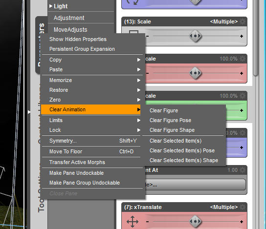

    Thanks for helping. I haven't gotten this to work yet. When I select everything in the Scene tab and right click on the Parameters tab, my menu looks like the attached image. I don't see "clear animation data". I tried a couple of the available selections, but they moved everything around in my scene and made a mess of it. What am I missing?
    EDIT: added image showing clear animation fly out submenu.

  • Richard HaseltineRichard Haseltine Posts: 111,805
    Clear Selected items should work - it should then keep the current frame's settings.

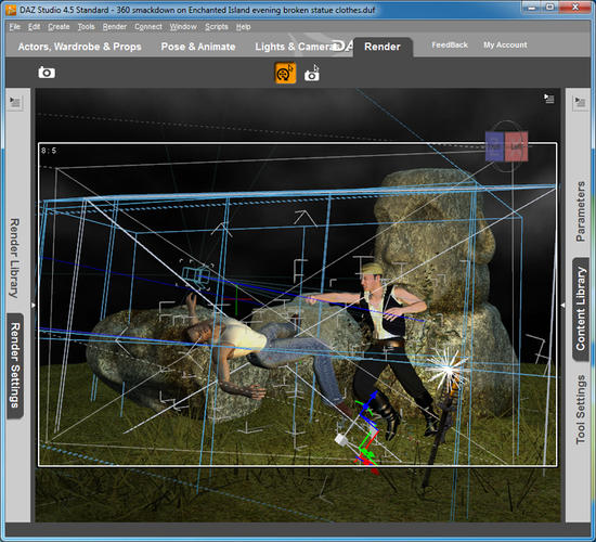

    Clear Selected Items seems to change the origin of all my actors and props to 0. In the attached "after" picture, you can see that the default camera has moved to the origin, I believe. If I zoom out with the camera, I can see that all my actors and props are on top of each other in the center.
    800 x 727 - 320K
    800 x 727 - 550K
    Hmm, I don't think it should be doing that - but it certainly is. OK, there are two other options - which is easier will depend on how many frmaes are set and how many items need animation clearing.
