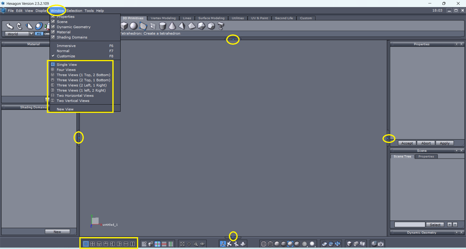

    C:\Users\...\AppData\Roaming\DAZ 3D\Hexagon 2
    If you can try switching to another layout maybe it would bounce back? {I have not experienced this with Hexagon. It's not a field we can open/close.}
    There are some very tiny "arrows" which hide/show the various side/top/bottom panels.
