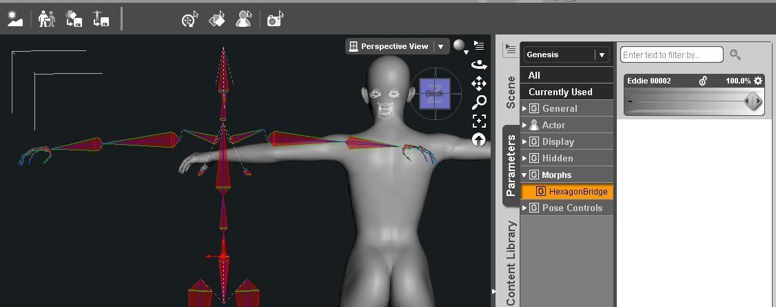

    oh I did do a print screen of the bone outta body,  my bad I forgot I did add some clothes just for  the image to show, but I can't remember if  this was before or after using the joint editor, but still the poses were still like this, by the looks it was before I did, or you would also see the second set of bones
    758 x 736 - 64K

  • larsmidnattlarsmidnatt Posts: 4,511
    edited August 2015
    from your last screenshot I can see the bones are not matched up to the figure at all. after you imported the morph, did you use the joint editor to adjusting rigging to shape?
    Also the figure seems offset from the bones..not sure what is up with that.
    But the steps are like this
    1. Send Figure to hex
    2. morph
    3. send to daz
    4. Morph Dialog "Reverse deformations" should be checked
    5. Use joint editor to adjust reigging to shape (not always needed, but seems like it in your case)
    6. Use Properties hierarchy to ERC freeze the new shape (only really needed if you needed step 5)
    7. at this point you can save as a morph asset so you don' thave to follow these steps again in the future
    BTW, I would look at the parameters tab and not shaping. Secondly make sure you arent' sending the figure back as a prop. Make sure you aren't changing the figure name in Hexagon. If so make sure it matches the name of the figure in DS. Optionally, you could save the shape as an OBJ, and import it with Morph loader pro.
