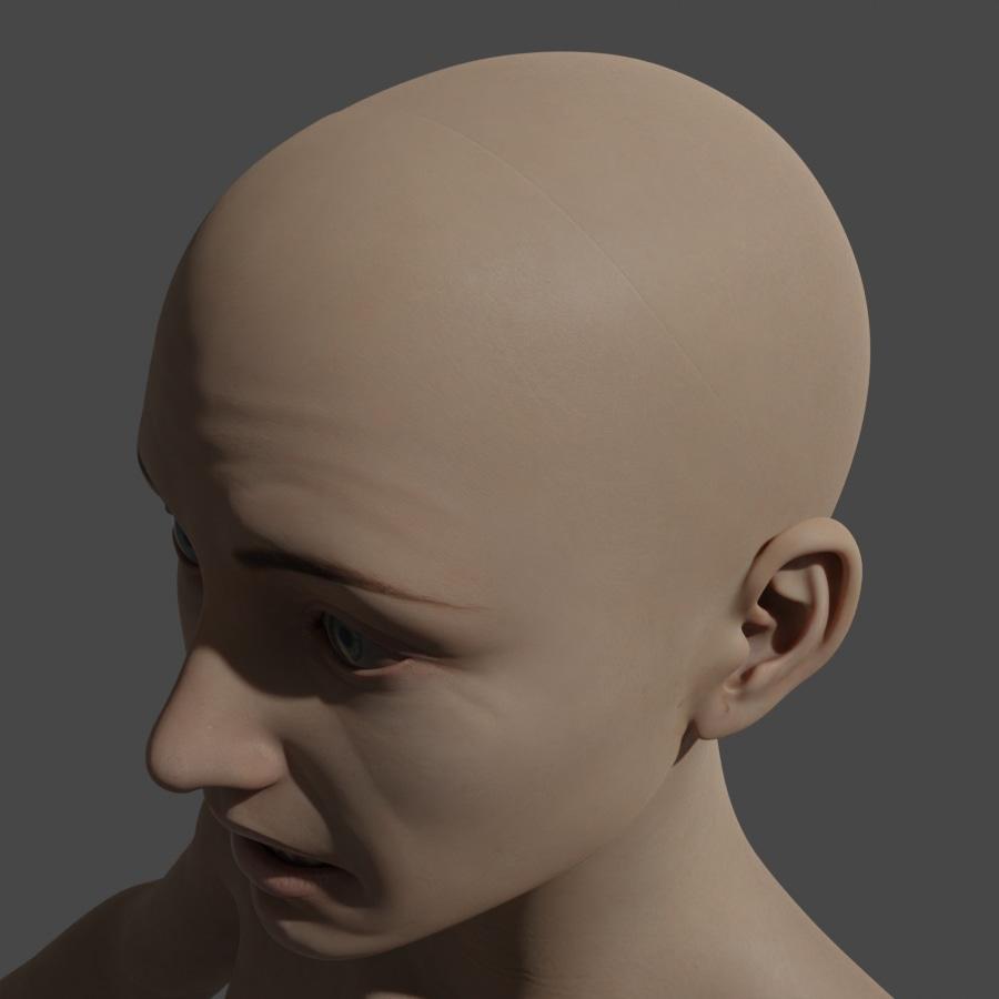

But what ever I do, the height map also bloats the mesh additionally. Here in DAZ Studio:
It's clearly visible that the displacement causes seams. The Displacement is only applied to the face. The seams are the result of the displacement maps adding height, in places it shouldn't.
Here the same map used in Blender:

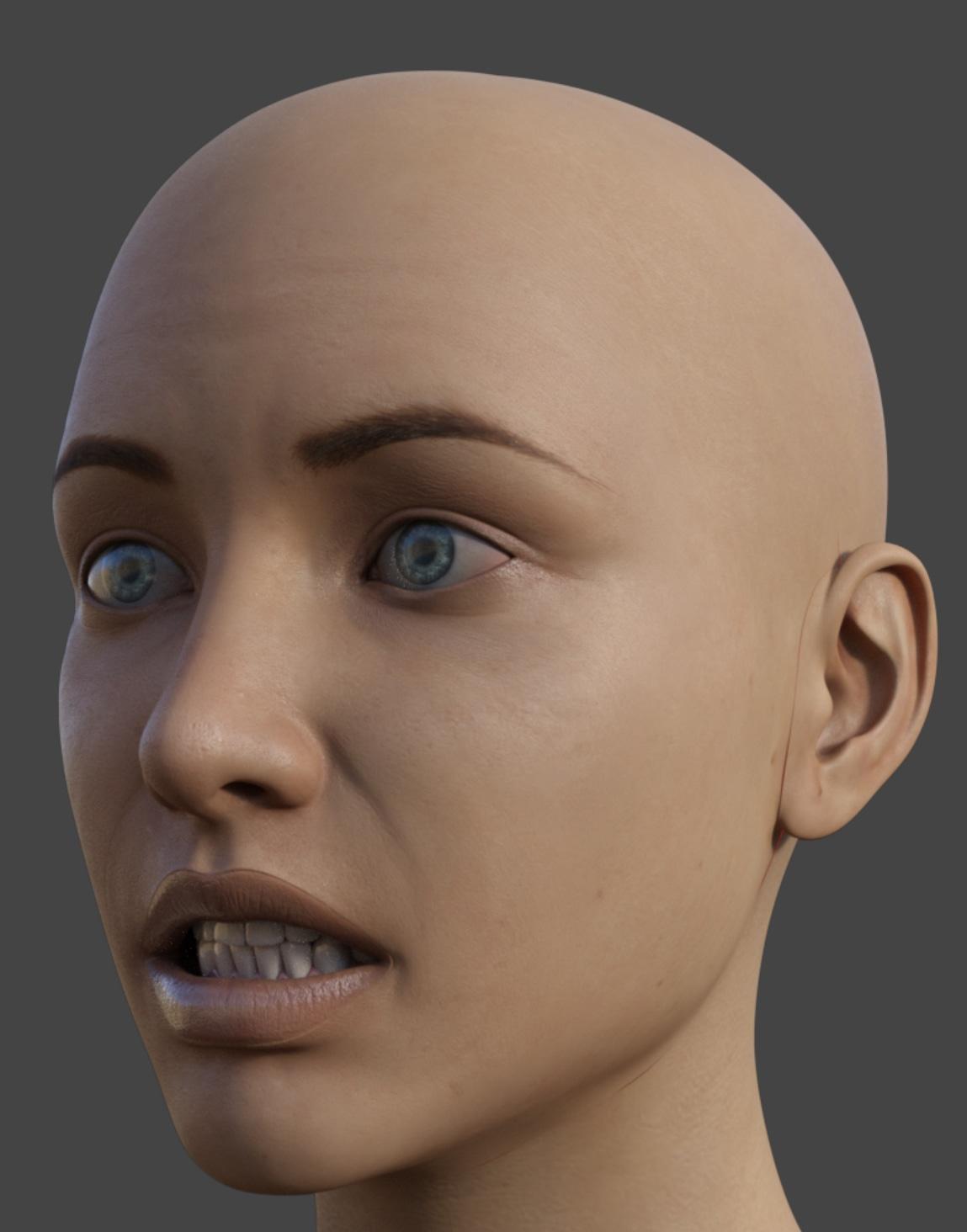

And just for comparison without any displacement:

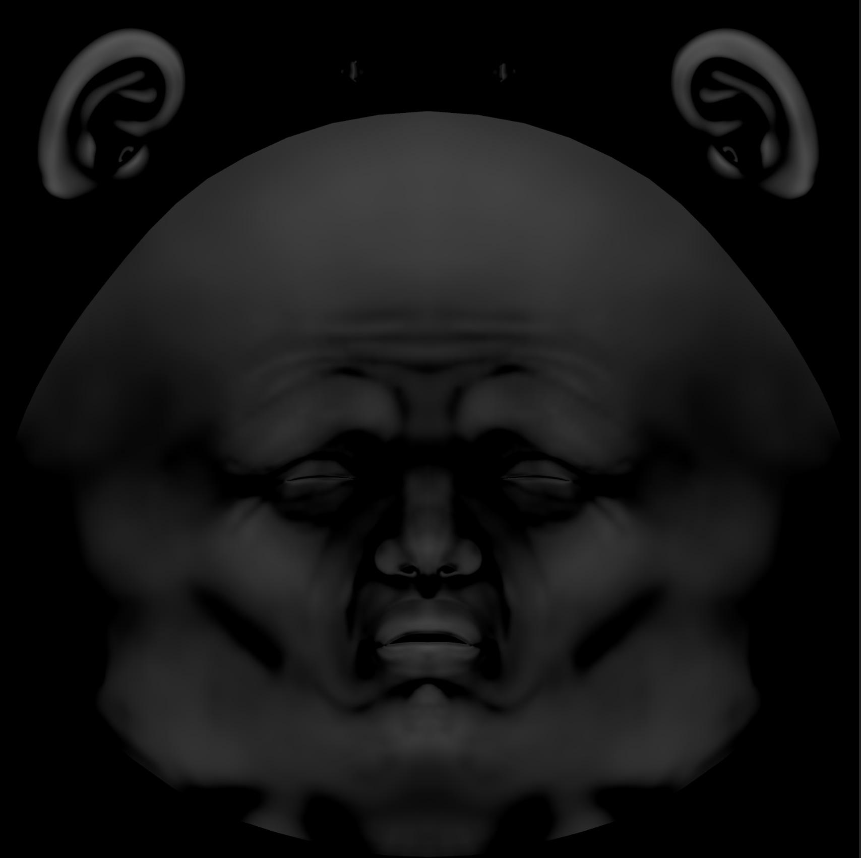

If I look on the map, it's clear why this happening. Even if there is no HD information, the mesh is overall grey instead of black on non affacted parts.
This is clearly obvious in the ears. They should be completely black, but they are gray. Even if I bake a mesh without any HD information I get a grey map which bloats than the mesh.

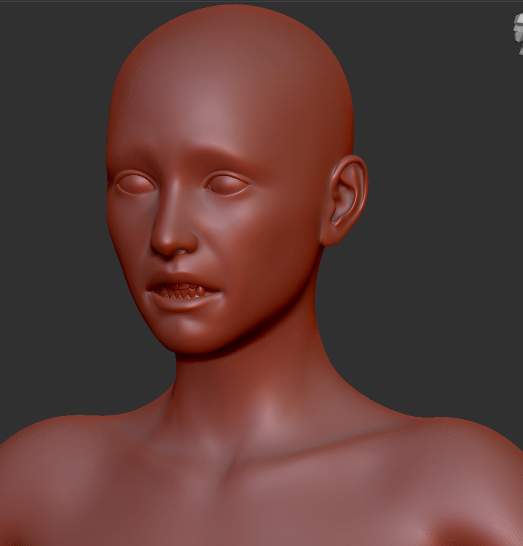

Here as a comparison the mesh without any HD information

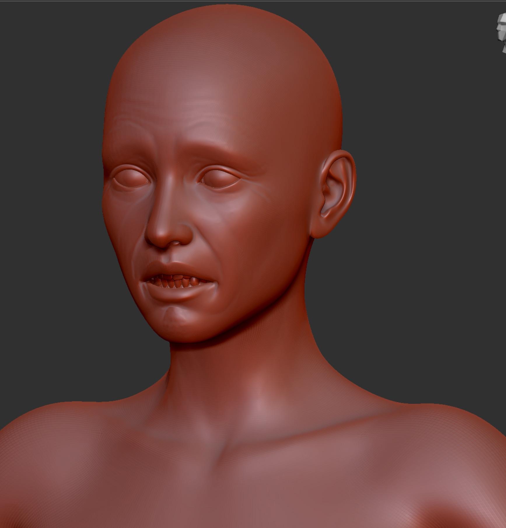

And here with (I managed to project a layer):
