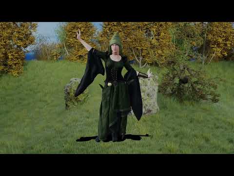

  • WendyLuvsCatzWendyLuvsCatz Posts: 41,509
    damned near impossible to animate without spikes and crumpling
    tried it by itself no smoothing too, G9 arms up out of the way,just as bad
    edited March 2023
    I made a G9 clone for G8F and autofitted it to the Ogre character cheeky
    so far 250 frames in it's simulating nicely
    the whole outfit at once (the underskirt and sleeves were fine on G9 too)
  • digitelldigitell Posts: 591
    Wow Wendy that is very impressive. I would love to see it when you have it done. That Orge character is awesome! :)

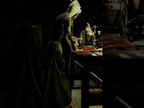

    I had issues not related to the skirt blush
    but will share
    Filament render hence the odd shading
    The dress works perfectly! Beautiful!  But is it my computer not working well or is her head shaking really oddly? I love that orge character!
    Thank you for posting this Wendy! :)
     that was one of the issues blush
    Ah OK gottcha! :)
