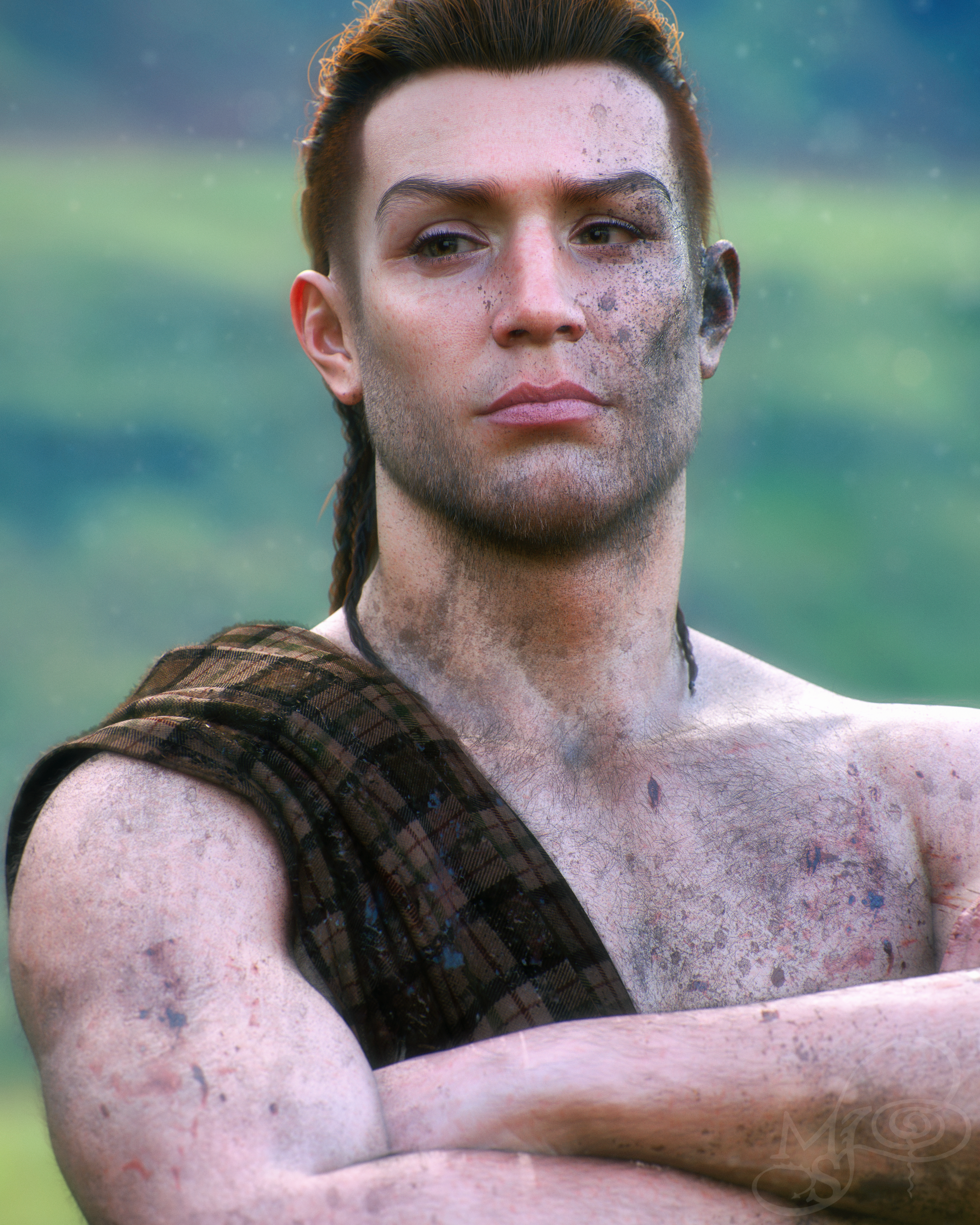

    Example...the chain here took a lot of tweaking with mesh grabber to lay properly and it took work finding the right shader for that sweater with fuzz (and don't let anybody tell you they needs the 8k texture maps for closeups because this character is obviously a sci-fi character with massively tweaked skin...but it's G8 skin (a lot of Babina 8 if I remember right).

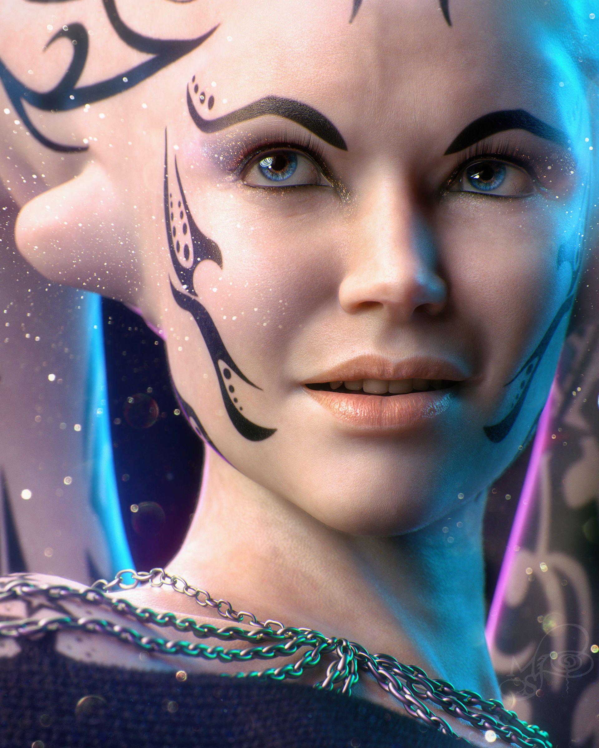

    Here's another closeup on a G8 skin...this one is tweaked Celani 8 (also super simple lighting...just an HRDI with a single spot and hair light) -

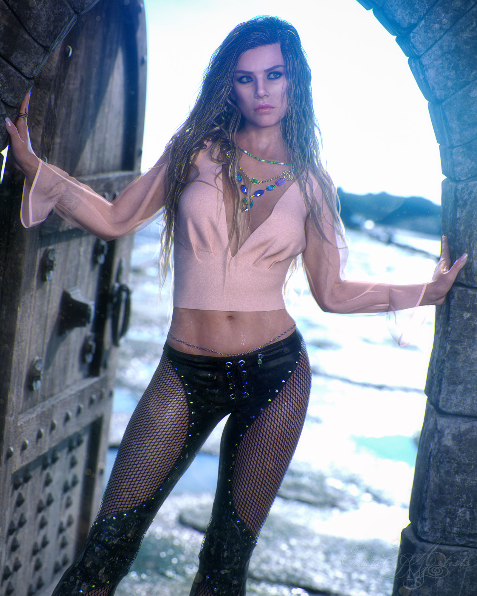

    This one is in an outdoor setting. There are things that bother me about the outfit (the sleeves don't have proper stitching where they join at the shoulder)...but I think the lighting is fantastic. It's another example of my simple setup...a good HDRI and a single spot with hair light -

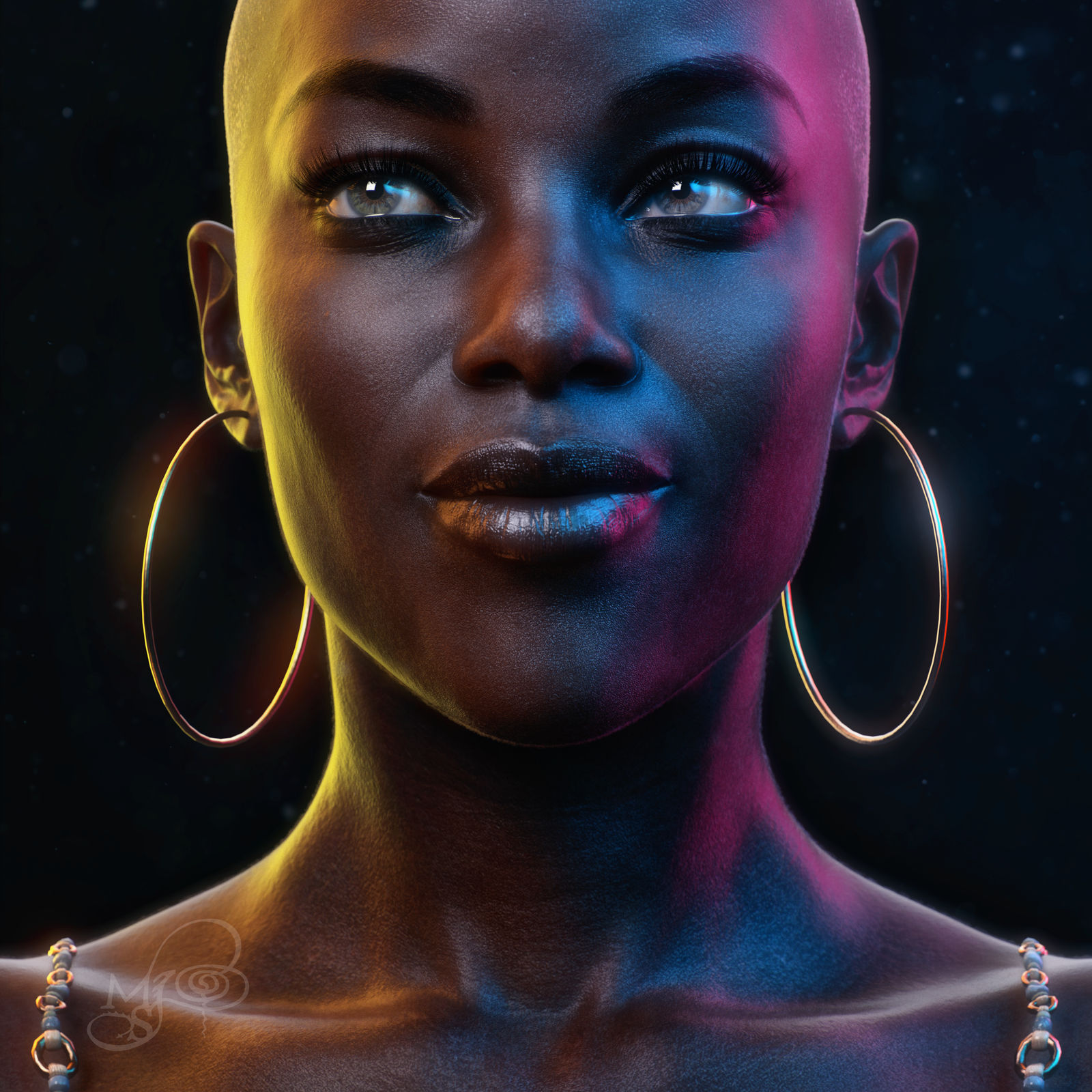

    Here is a more modern example with the same character. Same type of lighting setup...good HDRI with single spot and hair light. I spent quite a bit of time getting the soft body at the waist as well as tweaking the pants to move properly in the crotch. Also lots of geoshells and decals on the pants to add the grunge.
    Here's a boy example! Same lighting formula. This one took forever to set up those grunge geoshells and decals. Also fuzz on the tartan sash. Yes, actual fuzz. Oh and that's three separate hair pieces kitbashed together.

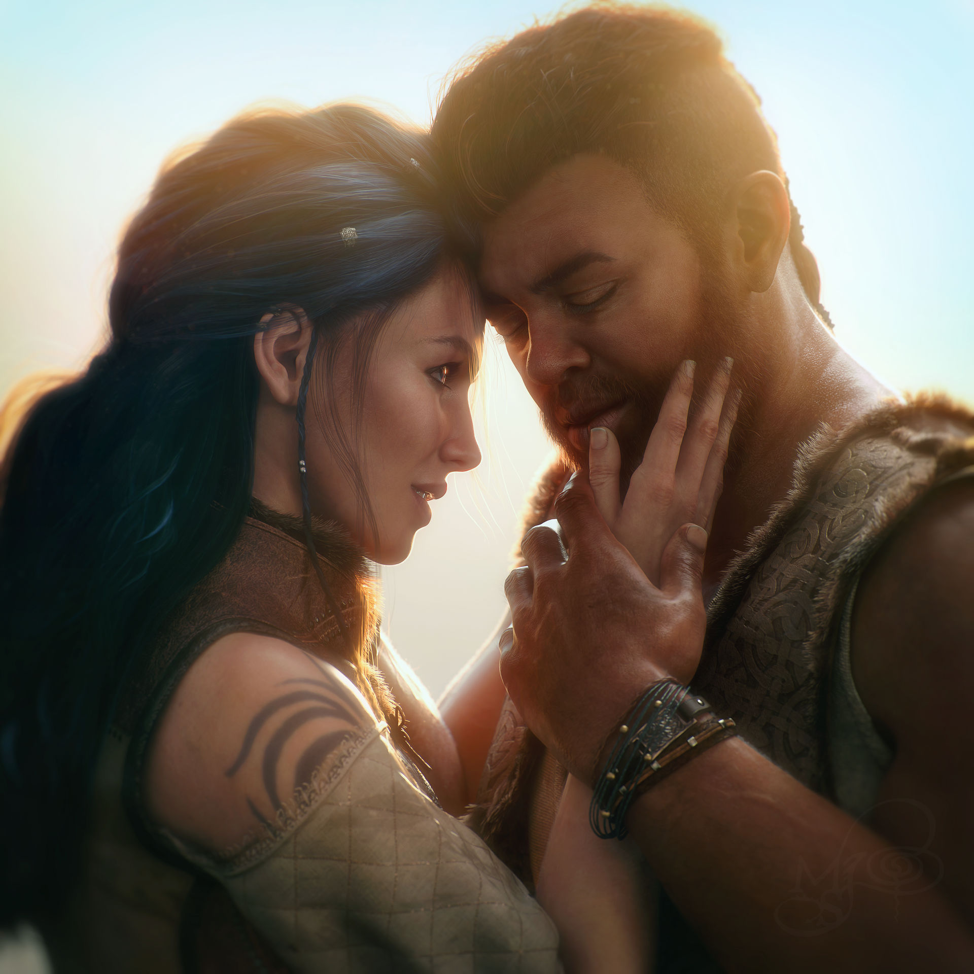

    Last one. This one is not what I would consider photorealistic (I honestly don't particularly aim for photorealism anyways)...but I wanted to show how details matter. Her hair? That's (I think) four hairstyles kitbashed together. Also mesh tweaks with mesh grabber to add in the hair jewelry. His hair? Three hairstyles kitbashed together. Strand-based fur added to both outfits. Lots of geoshells that add things like dirt and grime to their outfits and skin to make things look lived in. Both characters have custom skin. Both characters are custom sculpts. The pose took FOREVER to look emotive and natural. F-O-R-E-V-E-R. Lots of mesh edits on the outfits to make them sit more natural. Lighting on this one is more complex because there are two characters at the focus. But still, primary lighting is done by HDRI (backlit)...with a single spot (key) and then some fill lighting and hair lights for both characters -
