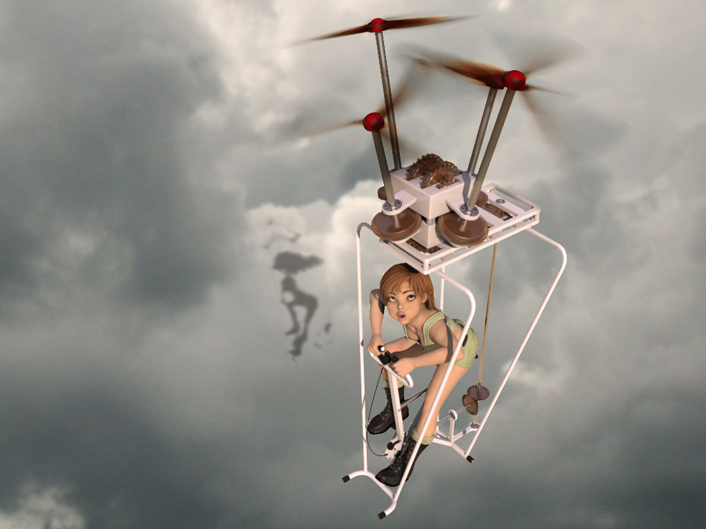

  • de3ande3an Posts: 915
    edited August 2015
    Notwithstanding the excellent advice already given, if you just want to experiment with Carrara's motion blur feature, these are the settings that I used for this image.
    Each propeller/gear assembly has a rotation modifier applied @ 10 cycles/sec. The frame rate is 24 FPS. The Motion Blur settings are "Vector Blur", Extra Frames=16. Intensity=98.8%.
    I advanced the timeline one frame, then rendered a still image.
    It took some fiddling around before I found the settings that looked right, but maybe these settings can help as a starting point.
