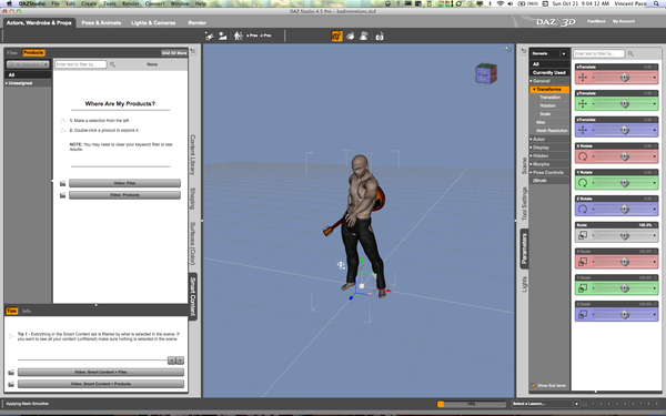

  • vip808_e751f31ab6vip808_e751f31ab6 Posts: 17
    same thing is happening to me.. even if i saved it again with a different name.. because it is happening only to my genesis characters the solution to my problem is to convert triax weight to general weight.. i dont know why but it works.. im having all sorts of problems with Daz Studio 4.5.0.114 Pro Edition 64 bit which just started about a week ago.. now im having a warning about double i.d. and my categorizes which has taked me weeks to organize doesnt load

  • fixmypcmikefixmypcmike Posts: 19,719
    For the exploding Genesis, did you try saving the scene as .duf, clearing the scene, loading the .duf, and then saving again?
    For the duplicate IDs you need to either reset the product giving you the warnings and install the updated version, or use Richard Haseltine's script (or ignore it -- in most cases the items will still work).
    For the categories, have you tried restarting the CMS?
    fixmypcmike,
    thats a negative at saving as duf. still explodes., I'm not a programer and cant makes heads or tails from the log.. dont know where to find or what to do with Richard Haseltine’s script.. i know the product that's failing is my Genesis so im reinstalling that, coiuld not find any updates on Genesis Starter Bundle so im just gonna re-download it and install it again..spent most of the day looking for a way to restart my CMS cant find the thread that i used before.. just saw the post about the Daz4 update so im gonna try that first before i sleep

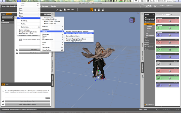

    thanx fixmypcmike for the help.. characters are still un-pose-able tho.. they just deform when u move them...
    Is that with the Triax weights, or after converting them to a different rigging system?
    it is with Triax weights i dont know how to covert it to a different rigging system...fixmypcmike, what updates did Daz3d studio do in the last weeks that effected Genesis? do i need to buy that DYSON importer to make things work?

  • kitakoredazkitakoredaz Posts: 3,526
    edited November 2012
    I do not know why it can work, but it seems not good solution.
    maybe you need not convert triax weight to general weight.
    because of you have changed the genesis weight to general weight
    I think if , you can not pose the genesis now,,,
    do you have oliginal saved .daz file sitll?
    lets try again, from start pointo.
    first load " your.daz" file. and not touch anything.
    ust save as. "your.duf "file.
    when you load the "your.duf" scene , it may broken. (your figure may exprode)
    not need to change triax to general weight.
    just save again the your.duf file as same name . your.duf
    (you may need not the corrupted duf.file anymore, so you can overwrite it as same file name)
    now you have broken figure icon for the twice saved duf file. but if you load it,
    the exproded genesis problem will be removed.
    this is your start point to remove your problem.
    then,, next problem is, how poze your genesis.(if you can not poze genesis still)
    when you load the, duf if you have no erroer message, (not important think about duplicate ID erroer now
    you can remove them,, if you want, but it seems no refference about your pozign problem)
    if you can not poze genesis about new saved.duf scene (without changing weight,,)
    I want to check if you used many pins cothings and figure about pozing? or if the clothings set Enable smoothing on?
    first just remove all pins,(if you used it)
    and turned off Enable smoothing" then what happen when you set new poze about genesis.
    genesis will break ? or clothing will break?
    edited>>
    and what character morph do you apply the genesis for the scene? y
    if the morph file has problem, I think you can check it by log file from top menu
    Help >trouble shooting>view log file
    if the problem is from character morph, you need to download and reinstall new version of the product.
    and set again the morph to the genesis in your scene.
    if the problem is from your clothings, you need to download and reinstall new version of the clothings.
    you need to check, what item you have used for your scene. not think about all items which you have not used in your scene now.

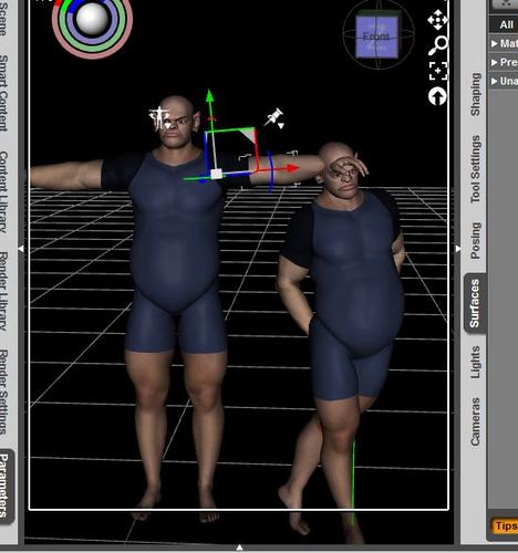

    did what u said saved it as a character preset titled your.duf, closed DS4 reopened and loaded your.duf
    character opens up with boobs, adjust the victoria 4 dial (funny i never used it building the character), then i tried posing the arm
    oopps pic 1 and 2 are switched sorry the 2nd pic should have been the first
  • Richard HaseltineRichard Haseltine Posts: 111,382
    The images had to be removed as they showed a nude figure - either show an untextured figure or give it some clothes.
    Your problem appears to be that you have changed the shape enough that the joint centres are no longer within the mesh, and so you get weird distortions. You need to adjust the rigging to accommodate your morph:
    Apply your morph, only - no pose or other morphs.
    Edit>Figure>Rigging>Adjust rigging to shape.
    Try some poses to make sure that is working.
    Assuming the rigging is now right, make sure the pose is reset so you have only your morph and the adjusted rigging applied.
    Right-click on the Property Editor's tab to get the pane menu, select ERC Freeze.
    From the drop-down lists at the top select Genesis as the figure and your morph as the control property. In the From the scrolling box at the bottom make sure that the only things checked are adjusted joint centres. Leave the options at the bottom of the dialogue checked, and click Accept.
    You should now find that setting your morph also adjust the joints to avoid distortion. Assuming that is so, save your morph as a Morph Asset (File>Save as>Support Asset>Morph Asset).

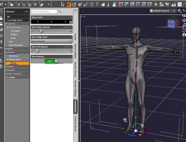

    you may need to change Display scene view bone property, of figure to check your morph how move bones,,
    when you apply your morph, and check the bone,, you may understand,,
    how they wrok or not,,
