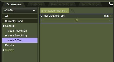

    DWG said:
    I've seen some references to the new push modifier in 4.5 being a solution, but I've not had a chance to play with it yet to see how well it works.
    ETA: Okay, I've had a quick play, the Push modifier allows you to specify an offset between an item and the item it is conforming to. Given that clothing doesn't have a fixed offset between skin and cloth that's not ideal, but it is one more tool than we had before.
    In my experience using the Push Modifier doesn't really do that. It thickens up the item ... a slider is then provided to give you control over how thick it goes.
