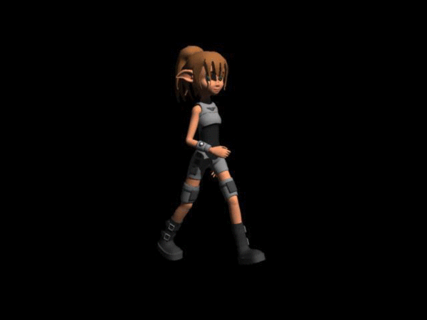

    It took about 20 mins to come up with this for a start to a walk cycle and it has a ton of work still to do to. In fact I would most likely start over. I started out using target helpers but they were more trouble than I wanted so I stopped. The tools I used were Puppet Master and Fenric pose helper. I rushed it a bit. It would not be as jumpy if I had setup poses better and such. I made a list of poses and created a new puppet master dot for each one, Contact, pass position, contact. (I should have made it like Contact, down, Pass position, Up, and contact. This would have given way better results.) I added some in between frames to help the legs pass through points and then used Fenric's plugin to reverse the poses from PM.
    640 x 480 - 409K
    Post edited by 1MoreThreadDeleted on
  • 1MoreThreadDeleted1MoreThreadDeleted Posts: 56
    It is an animated gif. It is not playing back very well in the forum. Have to click on it to see it better.
