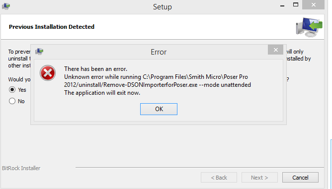

Can't uninstall DSON?
In my speal of issues with DSON I tried to uninstall it andd reinstall it.
I went to Programs and Features and  tried to uninstall it from there but it said there was an error and it may have already been uninstalled (I never uninstalled it?)
So I went to 'reinstall' it it said a previous instalation was already detected and askeed me if I would like to uninstall it. I said yes, and it gave me this error:
It is bizarre because I do not even have PP2012.
I have it set to install to PP2014 but it doesn't.

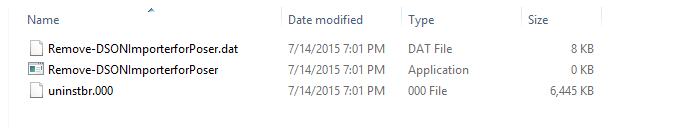

I have, for some reason, a PP2012 folder that just has RemoveDSONImporterForPoser

    Find the addon folder. The DSON folder is inside of it.
    We have to troubleshoot one thing at a time. If it doesn't resintall, then we'll figure that out.
    Do you have both a folder showing for 2012 and 2014?
