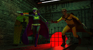

    Here's the WIP I promised. There are three lights (red in sewer grate, green plane below zombie and a bluish light behind the camera). I obviously need a little more light, so I've added a white panel behind the camer and I'm hoping that an 18+ hour render will yield some good results. For access to a larger image, swing by my blog: http://mikemitchellonline.blogspot.com/

    So far, the light is doing a nice job of casting enough shadows to give the bodies definition. I've still got some graininess in the deep shadows of the capes. Oddly enough, I've still got a little red specking in the brightest part of the image, which is the doorway with the zombie. I thought that back wall would be finished by now.

    I let the image "cook" for about 42 hours, and was definitely happier with the results. I suspect this would have taken 4 or 5 days to finish, and this just wasn't important enough to let it run that long. This gave me enough to see if it's worth looking at, and enough to do some quick post work so I'd have something I could use. This image will not be making it into the Powers Beyond RPG, but it was a lot of fun and I did learn more about iRay rendering. So, all in all, not a bad experience.
    To see a larger (1,000-pixel image), visit my blog: mikemitchellonline.blogspot.com
