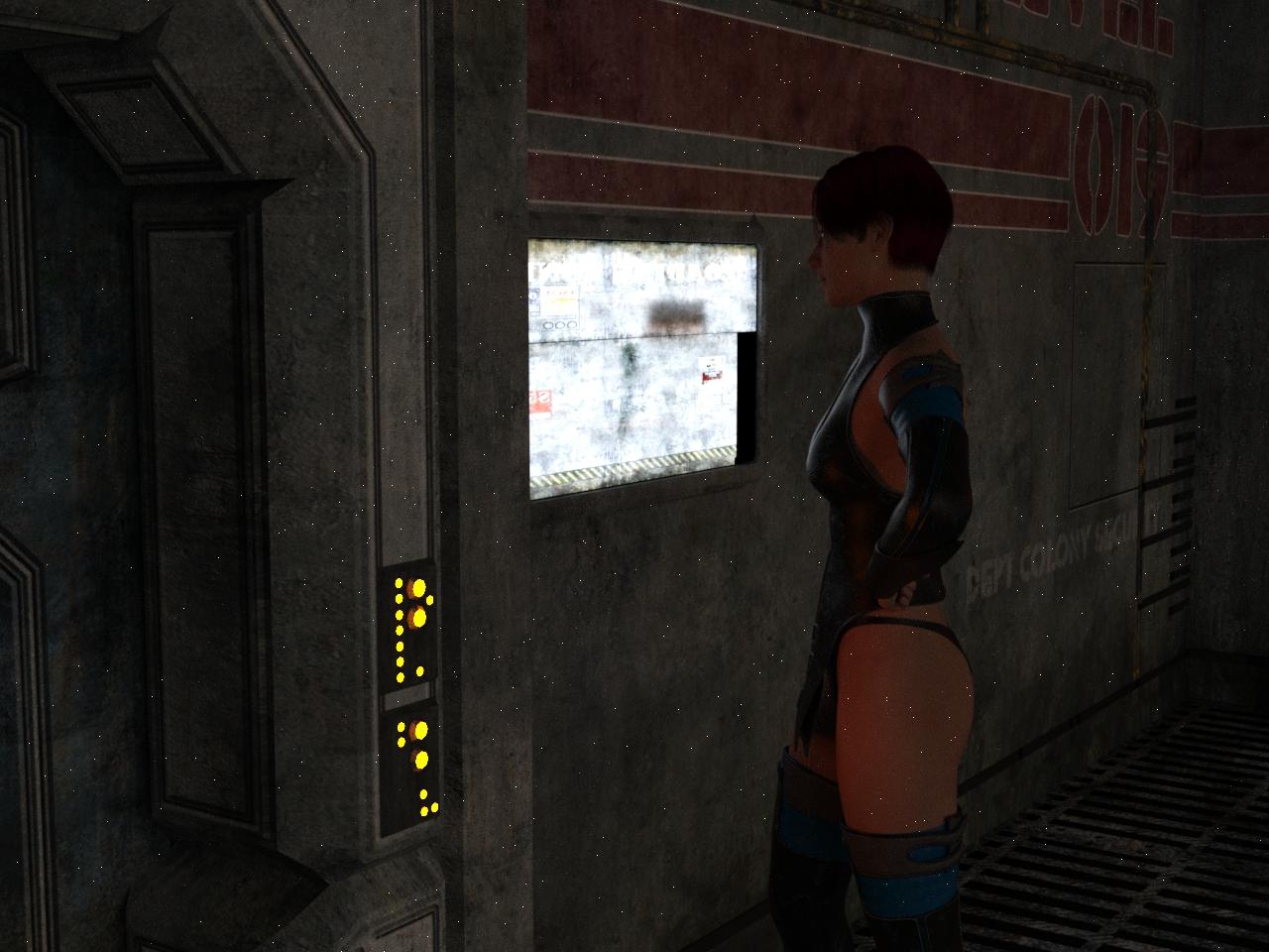

  • FishtalesFishtales Posts: 6,232
    In Iray go to Tone Mapping and change the camera settings to Shutter Speed=1, F/Stop=1.4, ISO=400 and I set White Point to 0.96. You can play about with the Speed/F/Stop/ ISO settings if it is too bright/dark.
    Someone will say you don't need to set them all but I'm a photographer and that is the way I work cheeky

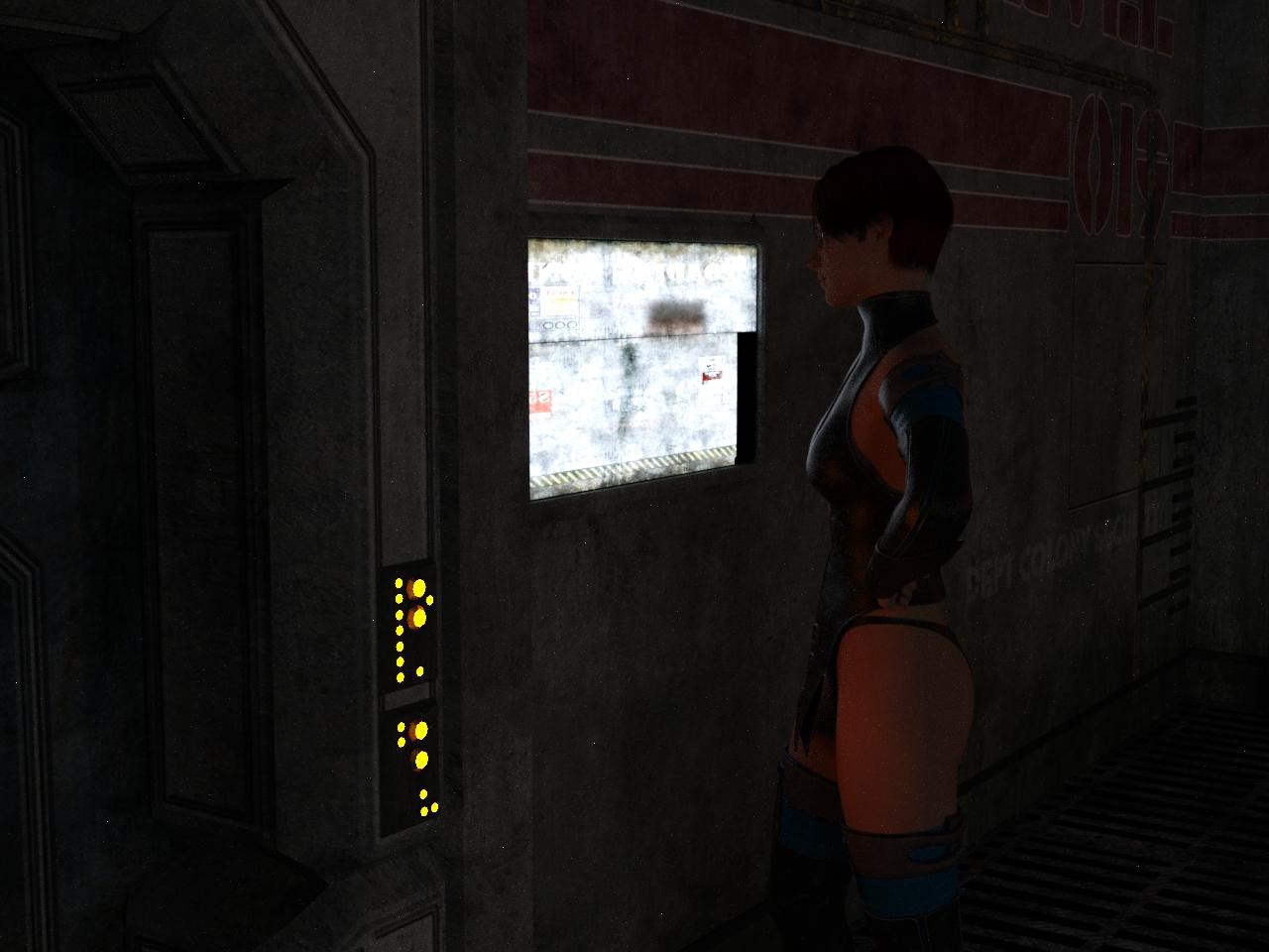

    I have a big render running ATM but I set it to run on two cores and set this scene up on the other two and rendered it.
    The light is coming from the row of LED's on the left and the big panel in front using the Emissive Light shader. LED's are 5 watts at 0.5 efficacy 1500 K temperature and the panel glass is set at 5 Watts at efficacy 5.0 7500 K temperature and a random .jpg from the scene files.
    The camera in Tone Mapping is set to Shutter Speed 1.0, F/Stop 1.4 and ISO 400, white point 0.96. Environment is scene only.

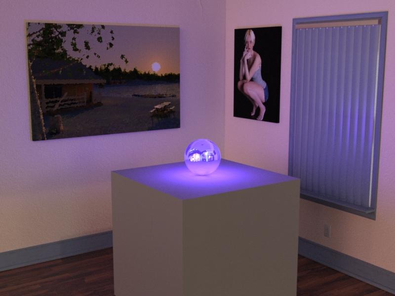

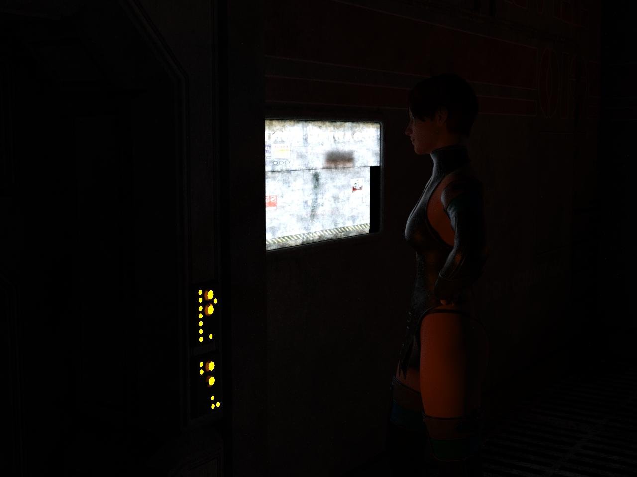

    As I had it set up I did a few more renders. Images 1,2 and 3 I added extra lights. The environment is Level 19 and there are lots of lights dotted all round laugh
    First I added Emissive Shader to the column lights in Image 1.
    I then added the overhead lights in image 2.
    I pulled the camera out for a shot to show all the lights. The Tone Mapping camera settings in these three images are all the same as the original image in the previous post.
    In image 4 I changed the Tone Mapping camera settings to Shutter Speed 1.5, F/Stop 4.5 and ISO 400 to tone down the lights and get a bit more shadow.
    Image five is the last image showing all the lights with all the Tone Mapping camera settings set to default.

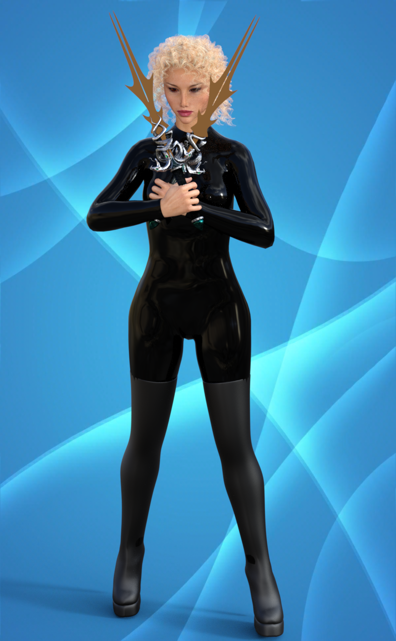

  • If possible, I'd like to posit a slight takeover of this thread to adjusting our results for what we get when we do properly apply the emissive shader.
    Side note: Fishtales' suggestions went a LONG way toward my getting my emissive renders to work properly. Thank you so much.
    I'd like to offer up to the table my "Alice's Adventures In IRay" piece, found in my gallery over here: http://www.daz3d.com/gallery/#images/209271/
    As you can see in the description, I'm happy with a lot of this image. However:
    *The jewels and fingernails aren't being "beacons" like I'd prefer them to be. They seem flat, and I'd like them not to be.
    *I have the reflection settings turned up to the maximum they can be for her eyes and the lights are still not coming up as much as I feel they should.
    *For some reason, I can't get her earrings to be a cooler white - they come over as a warm white, casting that yellowish tinge. Not sure how to get that cool, blue-white light (and yes, I tried applying a slightly different "white" off of my pallette - no dice)
    Would getting and using the DG IRay Sci-Fi set help me get what I want, here, do you think? Or perhaps something else?
    I'm open to suggestions and critiques, here. I want to use the emissive shaders to their full potential, and I honestly can't wait to get the most out of them.
  • KhoryKhory Posts: 3,854
    I suspect that you need to increase the level of luminance amount if you want it reflected by the eyes. You also should check the color temeprature on the earings and see if they are lower than 6500. If so change it to something like 7200 and see if that does not cool them out.
  • Right now, the lumens on the earrings, the nails, and the jewels are all set to 75k, but the color temps have not been touched. I'll give that a shot and see what I come up with.

    The light emmission coming from those pretty much guarantees they will look flat in your renders - if you want them to appear to be lit relative to the rest of the scene but still retain their geometric scape they need to be much more reflective and smooth compared to the rest of the scene and off scene lights placed that will be reflected off the objects. You will have a hard time causing two different color lights to be reflected off those objects so close to one another.
    The alternative is you turn down th emission of light from those to be about 1 w and then the geometry of those shape may be visible, but still probably not. That is not enough to light too much the rest of the scene without making them very shiny and oily and smoother than is typical.
    Thanks!
    Darker colors don't put out as much light as lighter colors, so if you are still at 75K for the blue and red, don't be afraid to double it, and keep moving it up. Making the surfaces light emissive does pretty much kill any reflectivity, yeah.
  • Darker colors don't put out as much light as lighter colors, so if you are still at 75K for the blue and red, don't be afraid to double it, and keep moving it up. Making the surfaces light emissive does pretty much kill any reflectivity, yeah.
    Yeah, I'd been noticing that. Which kind of sucks, because I had a thought that putting some metallic flake components into things would give a really great light profile when all was said and done.
    150k lumens seems a bit much to me, but I'll give it a shot and see what I can come up with. If it looks good enough, I'll post it here in the thread.
