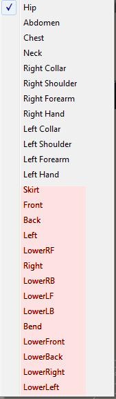

    I pulled up Lirio.  In Poser I have handles for the skirt, quite a lot of them.
    169 x 578 - 66K

    What Chohole said. Either the long dresses have handles you can use, bones or morphs. You might want to look for those. Especially in the V4 days, handles were all the rage.
