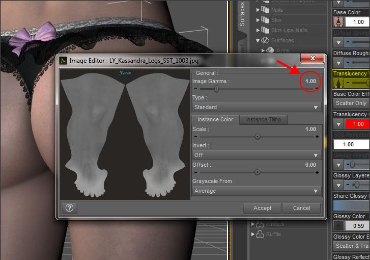

    This is a quick and dirty fix.  It's not hard, just different.
    This is what we are starting with when the character preset loads:
    We can all see the lines.
    (this doesn't happen when you load G3, then the full body morph and then the skin texture.  For some reason, this is only the character. Once you load the character, you are stuck with the lines)

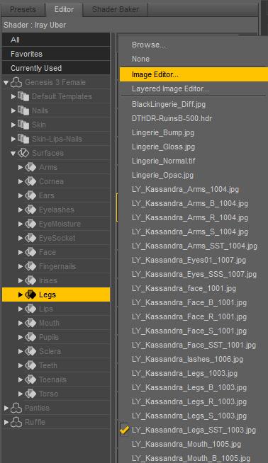

    there is only 1 setting that you need to change.
    Select G3 in your scene, go to surfaces, find Legs and then Translucency Weight.
    Regular (left) click on the picture and to to Image Editor, see pic.
    then change the value at Image Gamma to 1.0
    hit accept.
    Voila! All fixed!!
    Please note that I am assuming that you know your way around Daz Studio.
    I have shown you my setup which is customized for my work. Your layout will not look like mine.
    However, the menu selections and windows are the same

    Sorry but this issue is not a bug to my eyes...
    Open the duf file of kassandra preset (LY Kassandra 00 Iray Character.duf) in a text editor like context for example....
    Go to line 159 : you'll see :
        "id" : "LY_Kassandra_Legs_SST_1003.jpg",
                "name" : "LY_Kassandra_Legs_SST_1003.jpg",
                "map_gamma" : 0,
                "map" : [
                        "url" : "/Runtime/Textures/Lyoness/Kassandra/LY_Kassandra_Legs_SST_1003.jpg",
                        "label" : "LY_Kassandra_Legs_SST_1003.jpg"
              then some line "down", 214 see the setting of torso sst :
    "id" : "LY_Kassandra_Torso_SST_1002.jpg",
                "name" : "LY_Kassandra_Torso_SST_1002.jpg",
                "map_gamma" : 1,
                "map" : [
                        "url" : "/Runtime/Textures/Lyoness/Kassandra/LY_Kassandra_Torso_SST_1002.jpg",
                        "label" : "LY_Kassandra_Torso_SST_1002.jpg"
    So .... ;) just a faulty setting not a bug from DS..or Iray.
    Modify the line from 0 to 1 in gamma setting for legs SST and all is done.
    Just an update to make from new customers ? ;)
    @Lyoness : However, your character and your work is very nice! ;) I like to use it in Daz...Keep the good work ! ;)
    Post edited by info_44cc80827d on
