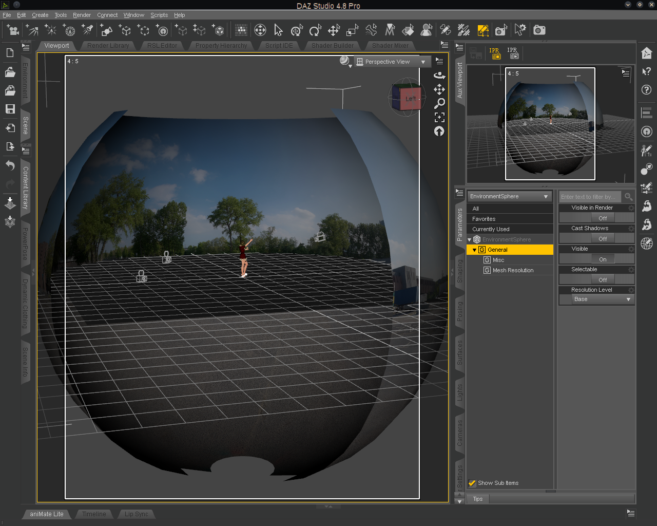

    edited August 2015
    I'm using City Limits, so I'm not sure where it will be if it isn't along the top, in the other layouts....
    (It's the orange-yellow tool).
    geometry edito tool
    Select it, then select the dome/sphere in the Scene pane.  Then zoom out (use the 'center camera' tool) and select parts of the sphere/dome and right click.  Geometry Visibility > Hide Selected Polygons.

    Mjc's suggestion of taking an existing skydome, which is already UV mapped, and hiding polygons seems to be the most straight forward approach. I just tried it with Terra Dome, taking out the full front face, and it worked very well. You can use the H and V tile offset to position the image you're using.
    I applied the default Iray Uber surface, and dialed off any glossiness. The channel inputs accept HDRs as well -- they won't light the scene, but many are already spherically projected and scale properly on the dome.
    Depending on the lighting for the scene, and whether you're using the Iray dome, you may need ot bring in some additional lights. I found I didn't need any -- the "Ruins" HDR environment provided enough indirect illumination, and I already had augmented the scene with a couple of soft spots. You can also increase the environment intensity if the dome blocks too much, and/or remove more polygons. All you need is enough for the camera view.
