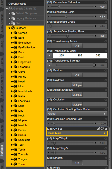

    It looks like it's using the wrong UV settings; select the character, then in the Surfaces tab select "Surfaces" and set the UV set to "Base Male" and see if that helps.
    -- Walt Sterdan
    Thank you Walt. I already had UV Set to "base male" so it cant be this. No working but i really thank your help.

    It's not the UV set...it's not tiling...both of those are showing in that last screenshot.
    But it is definitely something with the loading of the image files.
    Go up to the Default Templates, select Template 1 (that will be the face)...do a series of screenshots of the surface settings.  The diffuse color in particular...
