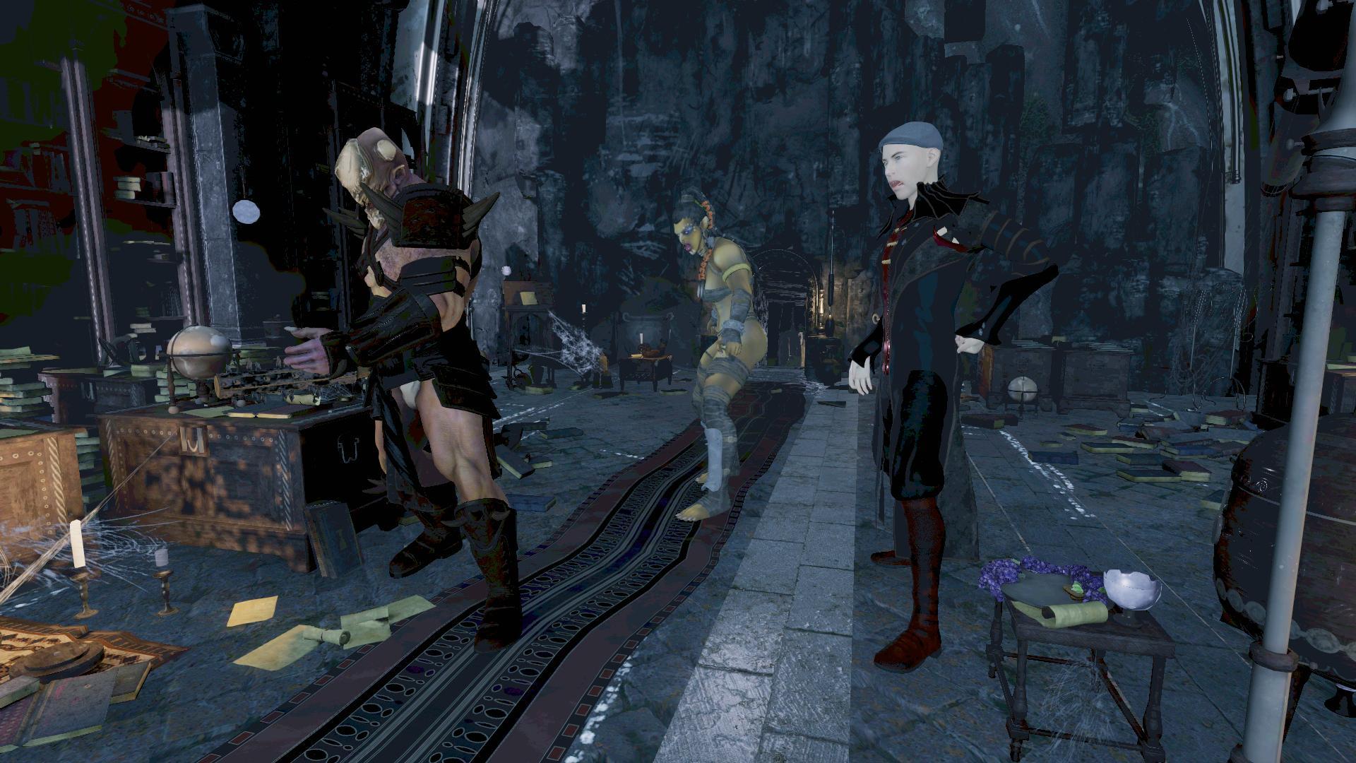

    I thought about where to start on this and thinking about it there is a fair bit to cover, so I thought the best way to start is by starting at the end and working backwards as I've already shown a sort of final result. Even though it is important what we do with Daz models into Unity and how well we set them up, if we give up on the final step in Unity to light and post process and get discouraged about the final result it will be all for nothing, so sad.
    Topic 1: Lighting and Post Process Stack In Unity for Daz models
    So below is an image of the same scene without good lighting and post processing also in HDRP exact same Unity characters and models. If you click on both the first one and this second one and look at the full images side by side in 2K I think you will clearly see the second one is not as good in many ways. I think this shows clearly it's not really a Daz model fault that we get some what I think are bad looking results in Unity. The simple default style one below is with just standard sort of Sun and standard indirect lighting (ambient etc...) and no post processing. The first better looking one has the same Sun but a lot of different other lighting and post processing.
    Could people please comment and feedback if showing how to go from this image to the one previously posted using good Unity lighting and post processing of Daz stuff would be good to detail how to.

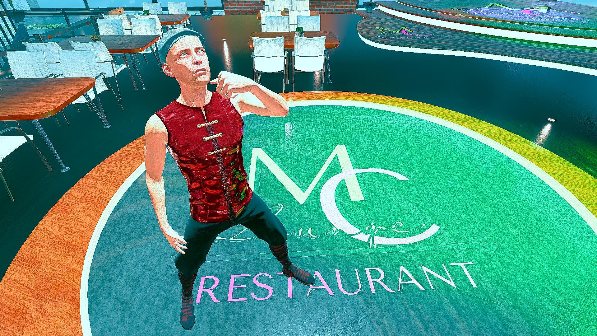

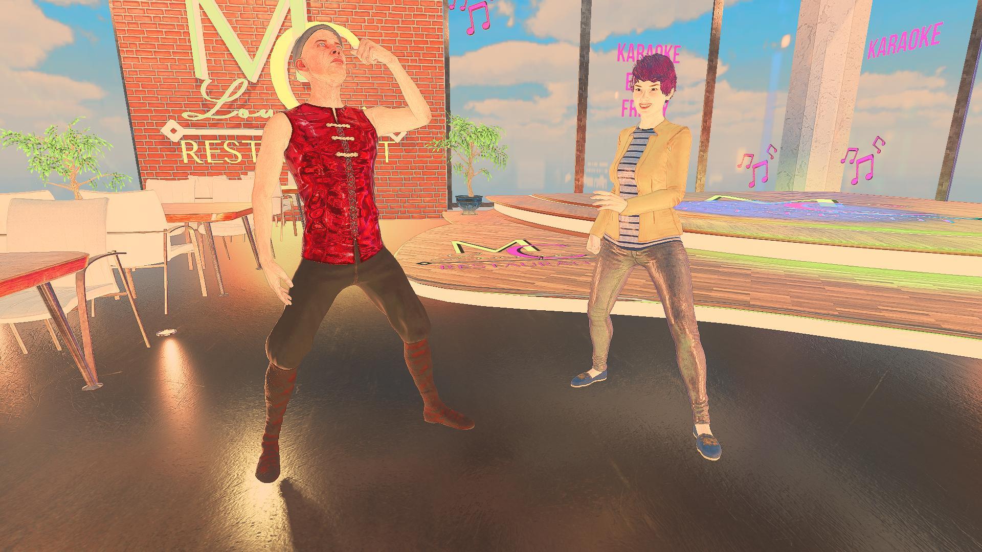

    I have tried a ready made scene in Unity with Asher 8 (on the right)
    and 2 other characters, to see how it looks
    and if the lights and postprocessing works well for Daz 3D character.
    The render is made with a built in pipeline.
    1920 x 1080 - 288K
    Post edited by Artini on December 2022
  • ArtiniArtini Posts: 10,902
    December 2022 edited December 2022

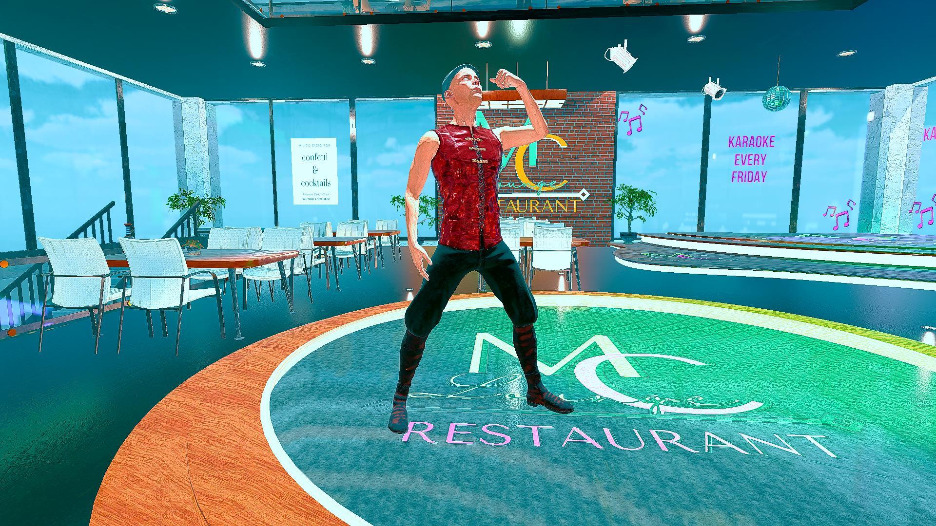

    Now I have changed the material to Christian 8 (on the left)
    and it looks better to me.
    Have not solved yet, this open mouth problem, while using humanoid animations from Unity.
    Using the beret, to avoid problems with the hair.
    1920 x 1080 - 246K
  • ARealitiARealiti Posts: 158
    On the Prefab's underlying model, choose Rig, Configure, then Head and remove the Jaw Transform to None. Animation of the mouth still works and all morph animation still works on the face which is nearly all talking and facial expression animation. See screenshot attachements.
    Unfortunately, you can't get visual results like the first one I posted with anything other than HDRP.
    568 x 179 - 15K
