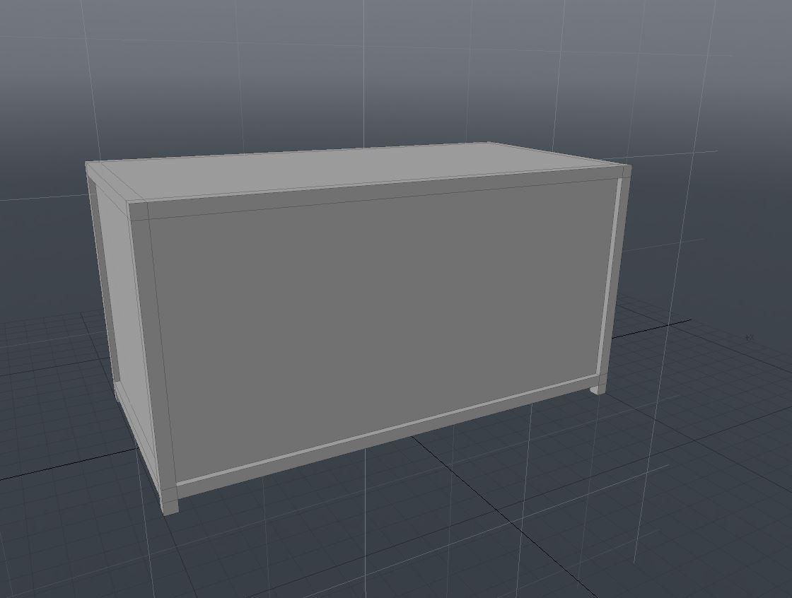

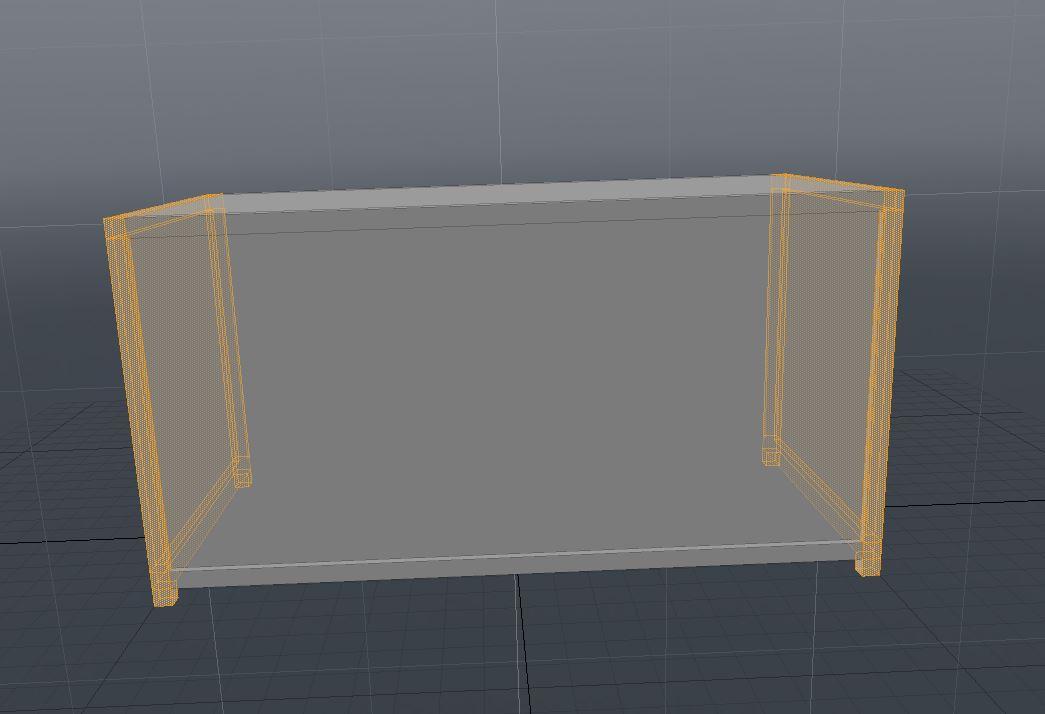

    Create the model - I used modo, simply adding 2.5cm slices around the edges, insetting the front and side panels and extruding 2.5 cm feet. I exported this as a base shape OBJ

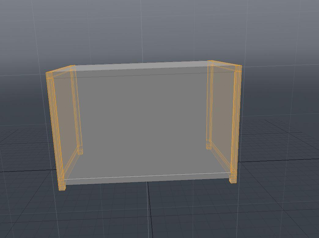

    Create the scaled shape - I selected the end polygons, with symmetry, and translated them in so that the inner panels changed size but the structural sections remained at 2.5 cm. A more complex shape might require more fiddling. I also exported this as OBJ

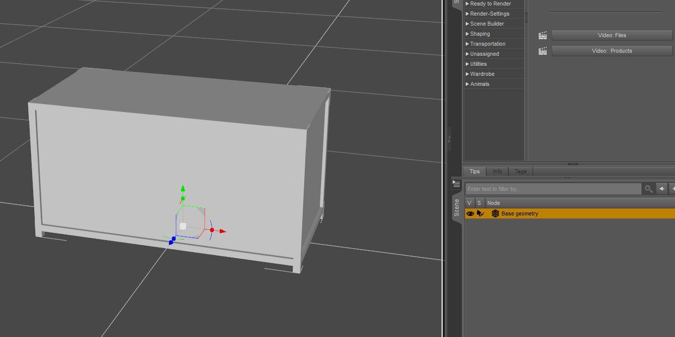

    Import into DS - I imported the Base Shape OBJ using the modo preset to get my prop.

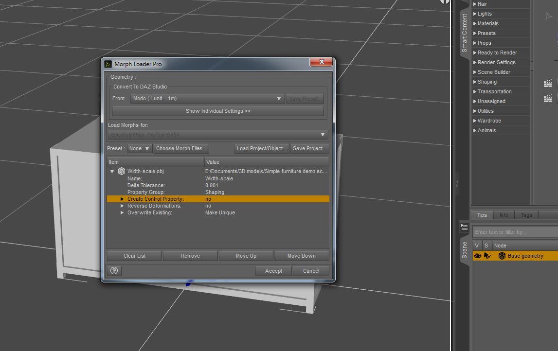

    Import the morph - I used Edit>Object>Morph Loader Pro to select by scaled shape, set the preset to modo, and adjust the path for the morph by right-clicking, Create..., and entering Shaping

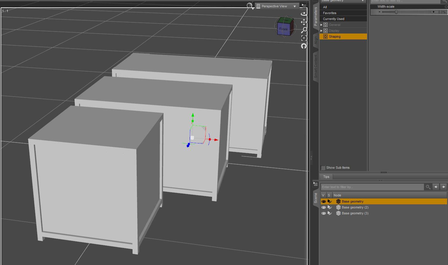

    Test - I clicked the gear icon on the new slider and adjusted the limits, then I duplicated the item twice - the back example is the base, the middle is at 100%, and the fron is at 250% - as you can see the width of the elements is preserved. I could have added similar morphs for depth and height and they would not have interfered with each other.
    1120 x 846 - 53K
    1045 x 714 - 57K
    1043 x 781 - 59K
    1147 x 722 - 84K
    1521 x 900 - 91K
