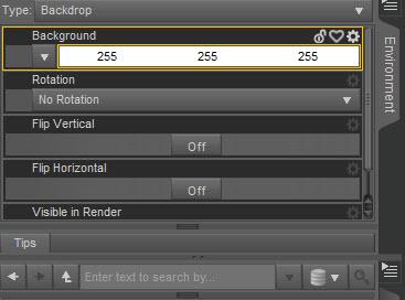

Okay, where did DAZ put the controls for changing the background color in Studio 4.8? I know they are bound to be in there somewhere, but bedamned if I can find it.

    Window > Panes (Tabs) > Environment
    367 x 272 - 29K

    Thanks. That will be a help. Black is fine for some things, but I generally prefer to work against a light background.
