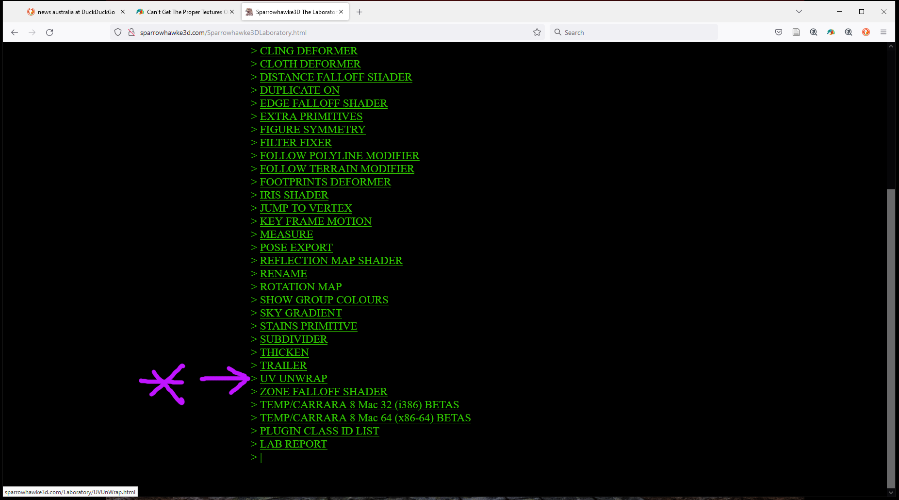

  • Bunyip02Bunyip02 Posts: 9,333
    edited December 2022
    Stezza said:
    Sparrowhawk also has a plugin to untick UV but I can't find the link to it... Wendy or Bunyip may know
    Open the Laboratory link and scroll down the list.
    Here's a link - http://sparrowhawke3d.com/Sparrowhawke3DLaboratory.html

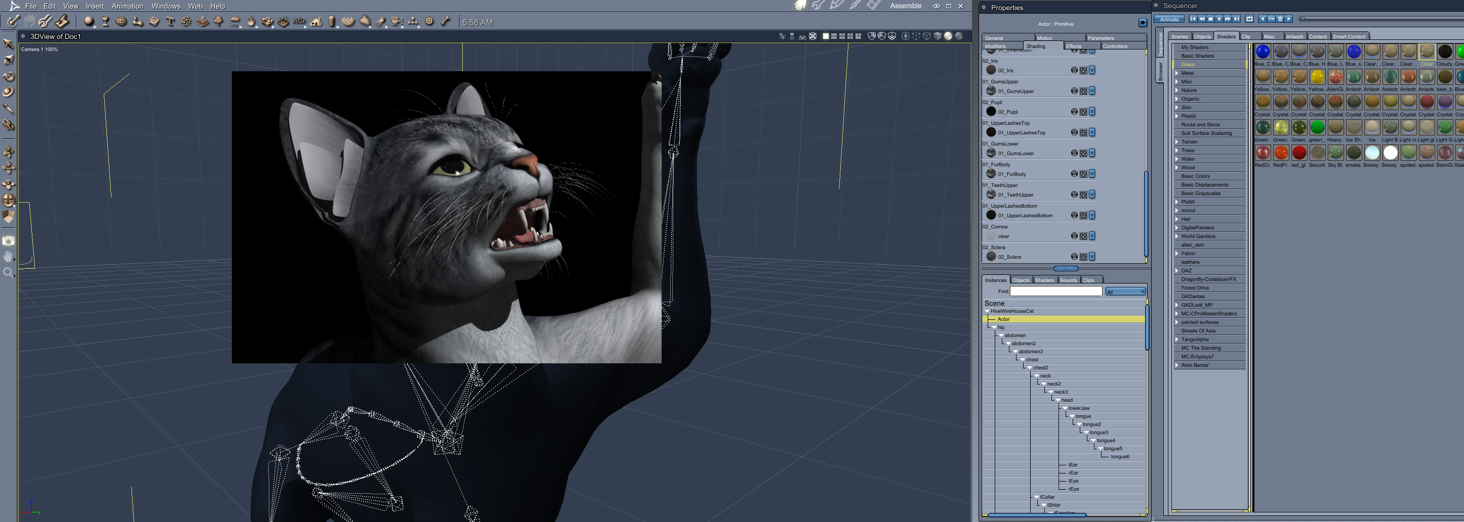

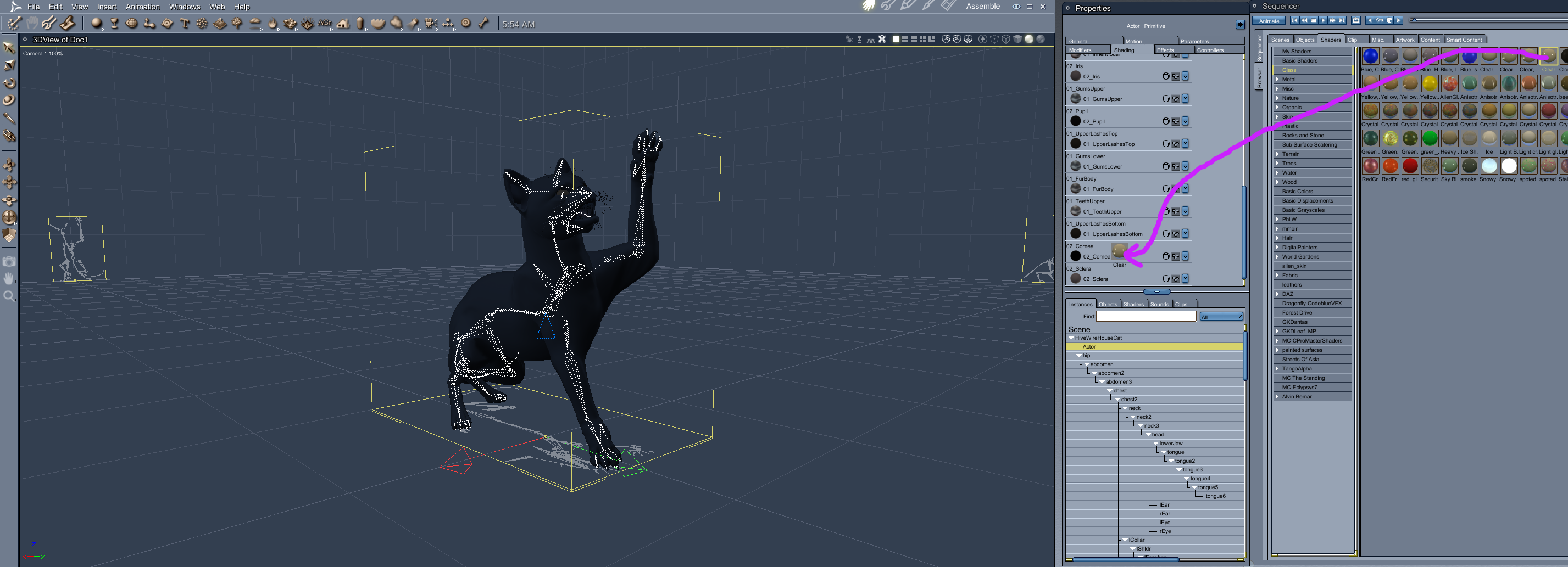

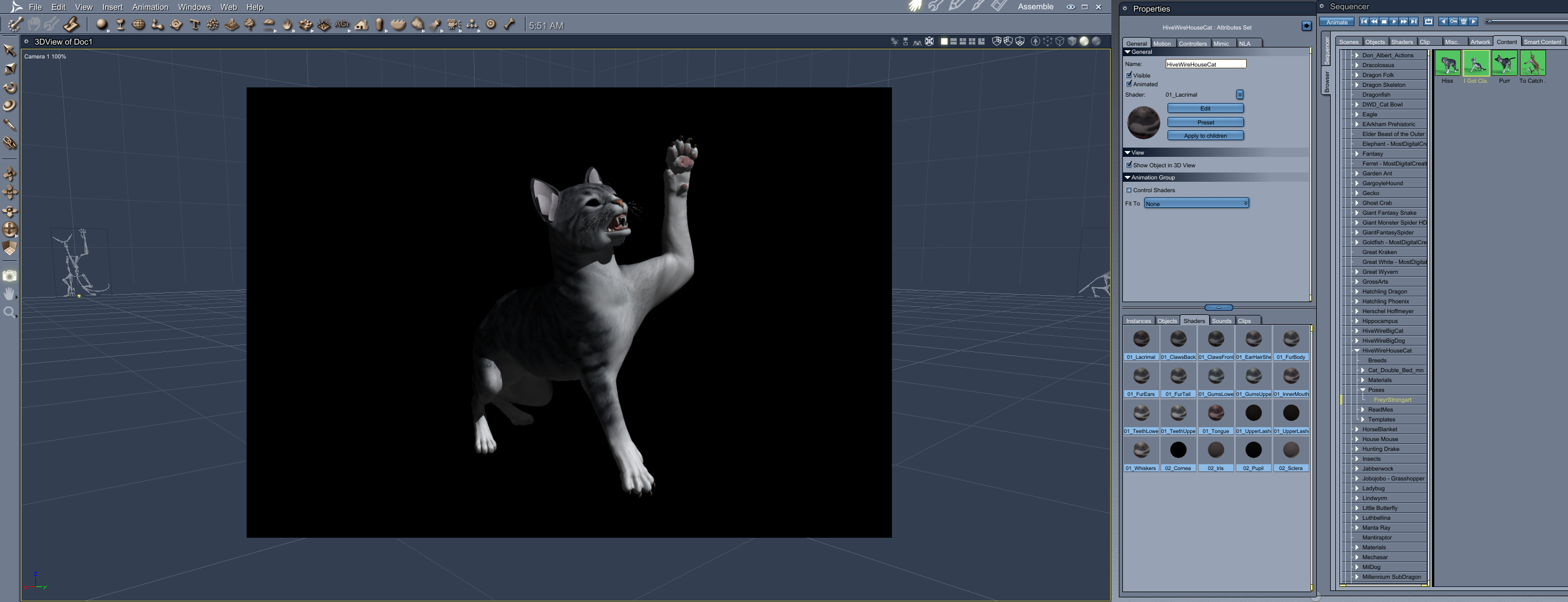

    Check your Shaders - the Cornea is Black - needs fixing
    Go to Instances Tab and click on Actor.
    Next click on Shading Tab, locate Cornea.
    Go to your Shaders Tab and locate your Glass Shaders - select a Clear Shader.
    Drag the Shader onto your Cornea in your Shading Tab.
    Do a test render

  • StuieStuie Posts: 58
    Damn, that was too easy. I duoble clicked the cornea shader, but instead of dragging the glass over to it, I just adjusted the transparency option to 100% in the texture properties. Thanks so much for everyones help. (Dartanbeck, Bunyip02, Stezza). Looks so much better.
