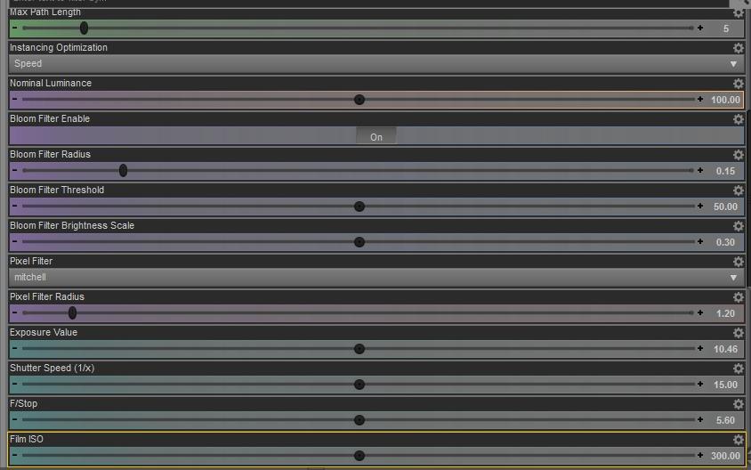

    Getting it to do that has something to do with the bloom threshold and the firefly nominal luminance settings. I did it on another render by trial and error by setting them so that only a certain light temperature was being affected. I'm sorry I can't be more specific as I try things randomly until something works but a lot of it doesn't work every time on all renders smiley

  • FishtalesFishtales Posts: 6,236
    edited March 2016
    These should be the relative settings I used in the render.
