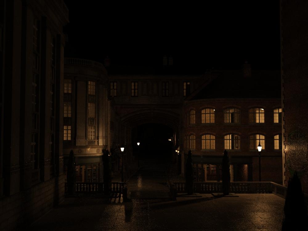

    This is a quick partial render I was doing for something else.
    The lights are all emissive; 100 Watts in the buildings; 150 Watts in the street lamps, all set at Luminous Efficacy of 15 ; Emission Temperature of 2900. Everything else is at default.
    Camera settings in Tone Mapping: Shutter speed 4,0 (¼ sec); F/stop 2.8; ISO 400.
    1000 x 750 - 356K
