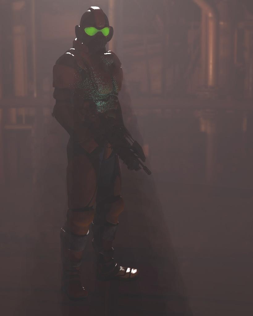

    Shader Mixer itself could be considered a shader...and that's where it gets a bit confusing, because it's 'modular'/node based.   So while anything built in it isn't really a stand alone, complied (yes, that's another thing that can be used to separate what is/isn't a shader) shader, what it's built with, as a whole is.
    The way they are applied is dependent upon how they are saved...as a material or shader preset.
    epsilon armor alt shaders
    All the surfaces in that image, the 'atmosphere' and even most of the lights are all compiled shaders, from sources outside of Studio.  The fog is a standard 3DL shader, the armor is a suface shader I've been working on, the environment light is on made by Mustakettu, the goggles and part of the gun have an emissive shader, that I've been working on (looks like it needs more samples, as it should be smooth, not dots, on the illuminated area of the chest).  The only one (unless I missed a surface or two) that is not external the shadow catcher on the 'floor'.   Oh, and it renders in about an hour...on a low to mid powered system (about 35 minutes in the standalone 3DL).
