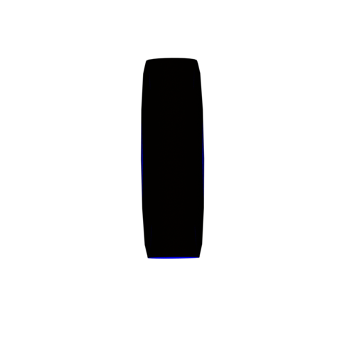

  • ReDaveReDave Posts: 815
    Refraction has been stomped upon by the Borgs and is utterly broken in DS4.5! :-(
    Opacity 1%
    Diffuse Orange 100%
    Refraction Blue 100%
    Max trace level 12 (just to be sure...)
    and here's the result of a Torus:
    900 x 900 - 71K

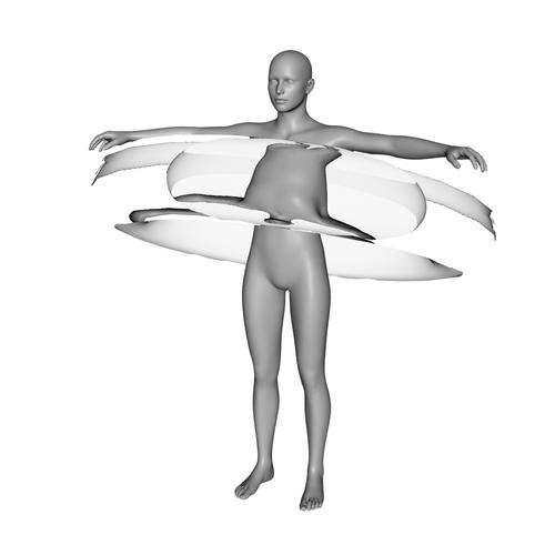

  • Richard HaseltineRichard Haseltine Posts: 111,363
    I'm not seeing that:
    1000 x 1000 - 121K
    Weird. Are you using 32 bits or 64? I'm on 32 bits. I also attached the duf scene to my bug report, can you try iy on your computer?
    I'm using 64 bit, I'll give the scene a go in a bit and add my note either way.
  • joelegeckojoelegecko Posts: 64
    Refraction is broken if rays need to bounce more than twice ( as found by Rob ). This is 3Delight related. This has already been spotted and reported and fix should be available soon.
    Thanks, I was seeing it when I looked through the torus edge-on, or through a pair of nested cylinders, but wasn't sure if it was the geometry throwing too many rerefractions for the engine or a bug
