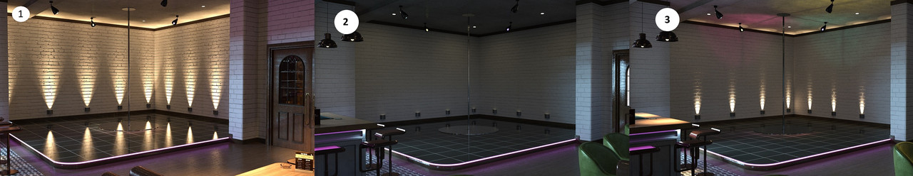

I’ve been playing with Daz studio for a bit less than one year and I am facing an issue with the lights.
A few months ago, I bought the “Z 24 Hour Bar” environment and did a few renders.
The result was the same as on the product page (i.e. with lights fully on, see the picture 1).
I saved the scene and started to work on other scenes (I played with multiple settings).
Now I tried to reopen the bar scene that was saved a few months ago, but the lights "are not working anymore” (i.e. almost off, see picture 2).
I remember that between the first rendering a few months ago and now, I work on scenes using caustic, so I tried to turn it on. It improves a bit the results, but it is still not correct (see the 3rd picture), so it’s not the reason why the render has changed.
I also tried to install Daz studio onto another computer and recreate the scene from scratch by loading the scene from the smart content but I still get the same issue …
Do you have any idea of the problem?
.As far as I remember, the software version hasn’t changed between the two renders (I am using Daz 4.20)
Thank you for you time.

  • OK, so I manage to find a DS4.16 to install, and it works!
    Thanks for the clue FirstBastion.
  • Maybe that is interesting for someone. To fix the light issue for newer DS versions change the values for cutout opacity from 0.0001 to 1 under surfaces. That worked for me.
  • Richard HaseltineRichard Haseltine Posts: 111,939
    Older versions of Iray did not account for the opacity of emissive surfaces, which was really a bug. That was fixed. See Creating a "Ghost Light" - Daz Studio 4.21.1.26+ - Daz 3D Forums
