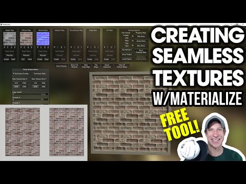

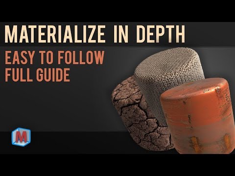

    I like Materialize too (use TomCatOliver's link above)... here are some tutorials
    This guy usually explains stuff pretty well...
    About the seamless tile feature...
    And finally this one which is a bit more in depth...
