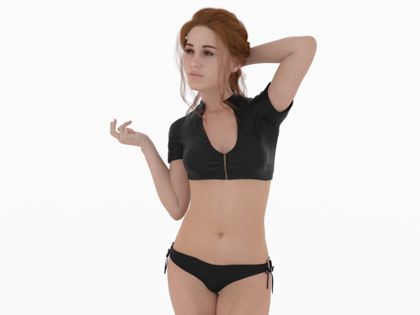

  • The easiest way to use genesis 9 clothing on a genesis 8 character I have tried is a tip I read here on the forum. Just place the head of cyour chartcher in geneis 9.
    Here is a attempt to add Sakura 8 on to a Genesis 9 body, and it worked great. The head moves with the gen 9 poses too, the only thing to keep in mind is that there may become a neck gap if you move the head to much indepenently, but then you can just lower the head down a bit.
    Then you can use all the head textures and morphs from gen 8 on a gen 9. Then you can just copy the body morphs to gen 9 from 8 (through daz3d) and it will look the same. Matching the skin goes quickly too if you use a shader or do a quick edit in a program like photoshop. Thought it was good to spread if somone sells a really cool clothing item you woul like on your gen 8 chartcher.
    2086 x 1244 - 2M

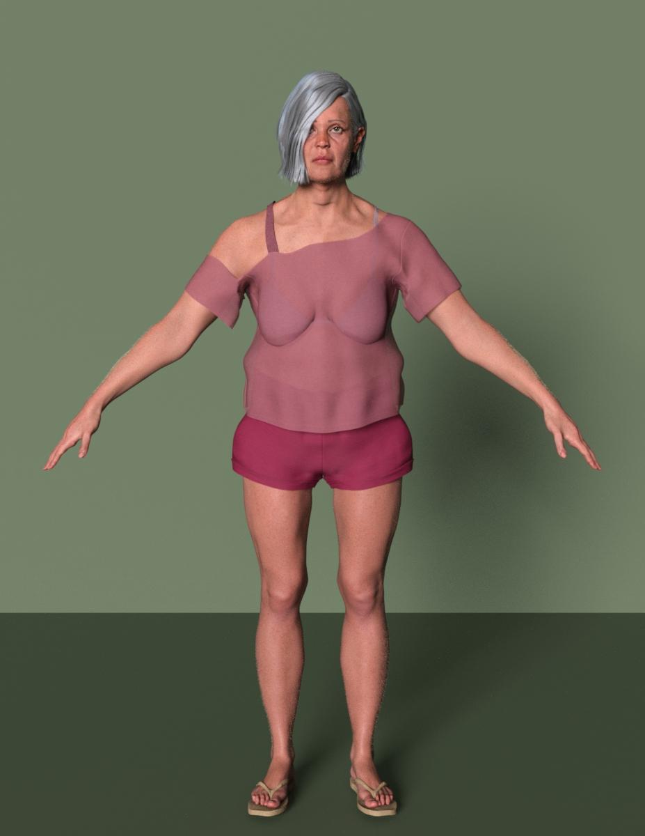

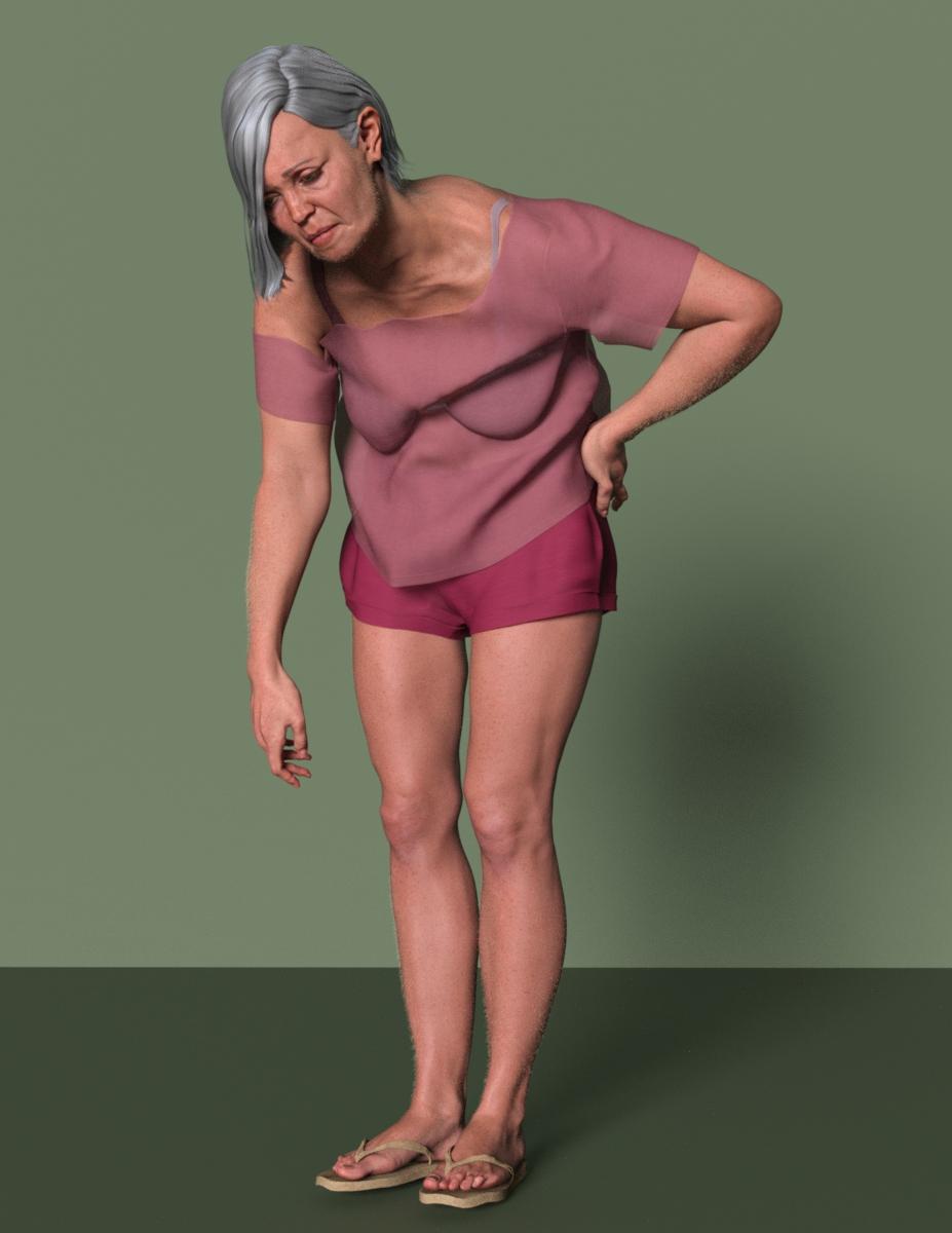

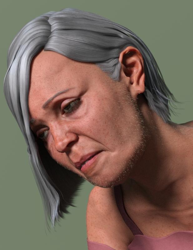

    Made an Aged G8F character morph with aging presets, and the HD morphs from an elderly character (Olivya May). Morph transferred both over to V9 and morphed out the baseline G8F character. All G8F Auto-Fitted clothes, Zeddicuss Aged pose (lightly tweaked) and some D-Force simulation for the clothes. V9 expressions. Interestingly I had to shrink the eyes in the Z scale to 99% to keep the eyes behind the eyelids. Just a character study I had an itch to try. TD
    927 x 1200 - 456K
    927 x 1200 - 488K
    618 x 800 - 292K
