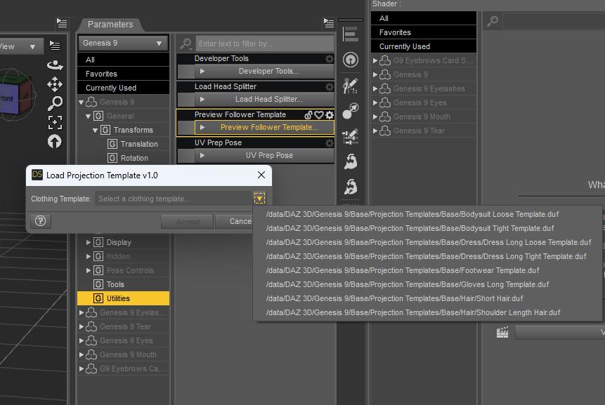

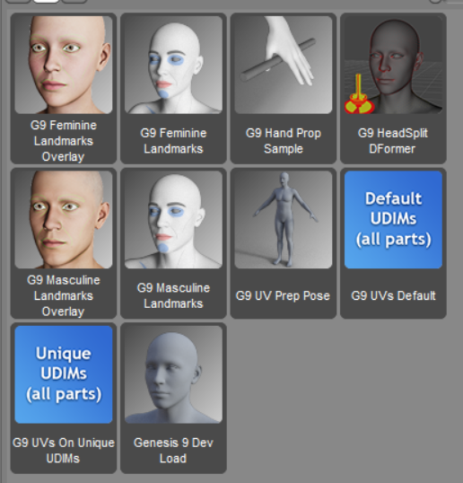

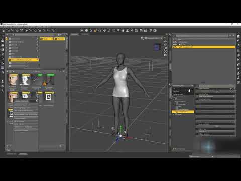

    Something new to check out meanwhile - G9 comes with a new feature called Utilities in the parameter dials. Some interesting new options available in there :D
    With the script in this video you can change the base shape to either male or female, fit your clothing and dial up the non gender shape to check the fit. The advantage with that is you can turn on smoothing and it will smooth to base giving you the best fit and results. This makes it easier for users who prefer to create on a gender shape. After you're done you export the obj and use the transfer utility as usual.
    You do need to be on DS 4.21 to use Utilities
    Thank you so much for mentioning this!! I was looking everywhere trying to find the G8 clones that the autofit used, since I wanted to play around with transfering some morphs using said clone shapes and the transfer utility. I had just about given up hope, which was going to change my personal feelings about G9 from much excitement and happiness to great disappointment, but thankfully I saw your comment, found the Utilities, and what I was looking for was within those dev tools. So happy!!
    The only part I wish was a little better fit was the feet/toes (after having used transfer utility to fit the G9 G8m clone shape to an actual G8m and then dialing in the HFS Ultimate Shapes morphs for the alien and animal type legs, there were obvious distortions with some vertices between the toes not really matching up well enough to make the morph transfer over), but the everything else including hands, face, eyes, ears-- basically the other typical problem areas-- seems to work really well! So this isn't just useful for clothing, but also transfering morphs from G8. Which is going to enable me to start using G9 much much sooner now. I'm excited!!

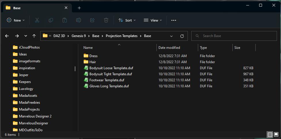

    There's a lot of different uses for the templates that can be loaded via Utilities
    1. You can load the template to see how close its going to be to the outfit you're transferring to - the closer it is in volume the better your result.
    2. Creators can load the templates and see where the different clothing zones are to make it easier to fit pants and shirts over each other (not mandatory of course, but useful)
    3. If you have a figure that you use a lot and it includes a custom morph that doesn't work well with clothing, you can fix the morph in the template and save it, and from then on clothing that you autofit will use the morph you fixed.
    4. You can take the template items into MD and drape against them - the plan is to expand the templates with a hoop dress, loose jackets, some high heel templates etc - once the dust settles down a bit.
    5. Last but not least you can use replace source with the templates to get all the custom ercs and formulas hooked up for your dresses - just make sure you immediately save with another name and in another product folder so you don't overwrite the templates.
    Apologies, where was the tool that allows the use of G8 morphs? I looked in the dev utilities and didn't see anything applicable after clicking around. Though it could be I have something incomplete as i've seen a few people on the forum talk about having partial downloads.

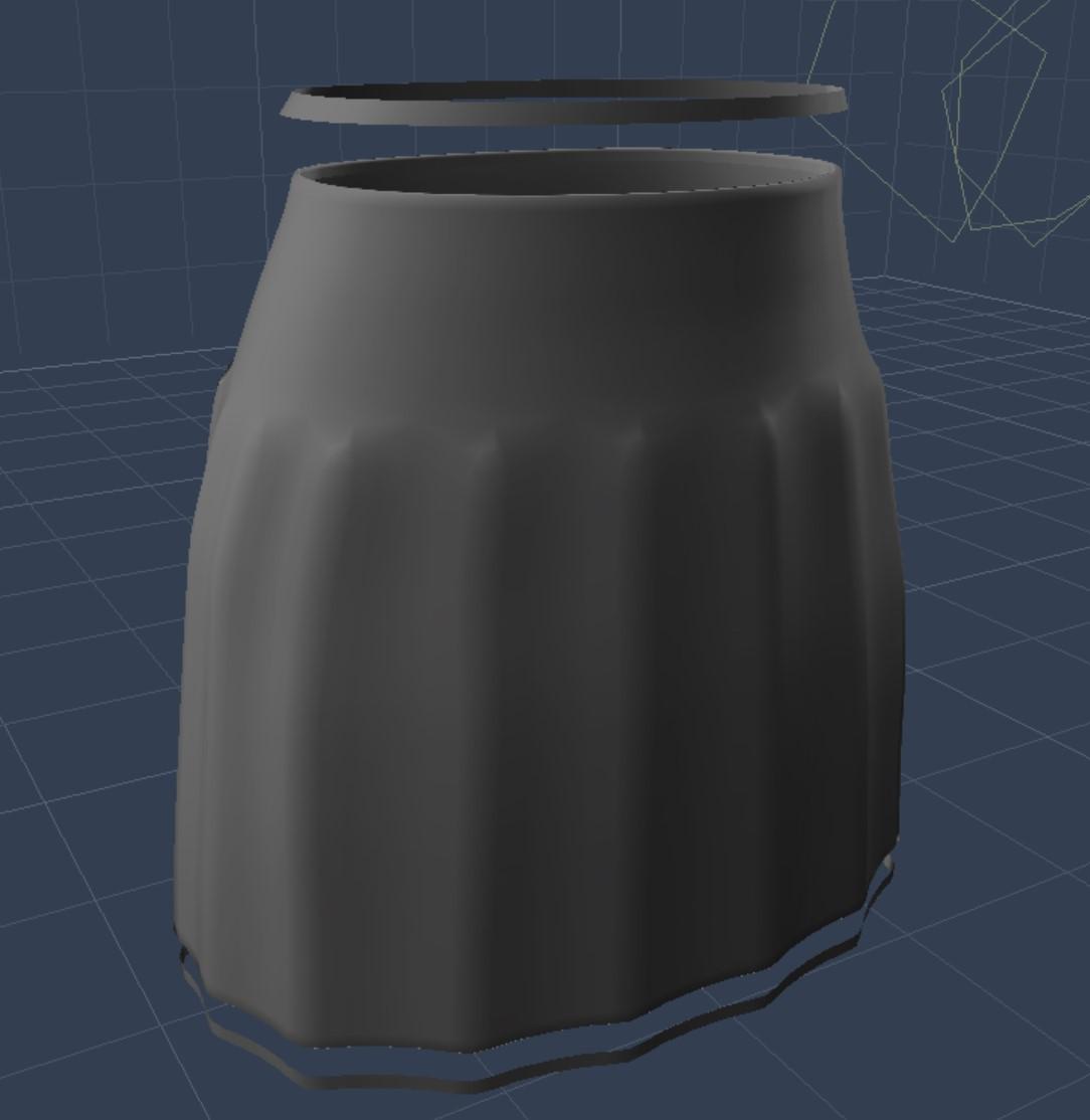

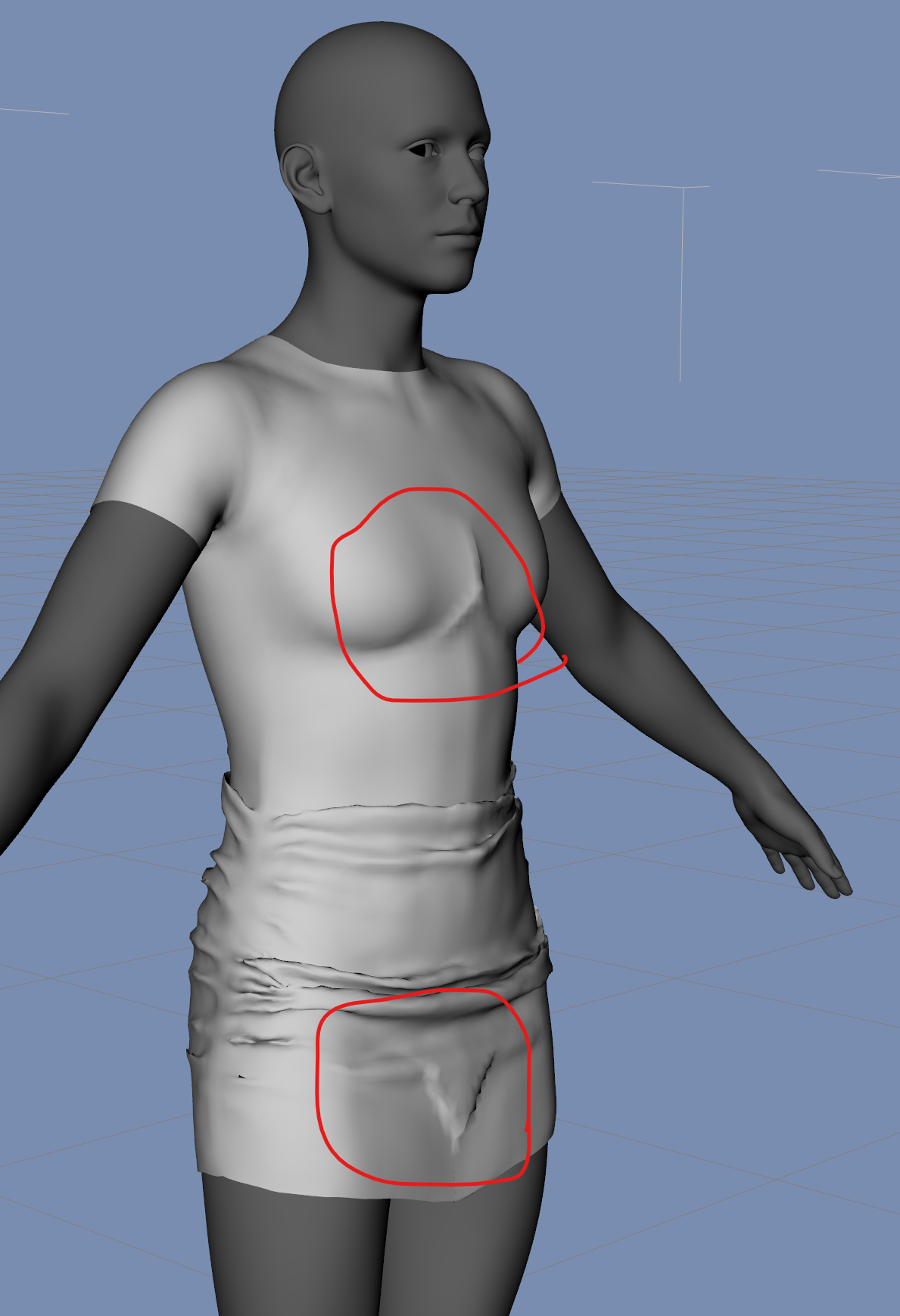

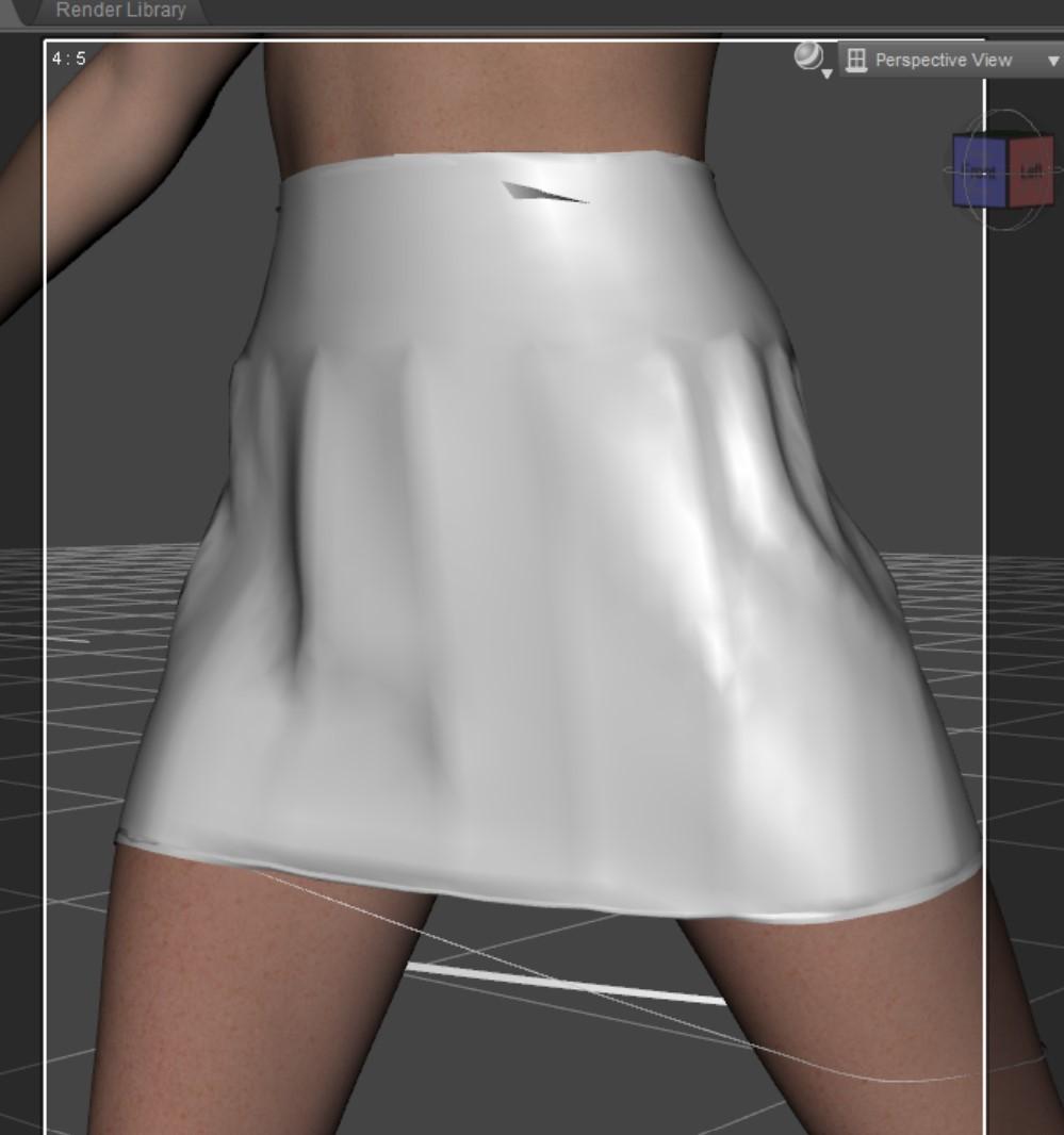

    I created a simple skirt in MD and used the Create Follower Utility to rig it. Since it is all automated, it didn't give me any option to select projection template. The resulting weight mapping looks pretty bad for a skirt. I'm using dForce, so that takes care of it, but I was surprised at how bad it looked before running dForce. Any suggestions?
    1323 x 1531 - 236K
    1210 x 1522 - 220K

  • MadaMada Posts: 2,068
    yea the template would be much better to use. I would try exporting an obj instead and use that with the templates
  • barbultbarbult Posts: 27,608
    Do you mean use the OBJ I exported from MD with the Transfer Utility in DS, just like we have done for G8?

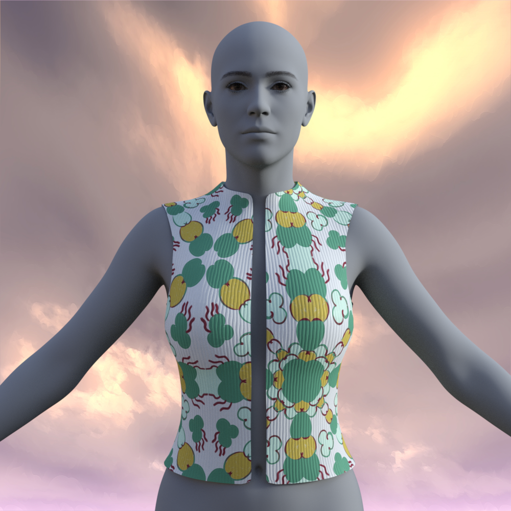

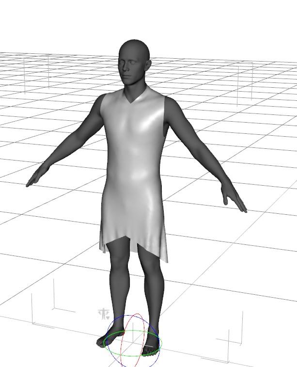

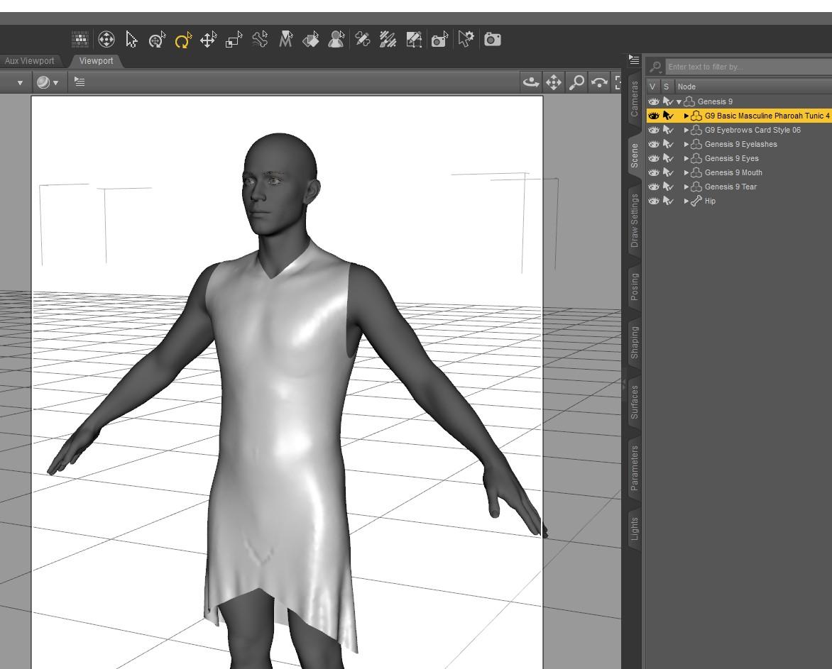

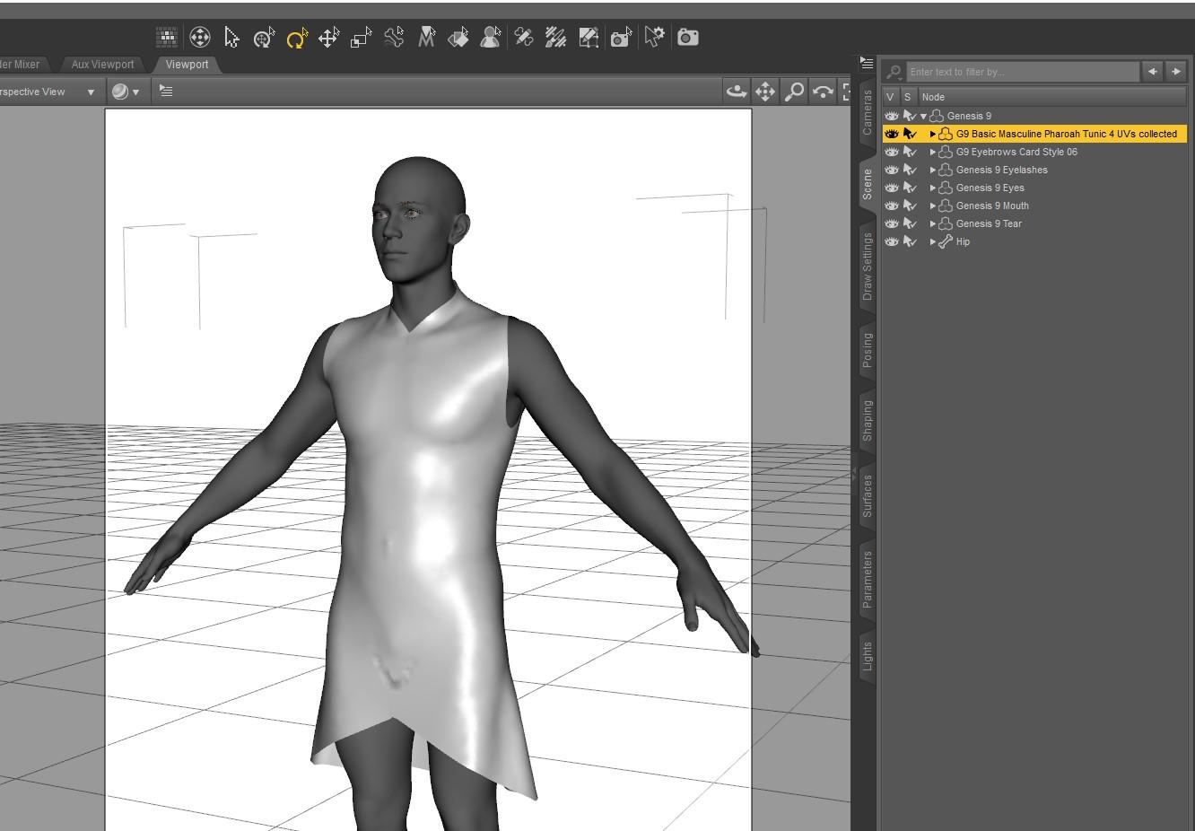

    1st question: Created a very basic long sleeve top. It fits when I bring it into DS but when I use the transfer utility it seems to distort the mesh. Why? Does this mean that clothing needs to be slightly bigger?

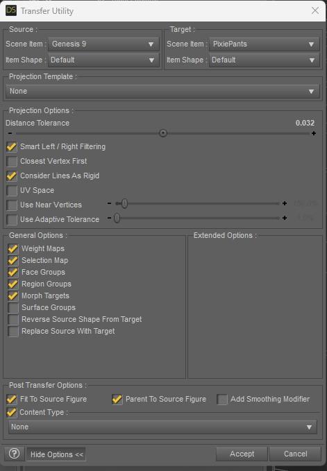

    What were your settings in Transfer Utility? Remember that default G9 is in between masculine and feminine, so you'd need to set your source to "current" or "morph".
    That was it Gordig...my poor old brain is a bit slow this afternoon. Took it into zbrush and adjusted for the base and it works beautifully
    barbult said:
    Yes :)

    If you watch this video it explains how to get the base shape from the female shape right in DS :)
    Mada said:
    barbult said:
    Yes :)
    Thanks, I did so, and it came out much better.
