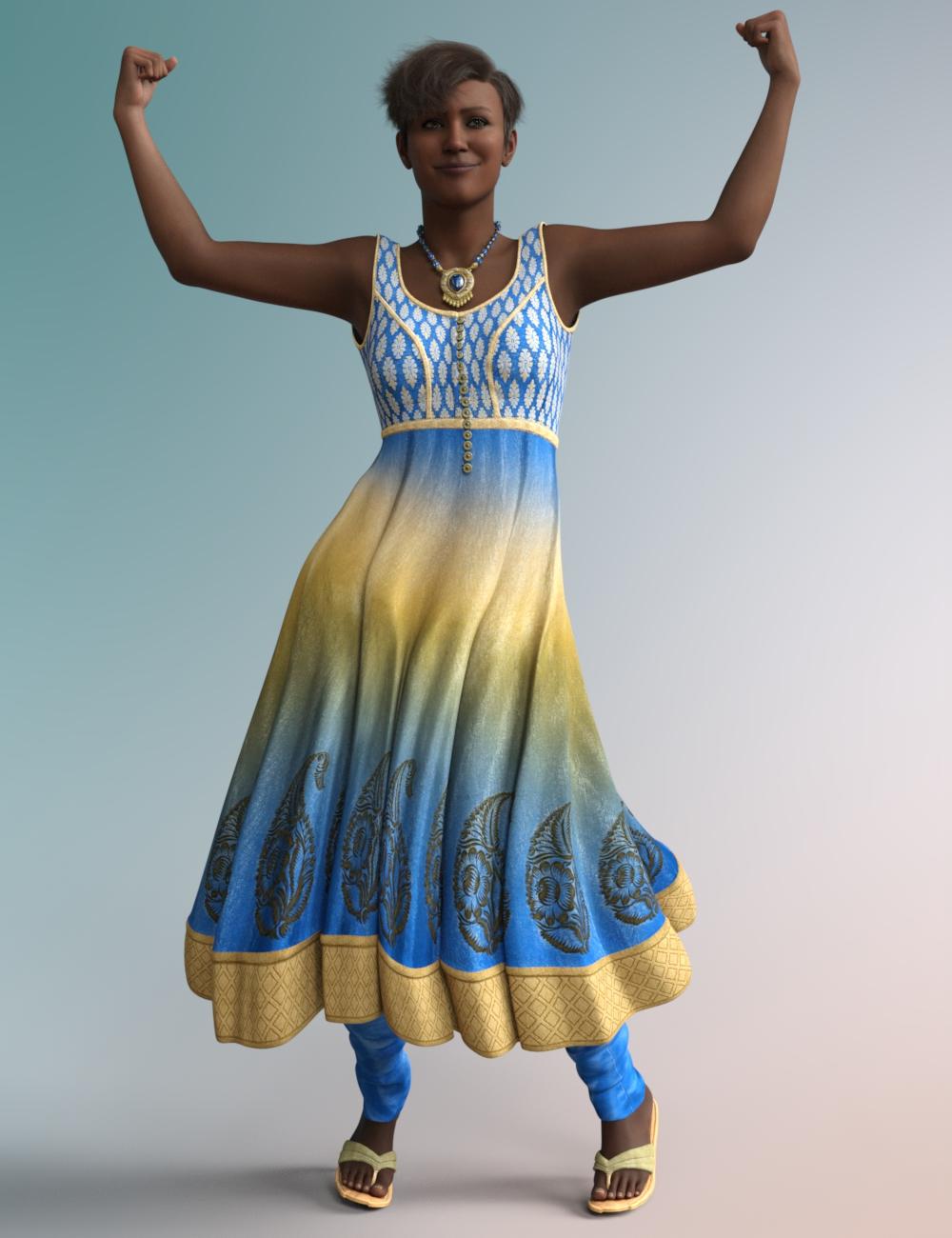

    Chandri fitted well...I'm really glad that they've included the original genesis on the autofit. I'd missed that previously. I've Genesis 8, 3 and 2 with no real issues except for footwear.
    Most hairs seem to work well though.

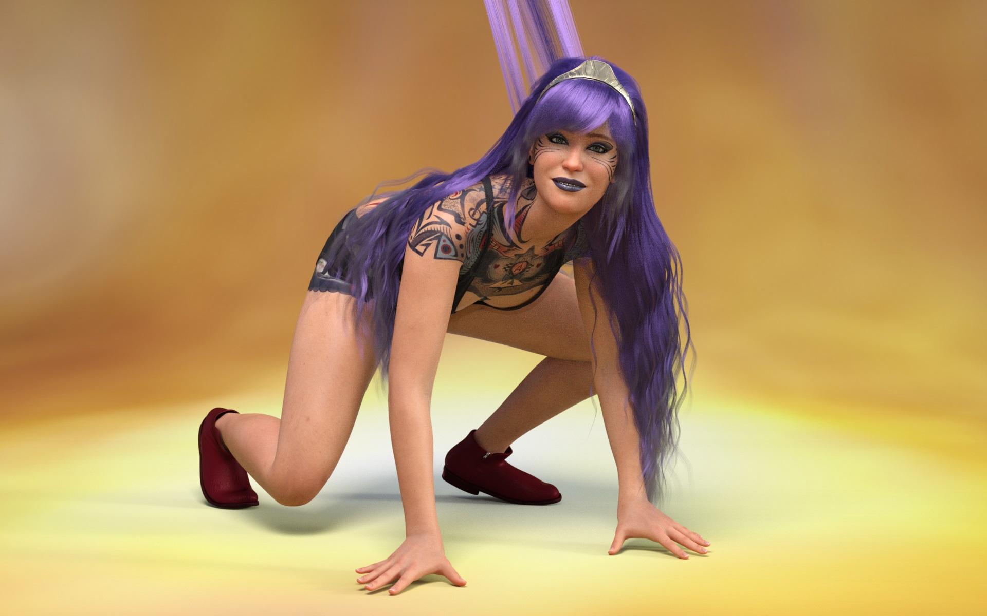

    I have tried the hair from: https://www.daz3d.com/dforce-athena-hair-for-genesis-8-females
    with the help of: https://www.daz3d.com/sy-ultra-templates-for-genesis-9
    on Genesis 9 with the skin from: https://www.daz3d.com/the-agma-bundle
    fitted with https://www.daz3d.com/legacy-uvs-for-genesis-9-genesis-3-8-and-81-female
    After dForce simulation, there are some hairs standing up.
    Any ideas, how to fix that issue?
    1920 x 1200 - 318K
    Post edited by Artini on
  • IceCrMnIceCrMn Posts: 2,334
    Lot's of things can make that happen.
    hair got caught on something during the sim and got stuck up there.
    hair is self colliding and dforce decided that meant "launch this part into space".
    there's a weight map that affects that part.
    As there's nothing in the picture that seems to need G9, a possible solution might be using a G8 figure?!? Or at least try the same setting with a G8F to check if the same problem appears then.
  • felisfelis Posts: 6,649
    It looks like the tips has caught something, although we can't see where they ends.
    Are you using 'current frame' or 'animation'?
    I would recommend animation so you can follow the simulation afterwards and see if there is a potential issue during the simulation.
  • ArtiniArtini Posts: 11,034
    Thanks for all of the tips.
    I have used 'current frame'.

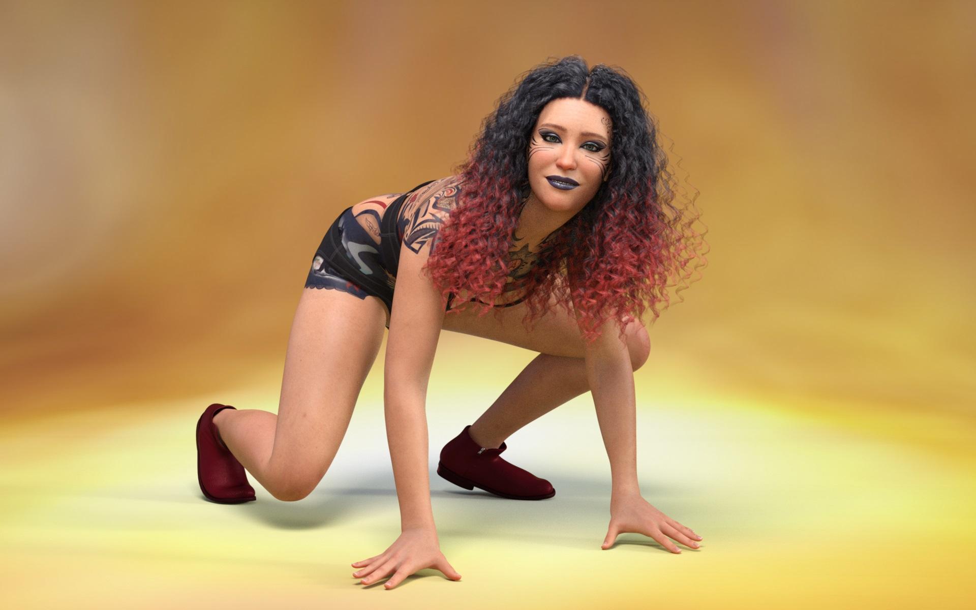

    I tried another dForce hair and it does not work on G9 with https://www.daz3d.com/sy-ultra-templates-for-genesis-9
    so I stick using G8 or G8.1 with such hairs.
    I have tried https://www.daz3d.com/karissa-hair-for-genesis-3-8-female-s
    on my G9 instead and it works quite well.
