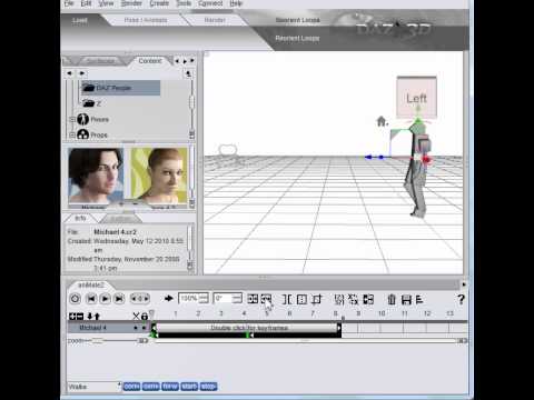

I know Animate has been a part of Daz for a long time. I finally spent the $60 bucks to access the features. I've been looking, but haven't found much useful info. I know how to use the basics -such as everything I've been allowed to play with for free. But now how do I learn to use what I paid for. Like how do I edit an aniblock? How do aniblocks work with the timeline? Where can I read about the advanced Animate features? any info would be appreciated ..

nice link. Thanks. It was a start. I even registered for that GoFigure forum,, to which no one has responded as yet. There's still a lot I'd like to know. Like how to properly use the subtracks and levels.
Q: What goes in the base and what goes in a subtrack? What's the purpose of 14 Levels.
Q: How do you get an animation to end on the last frame? Even when I uncheck Loop, It still wants end back at the first frame?
Q: Can an animation switch camera views? Or do i have to join two seperate renders in a movie software?

I m not expert but I expect this help.
-In base goes a principal aniblock. In subtracks you can add other sub movements as a flexions or lipsynch.
-You can animate the camera in timeline. If you swich the position just do the movement in a one frame for this effect.
-The loop is for a preview view only. This is a problem for you?
