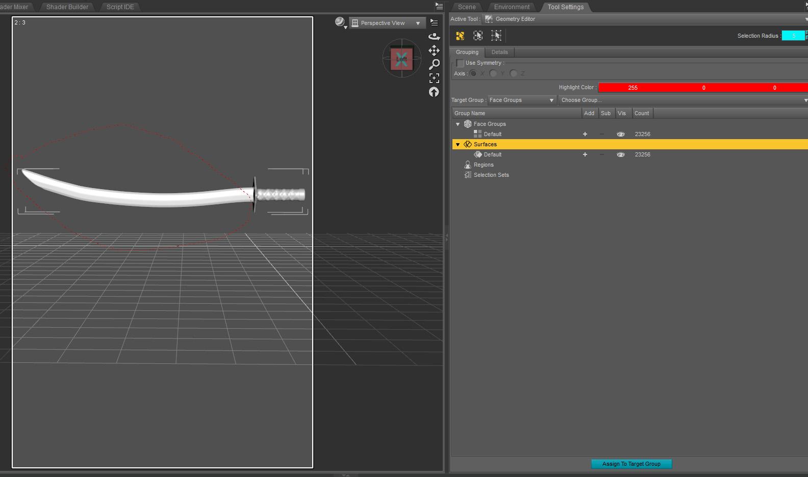

If you haven't already opened the tool settings tab it can be located by going to the menu strip along the top.
Select Window/Panes/Tool Settings.
This will load a new tab. You'll probably notice my ds looks different to the default view as I've set it up to suit myself and the fact that I use two monitors
If you look on the right hand side of the image you will see the tool settings pane is docked. You'll also notice that it contains both surfaces and face groups.
If you look on the left side you will see the window menu highlighted in yellow, along with the pane tab and right down towards the bottom of the menu is the tool setting tab.
1650 x 1080 - 289K

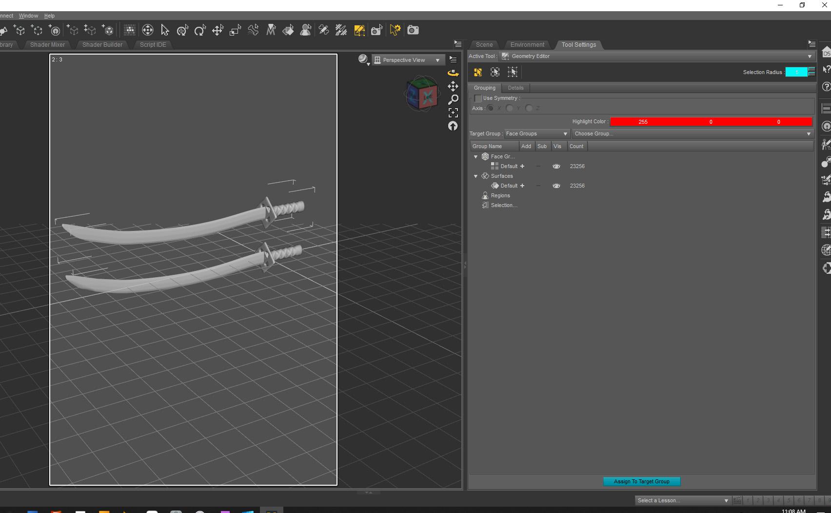

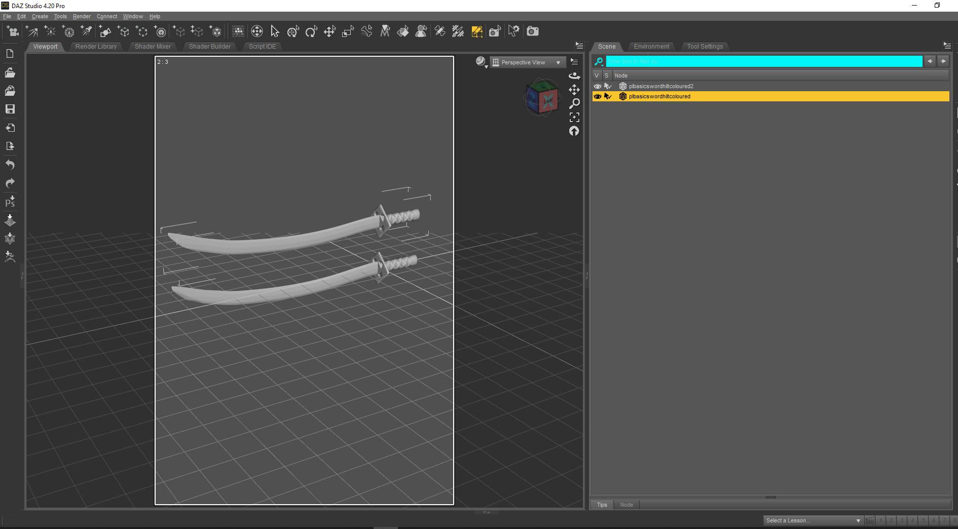

    So we have our tool setting menu. I know that you have loaded your obj so you don't really need to know this but for anyone else, you can either use the bridge if using a program like zbrush or hexagon or you can go to file /import.
    I want to show you that there is a difference though between the two methods. The zbrush bridge for example doesn't include face groups in the transfer but if you export and then load it as an object it will include the face groups.
    You might be wondering why we would need the face groups when doing surfaces and  I will explain it in the post where I talk about the next steps.
    As you can see both look the same in the viewport.
    Here's the one from the bridge transfer and you'll see there are just default surfaces.
    Same sword using a different import method and there are face groups. This will become important further on.

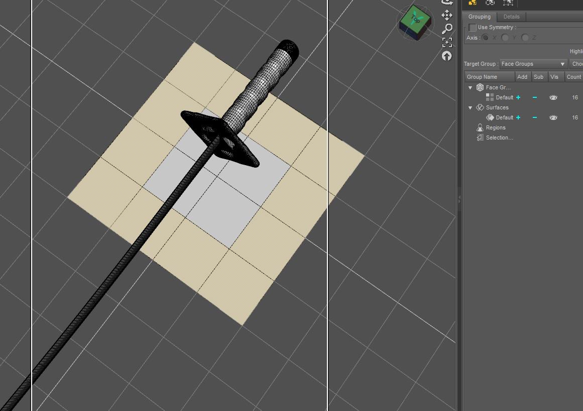

    Starting with the sword that has only the default settings let's look at what options are available to us.
    If you select the surfaces on the tool setting tab and right click it gives us another menu. DS has lots of useful functions that are hidden in this way and it's worth having a look around at what's there when you get chance.
    For now. It gives us two options we can create a surface or we can create a surface from selected.

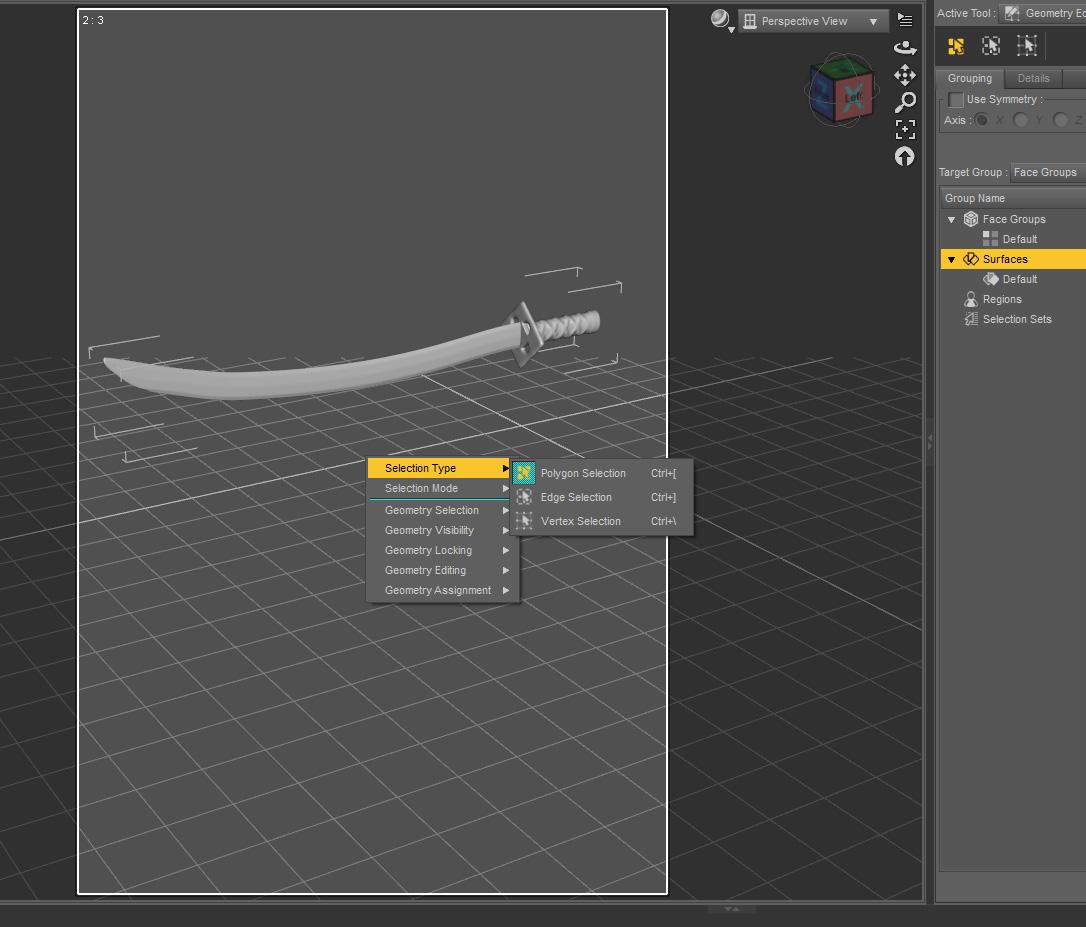

    So what is the best way to select things to create surfaces?
    Lets start by having a look at the first option it gives you on the viewport menu. It offers 3 options Polygons, Edge and Vertex.
    You've already completed a model so I'm going assume you know what each of those are. I tend to use polygon selection as I find it easier. Best way for you to work out which suits you is to have a play with each method and see which one you prefer.
    1086 x 927 - 201K

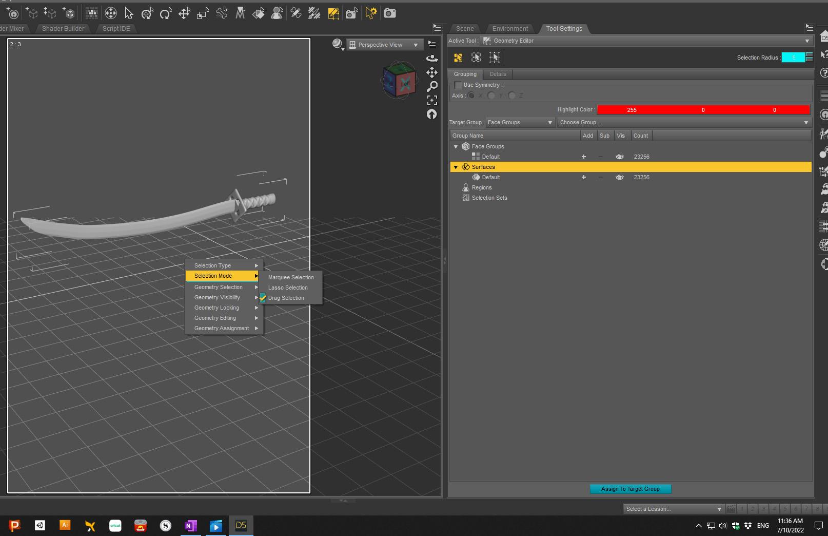

    The next option on the menu is selection mode.
    Again 3 options, Marquee, Lasso and Drag.
    I mainly use Drag and Marquee but again this is a personal preference.

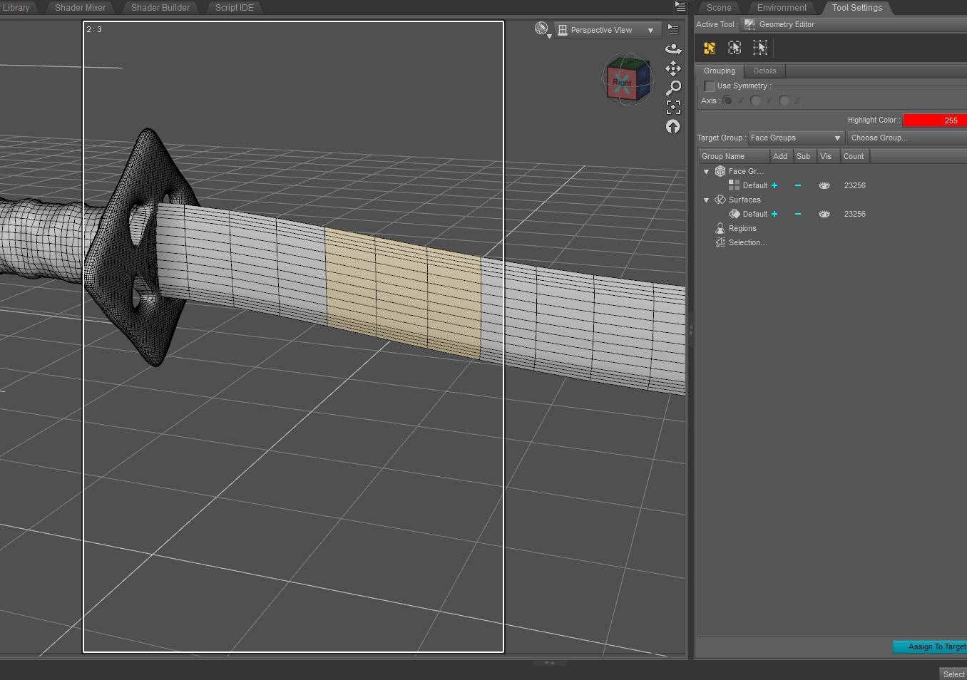

    Marquee allows you to use a rectangle to select.
    The menu options
    If you look closely at the next image you'll see a red dotted outline which is what the marquee tool looks like.
    And the next image is what a selection looks like. Please not it selects not only the polygons facing the screen but the ones behind as well.
    1968 x 1050 - 309K
    1968 x 1050 - 314K

    Next option Lasso selection. This is more free form than the marquee but allows selection of large chunks of the mesh also.
    See image below:

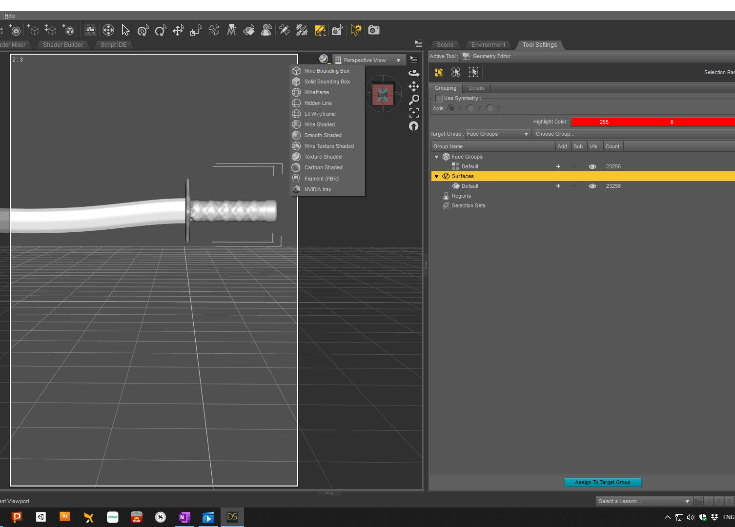

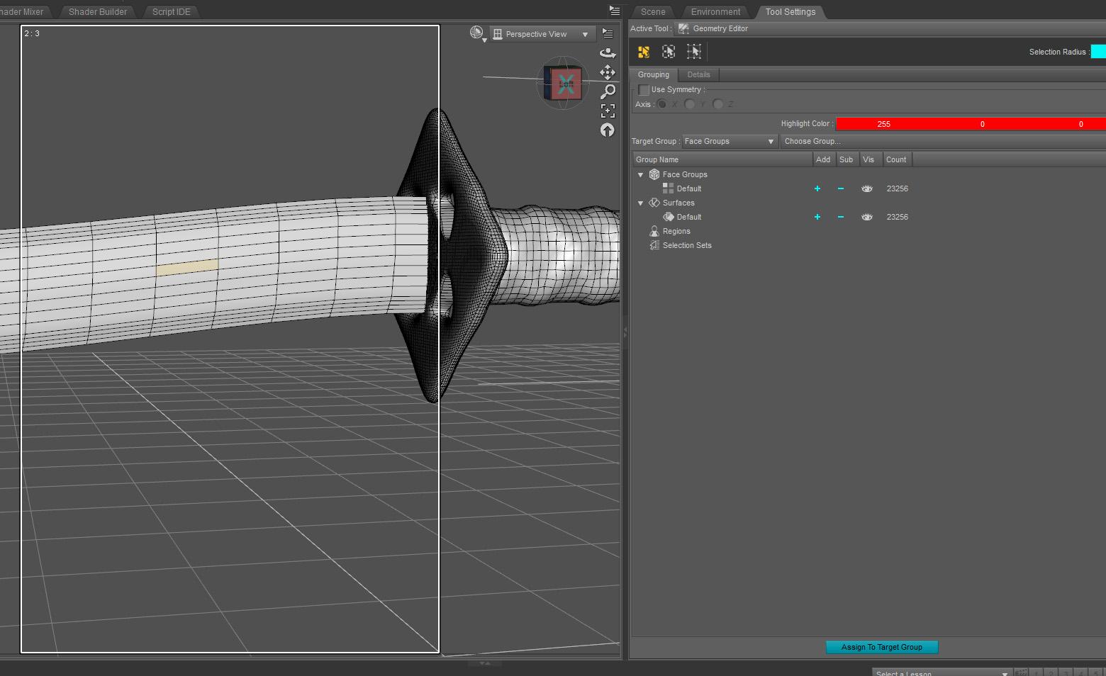

    For the drag selection I prefer to change the way I view the mesh in the viewport to wire texture shaded see the image for how to change this by clicking on the draw styles menu.
    Post edited by Pendraia on
    edited October 2022

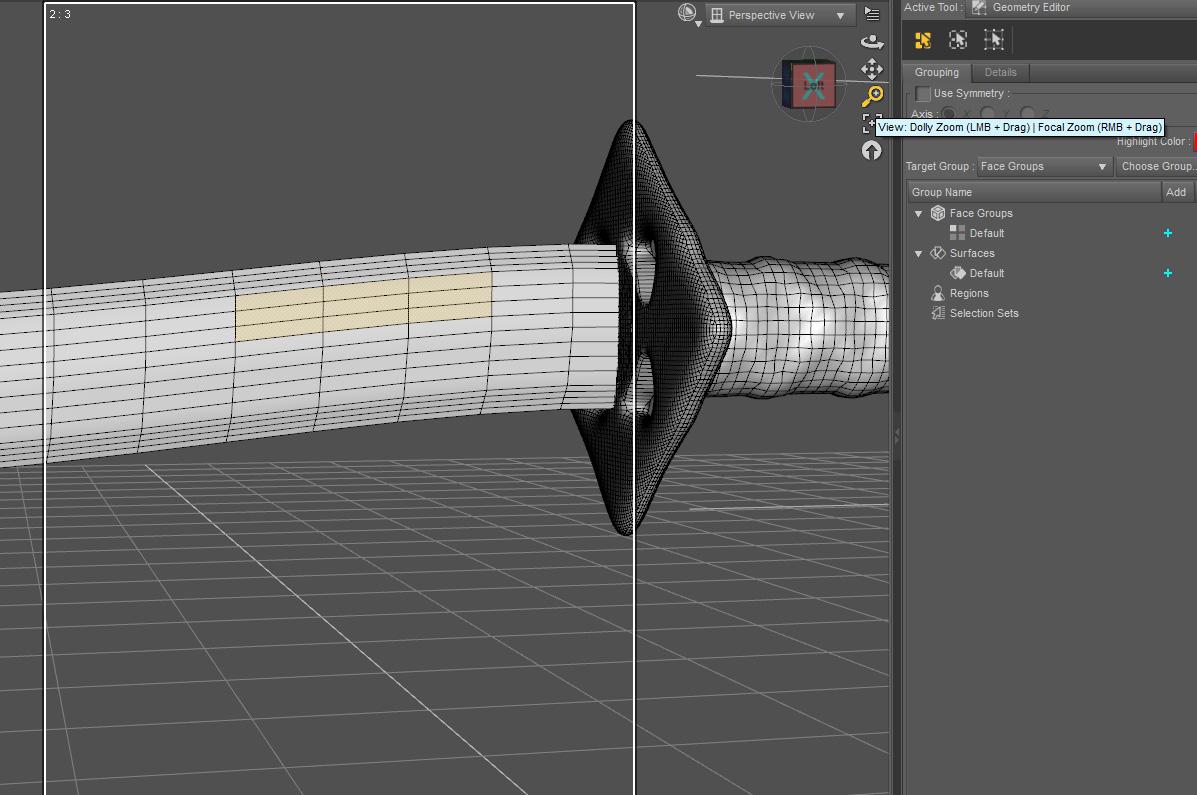

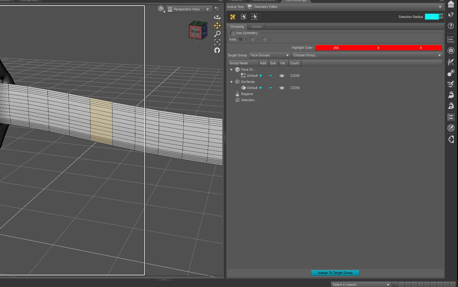

    Drag option: I find this a very versatile option especially when used in conjunction with other selection methods that can be found in the viewport menu.
    You'll notice that my mesh now shows the way the mesh is created. Please excuse the mesh as it's from one of the first tutorials I did in zbrush but will serve us here as an example.
    Clicking with the mouse inside a poly will select that poly.
    Clicking in a poly but continuing to hold the mouse button down and moving it across multiple polys will select all the polys you move across.

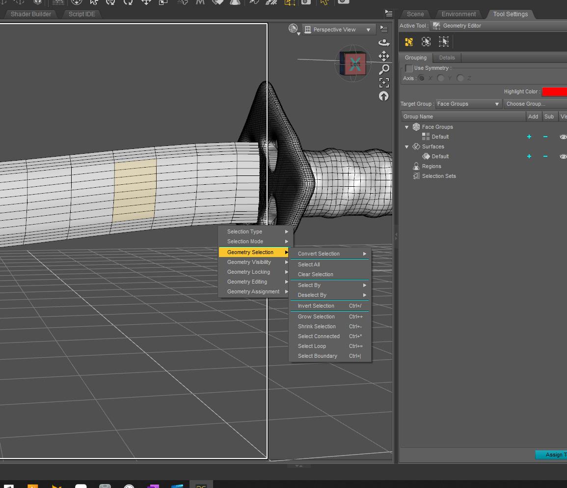

    The next option on our viewport menu is geometry selection and here's where it gets a bit more complicated and also more powerful in terms of the options available to you.
    The first option Converting Selections allows you to change the selection between polys, edges and vertex selection. I don't use this much but it's useful to know it's there.
    Second two options are fairly self explanatory select all and a clear function. I use the clear function a lot when creating surfaces. It's a good practice imo to clear the selection before creating an additional surface otherwise you might end up adding them to the next surface you create.
    edited October 2022
    The next option in the geometry selection menu is select by...remember those face groups I was talking about earlier? This is the option that will make it very easy to turn those into surfaces.
    It also allows you to select by surfaces which allows you to check if all the polys are included in the right surface.
    I haven't used the final two options so I'm going to leave them for now.
    The next menu option is deselect by and gives the same options but instead of select allows you to deselect.

    The next option is invert selection.
    I just discovered a great option for using this here. https://www.daz3d.com/forums/discussion/594441/trying-to-apply-dforce-to-a-jacket you'll need to scroll down.
     I'm still learning and it's great what you can find in these forums but I can seem to link to a specific post for some reason.
    Please note in the image it shows the menu item followed by Ctrl+/ this is the hot keys you can use instead of right clicking. So it can save time.

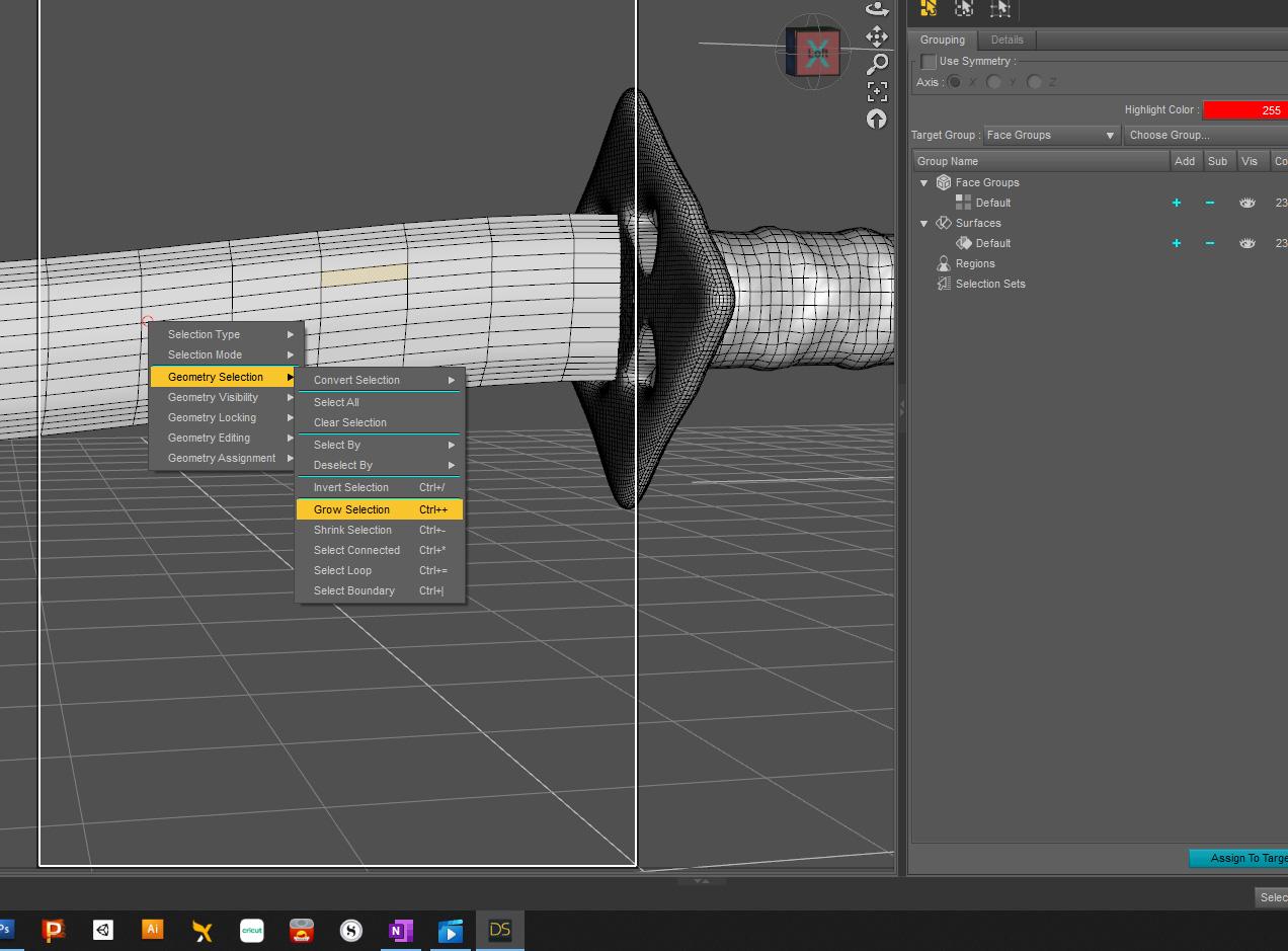

    So the next option is grow selection this also has hot keys so you can use it without having to go into the menu. Ctrl++
    So what happens when I use this function. If I have a single poly selected it will select all of the polys touching the original poly.
    Now what happens if I have a poly loop selected you ask? See the images below which give a before and after

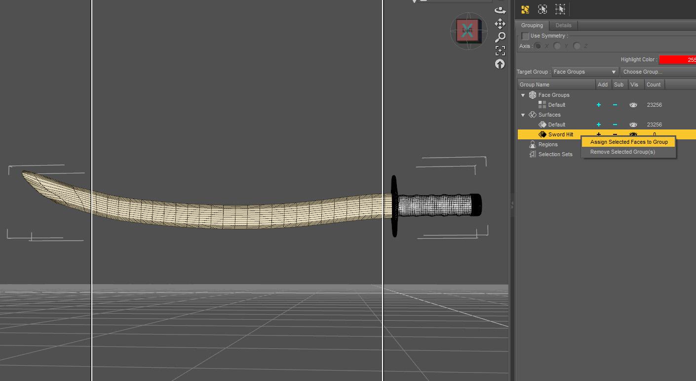

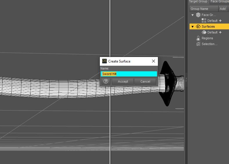

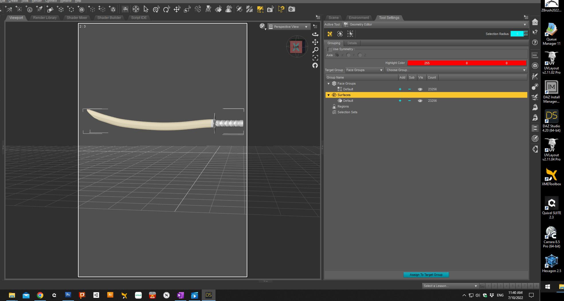

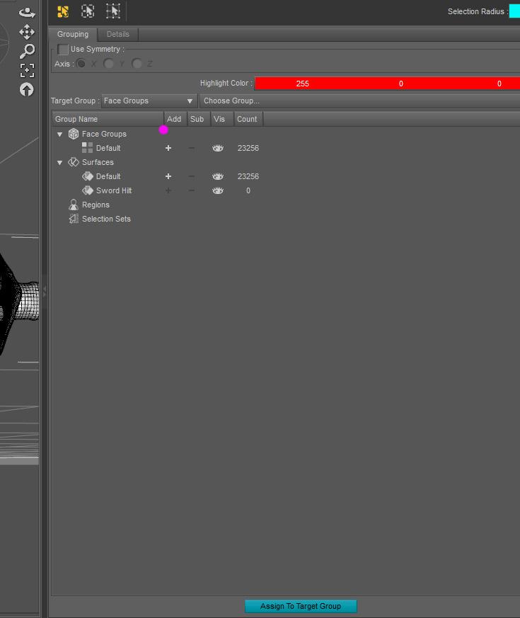

    So we're ready to start creating surfaces.
    I'm going to create a surface group for the sword blade.
    I like to create my surface group so once I have the polygons selected I can assign them. You can do this by right clicking on the surface label in the tool settings tab and selecting create surface.
    when you do this a dialogue box will pop up. Click on the box and type in the name of the new surface. I've typed Sword Hilt in mine. And then click accept.
    When you do this a new surface will appear under surfaces. If you can't see the name of the groups. Hover your cursor over the line where I have placed a purple dot.
    A double headed arrow cursor should appear and will allow you to drag the line to the right so you can see the names of the surfaces.

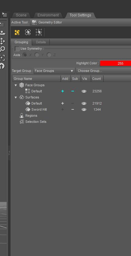

    Let's have a look at what is listed with that new surface. If you click on the add on the default you will get all the polygons in that group selected on your mesh as the default still contains all the polygons it is all over the mesh. If you click on the minus it will remove the selection. This can come in handy later.
    If you click on the eye it will toggle the visibility of that surface. This can come in useful when you need to hide one surface group to get at polygons that are behind it. Say for example you want to create a surface group that isn't visible in dforce so skirt sections don't fall down.
    The last column tells you a count. As it only shows up when selecting by polygons I believe it gives the polygon count assigned to that surface.

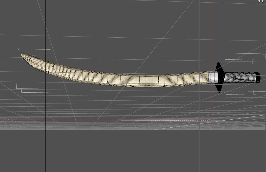

    So the next thing we need to do is to assign some polys to our new surface.

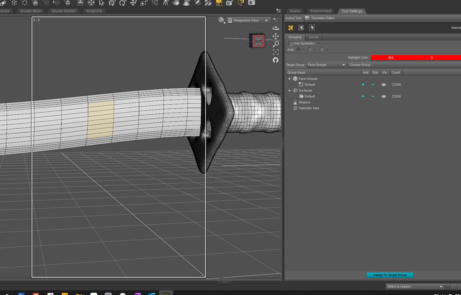

    We're going to start by changing the selection mode to marquee using the viewports right click menu. See image below when you see the yellow tick against marquee you know that you have it selected.
    Use the marquee tool to select most of the blade. It's best to do this with the item sitting straight in front of the camera. Remember it will select the back polygons as well as the front.
    You'll notice I didn't select right to the end of the blade. The reason for this is it is very easy to get polys from the hilt as well as the blade and there is an easier way to do this.
    Next I'm going to select a the option grow selection using the right click menu. Remember you can also use the hot keys for this. I'm going to use this twice which will take me to the end of the blade.
    Now we have the whole blade selected on the tool settings tab, select our new surface sword hilt, right click and assign selected surfaces.
    Now when we look at the sword hilt in the tool settings tab you should see a number of polygons assigned to that surface. And yes it's only a small number of polys because most of them are in the hilt and the sword handle.

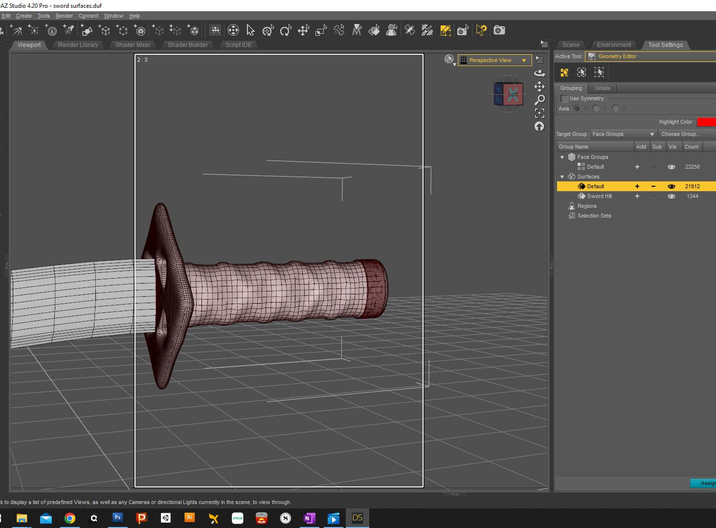

    I have to go to an appointment so I will leave the next step for now but the next bit we'll look at how best to assign the polys in the hilt to separate surfaces.
    If you look closely at the image you will see some bindings that I would like to make into a separate surface.
    1464 x 1080 - 287K
    edited October 2022

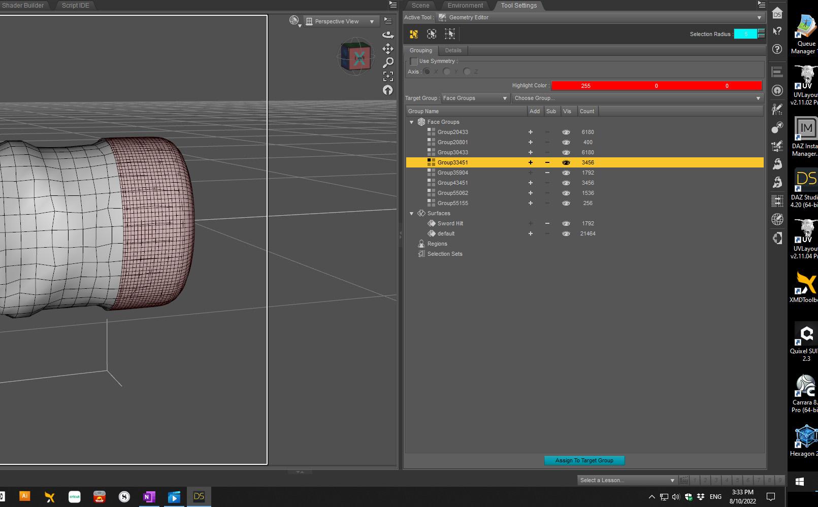

    The easiest way to do the hilt is to use the face groups so I'm going to use the model that has the face groups to demonstrate this. I can use similar techniques to what I did for the blade and I did notice that I called it the sword hilt and it should have been the sword blade. Sorry about that.
    I'm just going to demonstrate it with the end cap. As you can see from the image below the face groups have numbers that don't tell me which part. By selecting each one in the tool settings tab I can easily see which is which as the polygons go pink.
    I need to create another surface and I'll use the same method as before I'll select the surfaces in the tool settings, right click and create surface. This time I'll call it endcap
    By using the right click menu I can go to the geometry selection, select face groups and then the number which corresponds to the end cap.
    If you look at the image below you'll notice the numbers match.
    This will select the end cap and then it's a simple matter of rightclicking on the endcap surface in the tool settings and assigning selected.
    You continue to do this with all the face groups until you have surfaces for everything. Some of the surfaces are more than one face group but you just repeat and assign them to the surface you want them to be part of.
    That's pretty much it for now. Ask if you have any questions and I'll try to help.
    1611 x 999 - 285K
    1278 x 957 - 271K

    Here's a quick render of the sword with shaders on the blade and the endcap. Not bad as it's not been uv'ed yet.
    1000 x 1500 - 75K

    Just as a quick project I remeshed the sword in Zbrush played with the groups, uv mapped in uv layout and then brought it back in to DS and created the surfaces from the face groups and applied shaders.
    I just wanted to see it finished. I might include the sword with the pdf as an object file and let those who want use it as they work thru the tutorial.
