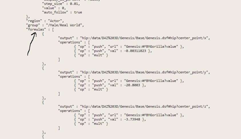

  • Harlekin3DHarlekin3D Posts: 23
    I thought not. I meant this one more.

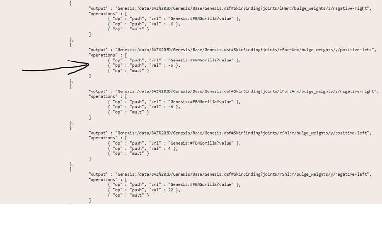

    This weight-map data and the bone data.

  • Richard HaseltineRichard Haseltine Posts: 111,820
    The formulas are the ERC, created from ERC freeze or manually using the property editor.
    That's ERC, though I'm not quite sure what it's doing - I think it's multiplying the value of the Gorilla Morph by -5 and adding it to the postive-y bulge value, though it may indeed be (uniformly) reducing all weights for that property rather than its value. Anyway, my answer stands - you set the ERC up using ERC Freeze or the Property Editor and then you save the morph as an asset.

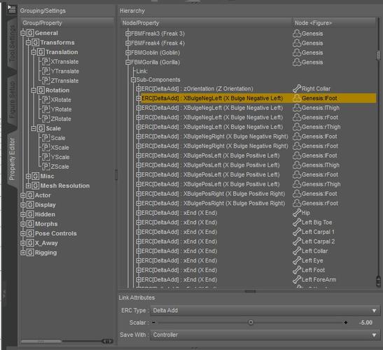

    Here's your "weight-mapping" adjustment - as I suspected, it's the bulge setting. I'm actually showing the XBulge on the foot so you can see that it's in the Property Editor under FBMGorilla>SubComponents (on the Genesis root node, though that of course has scrolled out of sight). I imagine it was added by hand once the main adjustments to centres had been set up with ERC Freeze.
