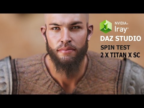

    With my cards I have no issue moving in my Iray viewport and faster than DS OpenGL for sure  , you may check the Iray viewport tab setting and delays under Draw Setting tab
    check my test with Iray viewport :

    Thank you for posting those videos MEC4D :)
    I was really wondering what kind of Iray performance cards like that would give you, looks really great, I must say :)
