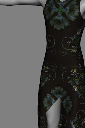

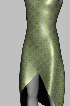

Just posted pictures that better describe the results I am getting on rendering the Silkessence shaders........the render is completely different than what shows in the view port.
Just to be sure it wasn't the rendering software or maps at fault I did a regular texture large print on same garment, it rendered exactly as was showing in view port.
HSS does not show the correct preview prior to render. It shows the texture without any tiling. If you really want it to look like that, just change the tiling to 1.
It does look like you should step the tiling down a little for the clothing item you are using. But these are supposed to be patterns and not huge designs. Really good lighting and a slow render to bring out the details in the underlying maps will give best results. I think the surface looks good in your image, but the quality of the render and the distance from the camera blur the details. If you bring the camera close, it will look much better.
Displacement needs to be turned up higher and higher the further from the camera you get.
