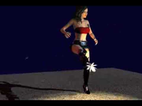

    Here's a little animation I did long ago showing a simple IK rig on a character, with feet placed firmly on the ground during the animation.
    Not sure specifically what you're asking, could you be more specific?
    Also, what do you mean by "freeze" ? Under the Motion tab there is a "Constraint" selection where you can "Lock" an object. Maybe that will do what you want?

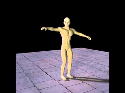

    IK and target helper objects are the way to go to keep feet in place or hands locked down. Just remember that the feet or hands that have IK enabled are still bound by constraints, so pulling or pushing a limb way out of position will effect how well it stays locked down. Fortunately there are ways around this, such as changing the constraint method or limits.
    In these two tests, I locked the foot down to the ground by using IK tracking and a target helper object. The first video uses the standard constraint that loaded with V4. Notice the foot not staying completely in place?
    For the second video, I changed the constraint on the foot to, Ball Joint. Now there is no shifting of the foot. Keep in mind that each situation is unique, so my solution may not be the best for your scene.
    We may need a little more information about "freezing" a figure. Do you mean that you want to make a previously animated figure stop moving for awhile, and then start later in the scene? If so, then it is possible that you will want to try the Discrete Tweener. If you need to know how to change tweener types, let us know.

  • JoeMamma2000JoeMamma2000 Posts: 2,615
    Oh, and I also WISH that Carrara had a simpler, once click method to move one object to the location of another, rather than that ridiculous "Align" which requires 7 clicks just to co-locate two objects. And you always have to remember to click the "To" object first....Arrggghhh....
    Sorry, just a little pent up frustration in Carrara land. smiley
    edited July 2015
    And for anyone interested in details of rigging a character for more realistic animations.
    Long ago I posted a video showing a guy squatting and then raising back up, then moving side-to-side. For those detail-oriented folks, you might notice something strange in how he squats. Notice his feet and ankles when he squats down....it is totally unrealistic. As I recall (it's been awhile) I cheated. In fact, if you try to reproduce that motion yourself, you'll see that if you squat like that your ankles just don't bend that much, and at some point your feet don't stay planted flat on the ground. Instead, when you reach the limit of ankle rotation, you end up raising your heel so that you're squatting on your toes. That's how it really works. I suspect I disabled the rotation constrains to make it look okay with minimal work.
    But in fact, when real animators do stuff like this they make more detailed rigs. In fact, they might have a fairly detailed foot rig, using expressions and other tools, which automatically rotate the toes and put the character on the balls of his feet when necessary. Same with the hands. Often there are very detailed, expression-driven rigs which make fairly complicated stuff like this automated, and accessed with only a slider so it's quite easy.
    With Carrara, if you want this detail, you need to do a lot of it manually, Yeah, it can be done, but just not as easily.
    Post edited by JoeMamma2000 on
