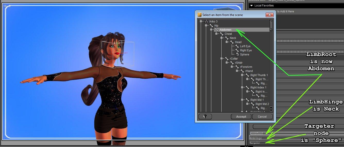

    here you can see that the "target" node has a payload
    it remembers which node to bend ( LimbHinge ), in this case the neck
    which node to re-orient ( LimbRoot) , it was the chest, but the user can change it to the abdomen or hip
    and it remembers that the red Sphere ( Targeter ) is the object that it must strive to move to the target location
    in other news i did test it for animation purposes and it works
    i animated the target node
    then i stepped through 30 frames 1 by 1
    the script adjusted the pose for each frame thereby keyframing those poses
    then i deleted the target node
    so i obtained an animation !
    release possibly tomorrow
    possibly being a cleverly elastic promise ! :)
    Post edited by mCasual on
