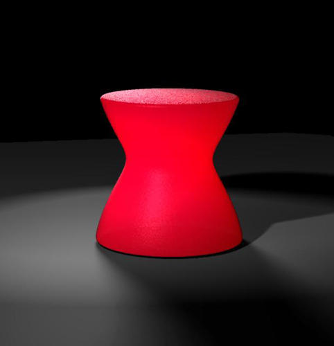

    Here's a candy I just designed, called a "Gummy Goober". All the shader has is subsurface scattering, plus a hint of bump and highlight. Translucency is part of the subsurface shader.
    Although I broke my own rule and didn't use a gummy bear as reference, so it could be totally wrong.

    Looks nice Joe.
  • GarstorGarstor Posts: 1,411
    Joe, that is a great description of the settings and what they are used for. That's a nice render too...good enough to eat.
    Bravo sir!
