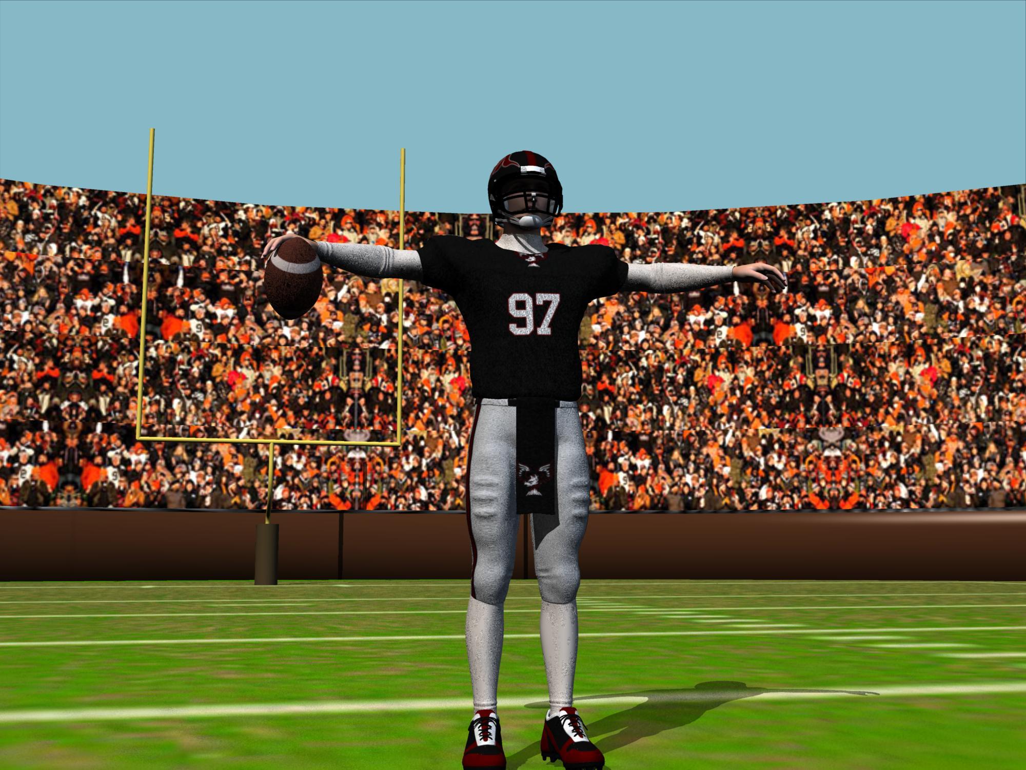

    So here is a test render of field level Genesis 1 base male in the Genesis Football Uniform inside my stadium model.  I think with a little depth of field the stadium crowd would be accceptable even without replicating some torsos on the ledges.  Thoughts?  Just thinking about the stadium, have not made any adjustments to the genesis shaders.
    2000 x 1500 - 373K
    Post edited by Diomede on
  • StezzaStezza Posts: 9,277
    looking good... do stadiums over there have no walkways? just wondering how everyone gets in and out wink
    some adjustment to the top for heads sticking up over the back wall may add to the realism yes
  • DiomedeDiomede Posts: 15,468
    Excellent.  Will work on both.  I think the top level head sticking up might be best dealt with using a people billboard with an opacity map.  Maybe the walkways can be dealt with using a different stadium crowd picture.
  • i would suggest a little focus point so that the background gets a little blurred out so you don't need to work too much on the background but that can be done post render process.
    I vote for Billboards and walkway pictures !!!
