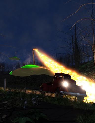

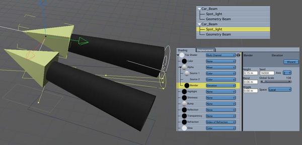

    Turk_WLF, I just made a quick test using geometry for the beams and put Spot Lights at the end. I turned off Cast Shadows and Receive Shadow for the beams. I tried matching the Half Angle of the Spots to match the end of the beams, but I don't know if that is correct, maybe they should be wider.

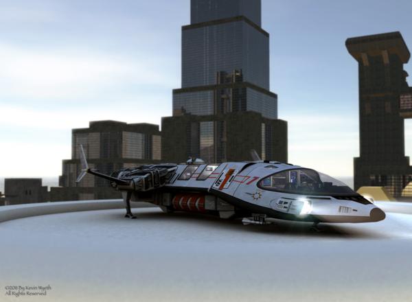

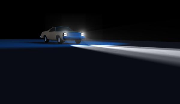

    If something like this is what you have in mind, I can post the file. It does use light cones but I have them fade very quickly.
    Sorry for using the horrible El Camino from the Carrara stock library, but hey, it fit the bill.

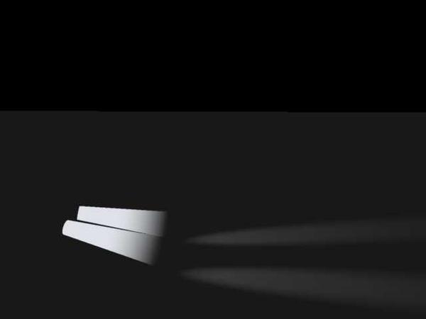

    If I read your question correctly, you need help understanding the settings for the spotlight.
    - Half Angle refers to the degrees/angle of spread for the light (i.e. think of it as the geometry of the light "cone")
    - Angular Falloff is used to "soften" the effects of the light on the edges of the spot (light decay). the greater the % value, the less lighting effect there is toward the outside edges of the "cone".
    - Range Falloff is similar to angular falloff only it affects how intense the light effect is for the entire range of the light. The higher the value, the "faster" or sooner the light decays
    I've included a few examples below so you can see what the settings do.
    It's hard give specific values that would be best for your situation, but and easy way to see what how the different settings will effect your scene would be to shine a spot light onto a black plane at about a 70 degree angle (with no other lights in the scene).
    You may also be able to get the effect you want by setting up a "real" light like you described. This probably wouldn't be good for animation, as you will need to enable full ray tracing and indirect lighting, so render times would be greater. I also attached a couple of images using this method. The inside surface of the light is reflective, I have a bulb light in it, a "lens" and a light restictor cap to help narrow the spread angle of the reflector cone. Carrara has some really good indirect lighting capabilities with path/ray tracing, so in many respects it comes close to un-biased render engines (also known as PBR or Physically Based Render .... the "new" buzz word for un-biased renderers).
    I've also attached the file with the scene setup I used for the sample images in case you want to explore it a bit on your own. Hopefully all this helps in some way.
