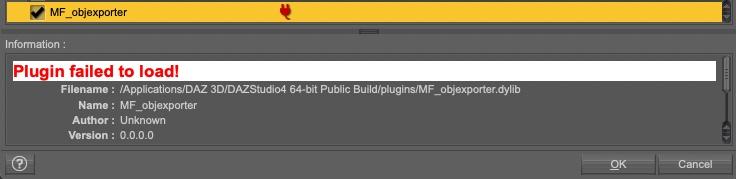

    I don't know if other have the same problem, but OBJ Companion doesn't load on the current public beta (Daz 4.22.1.224) on my Mac:
    I checked and it's working the Win64 version of Daz 4.22.1.224 and with Daz 4.22.0.19.
    I didn't check if it's working with Daz 4.22.0.19 on my Mac because I don't know how to have both Daz 4.21 and Daz 4.22 installed at the same time.

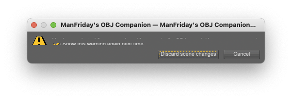

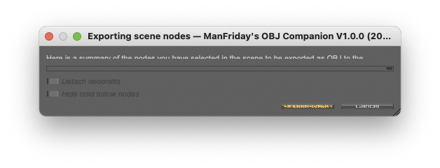

    So, with Daz Studio 4.21.0.5, on my Mac, using OBJ companion works mostly as intended but there is a problem with the size of some windows. The first one is the Warning window who never opened at its intended size (second screenshot) but always in a reduced and useless size (first screenshot):

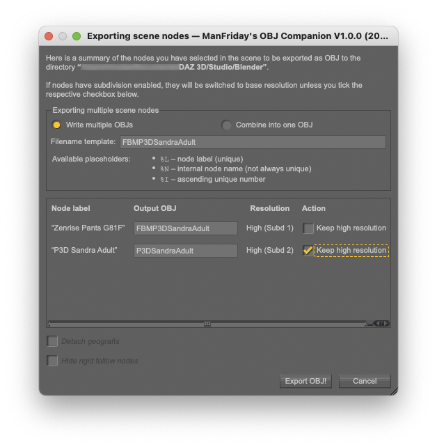

    Then, if I'm trying to export one object only, the next window will also have the wrong height:
    The same window will have the correct height if I'm trying to export two objects (or more, I tested with 7 and it has the correct height):

    I didn't thought about opening the log file before, but here the four line related to OBJ Companion during the launch of Daz 4.22.1.224 on my Mac (I deleted the log file while Daz was closed, to have only the launch sequence in it):
    2024-10-04 12:22:52.305 [VERBOSE] ::     MF_objexporter.dylib
    2024-10-04 12:22:52.361 [WARNING] ::     MF_objexporter.dylib failed to load
    2024-10-04 12:22:52.362 [WARNING] :: Error: dlopen(/Applications/DAZ 3D/DAZStudio4 64-bit Public Build/plugins/MF_objexporter.dylib, 0x0002): Symbol not found: __ZN15DzHierarchyPane16staticMetaObjectE
      Referenced from: <34544F25-973F-33BE-BA5F-7690180BC90D> /Applications/DAZ 3D/DAZStudio4 64-bit Public Build/plugins/MF_objexporter.dylib
      Expected in:     <25E610B8-CE45-B16B-D224-9B226067F9B0> /Applications/DAZ 3D/DAZStudio4 64-bit Public Build/Frameworks/libdzcore.dylib
