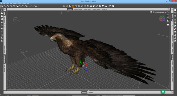

Well, I tried importing the obj into DAZ - sorted through a host of issues - the main one was that the bird was invisible. Okay, no problem, I've dealt with that before, it's usually an opacity setting gone awry. So took care of that. And got the textures in place -first screenshot.
Not a bad looking bird, although there was definitely something wonky going on with some included transparency mats so I just said the heck with that and went with the standard diffuse, spec, bump, and normals.

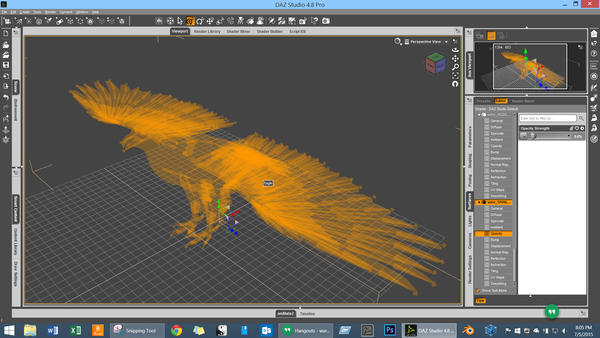

But the problem is, my bird is boneless. So no rigging and sure enough the little icon in the Scene panel just shows it as geometry. Now wait a sec. I saw bones on that thing, I know I did. Coming in at 0 opacity when I hovered my mouse over the bird, DAZ reacted to the regions - second screenshot.
I can very clearly see bones in there. So I look all over the place, not a chicken bone to be seen. ;) But under the Surfaces tab, I see "wire" with a number listed. What the heck is a wire? Well the opacity is off for these as well, so I turn those up and turn off the feathers for a moment. And that's the third screenshot.

    An answer for one question: Don't be concerned about the "wire" reference, that is but a name given to the material. Very safe thing to rename to something normal.
  • Richard HaseltineRichard Haseltine Posts: 111,341
    OBJ doesn't include rigging, it's just a static mesh format. You could try importing the FBX, which will include rigging, but I wouldn't hold out any great hope of getting anything usable. The cones in your third screen shot are probably there to help with selection for bones to pose the feathers.
